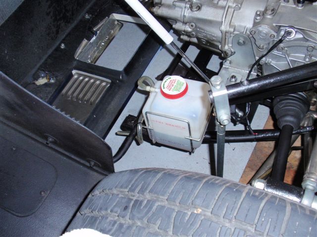

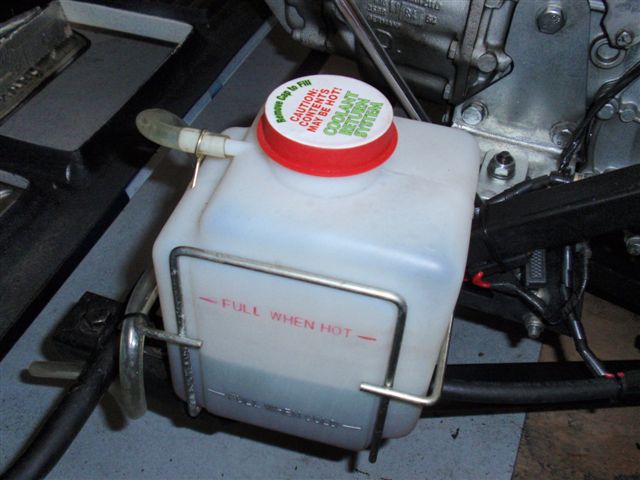

I've handled it with an overflow tank and a pressure relief radiator cap. After I warm the car and a short drive, I'll pull the relief lever on the cap and you can hear the water (and bubbles) flow to the overflow tank. As the radiator cools, the vacuum draws the coolant back into the engine. Normally 2-3 "burps" will do it.

Veek
I like that bottle - looks the dogs - where did you get it from, the ones I have seen in the UK tend to be aluminium or motorcycle tanks.
