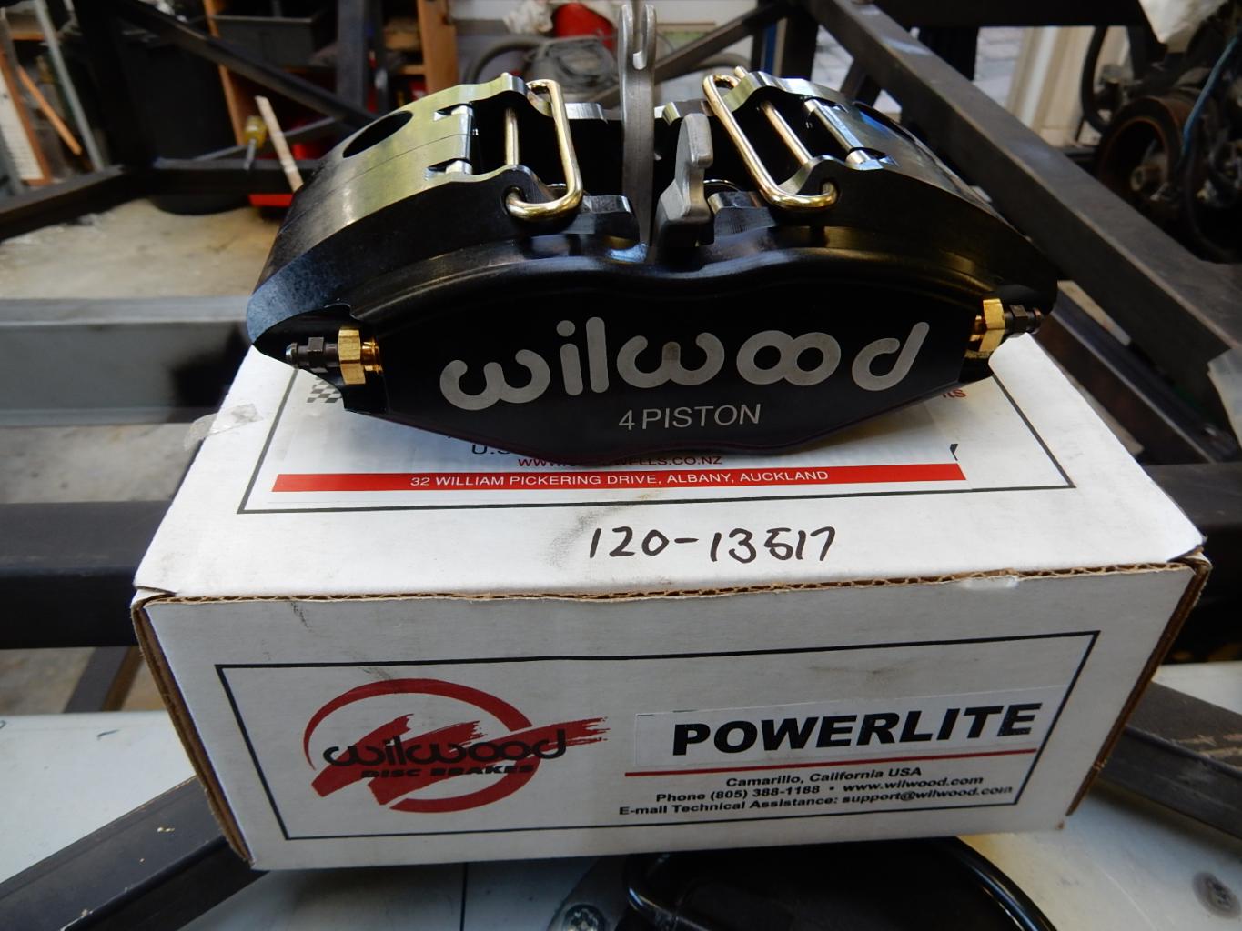

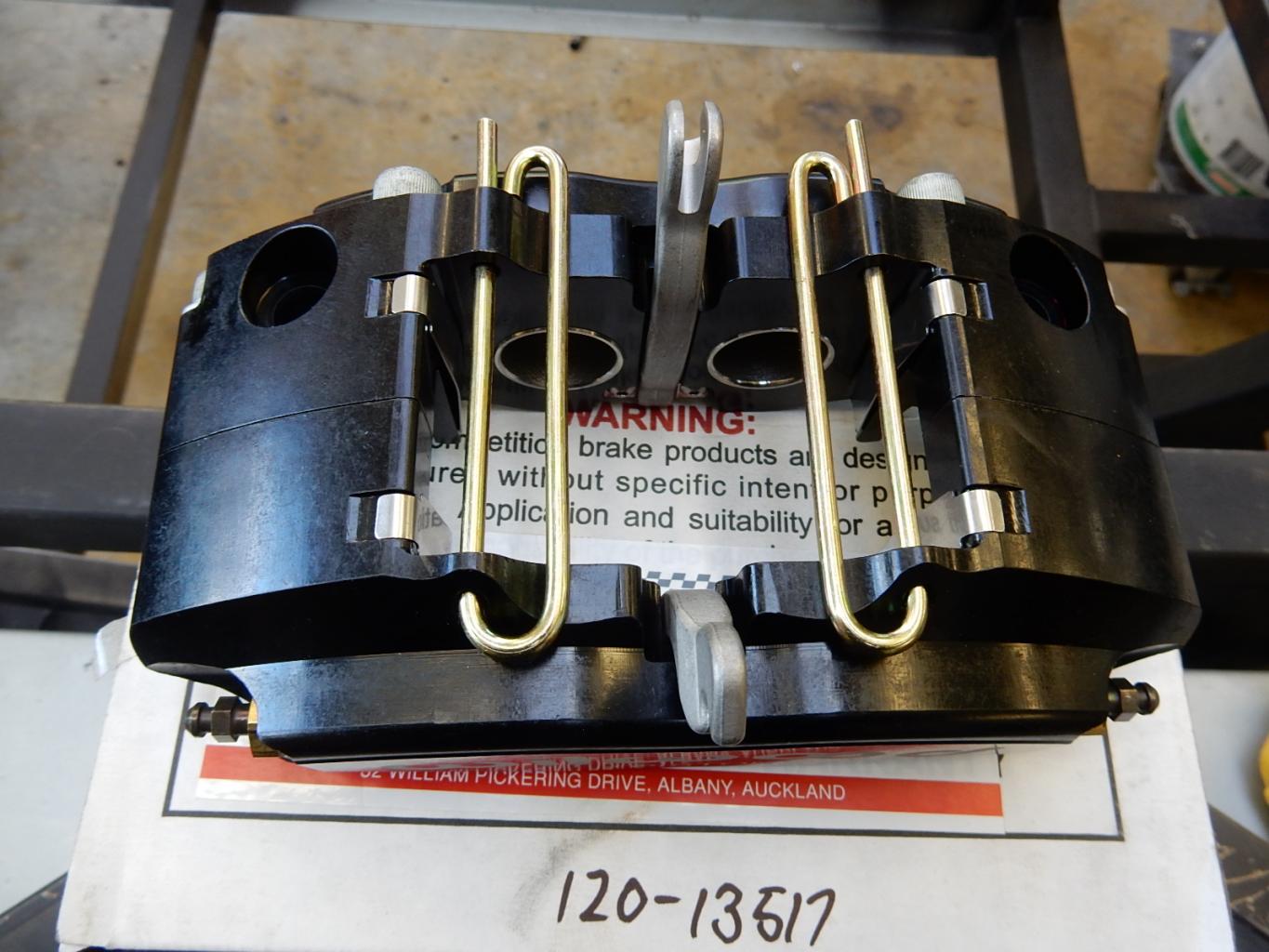

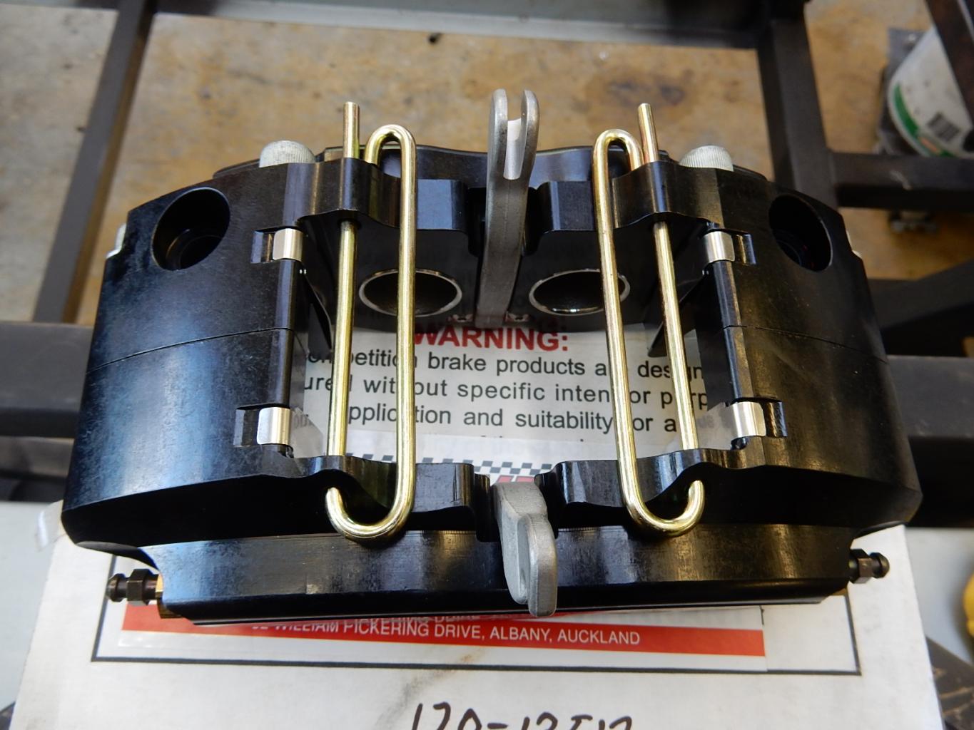

There is some `confusion` over these 4 pot rear calipers with hand brake fitting in that the part number does not show in the Willwood USA catalogue.
I believe they are only available here in NZ and the UK.
Try sending Willwood the picture with your request for information.
I originally went down the seperate `puck` caliper road and quickly thru them out as these appear to be superior and a hell of a lot easier to activate.
They are available in NZ from Cardwell Racing not far from me.
