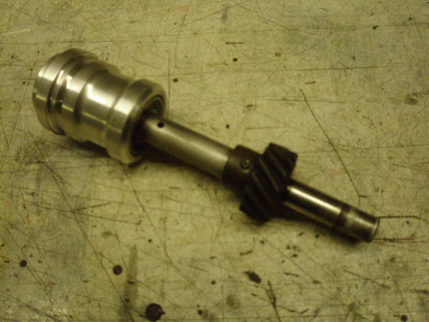

Are looking for a cam sync sensor, because your ECU needs the input signal or it a convenient way of removing the distributor whilst still retaining the oil pump drive from the camshaft?<?xml:namespace prefix = o ns = "urn:schemas-microsoft-com<img src=" /><o:p></o:p>
On the system I’ve used it relies on the crank & TPS signal only for mapping. I then converted my old distributor to the following photo<o:p></o:p>
Is this something I could do for your installation?<o:p></o:p>
Rgds,<o:p></o:p>
Andy<o:p></o:p>

Hi Andy, thanks, it was just a convenient way of maintaining oil pump drive. I would have converted my original distributor except that it is in poor condition. I have a relatively new Mallory Unilite, but I would be reluctant to chop it.
A second hand distributor is an option.
For your system, I guess that you just need a distributor shaft? It looks like you have put ball bearings in a machined boss so my old distributor shaft might do it, with a new gear as the old one is trashed.

Hi Dave,
your're correct in your assumptions and only the shaft and a suitable drive gear is required for this conversion.
