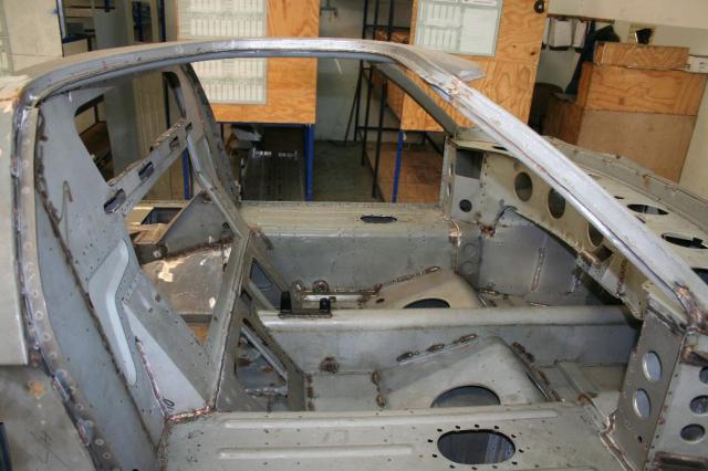

Randy,
Not an option in a GT40 (original or SPF) as the tub has a reinforcement running from sponson to tunnel as in the attached picture. The SPF seats are moulded foam and can be "shaved" for extra room but you will only gain abot .75". In some replicas where the seats are "bolt in" to the floor that may be done but of course you lose the ground clearance.

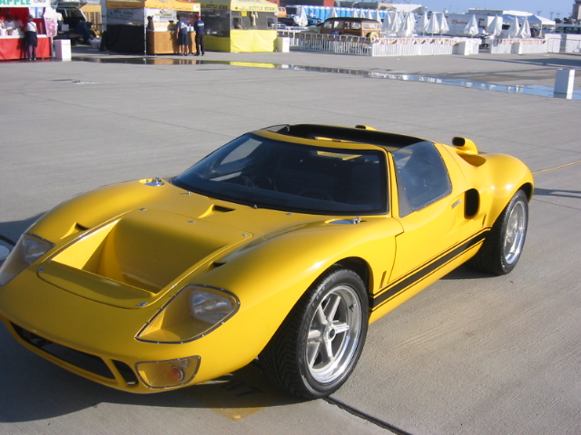

The last I saw the yellow CAV was still avalibe at a big discount, I remember $55k as a roller...........................(about 3 month's ago via the San Deigo dealer)
The yellow targa is now the blue targa i picked up at BJ last year.
I am enjoying it - but will probably take it up to the Monterey historic auction in August and sell it - looking to pick up a Fountain 48 to play with.
Jesse... Sorry to hear that you've tired of your GT40 so quickly... From what I've read and heard - the money you'll get for the GT40 will buy a few loads of fuel and a couple of oil changes for the Fountain.. You must live close to the water!
The original Gt40 roadsters looked quite different, I think using the squarer roadster windscreen that Rick mentioned would have to be the best looking option. I imagine there is a bit involved in changing the side windows and A pillar across?

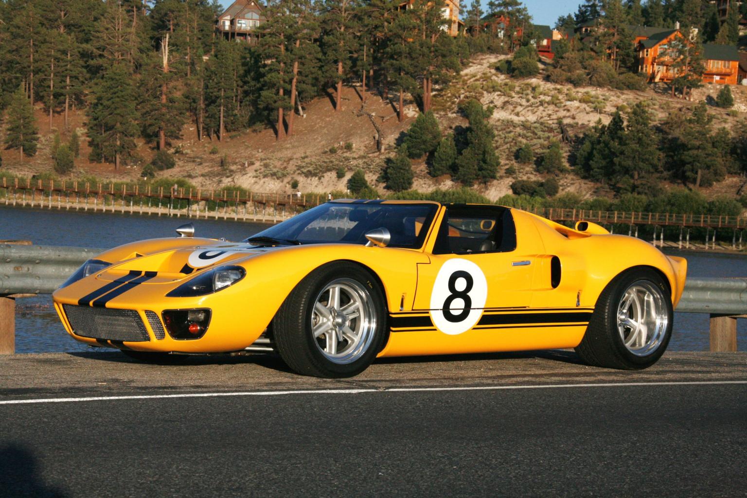

I bought one of the CAV spiders (or targas). Just finished converting it to a coupe (all in the timing). Mine was bought in Ca. Was told there were 4 of them built. I saw one one of the other ones in Tucson that was undergoing a rebuild after wrapping it around a fixed object. It was also yellow. It is a comfortable ride for 6'2 and a big guy (I am about the same size). If you want more room you can go to the foam seats (like SPF) instead of the seats that come w/ the CAV. I still have the doors and rear body molding if you want them. I have tried to attach a picture of what it looked like.
