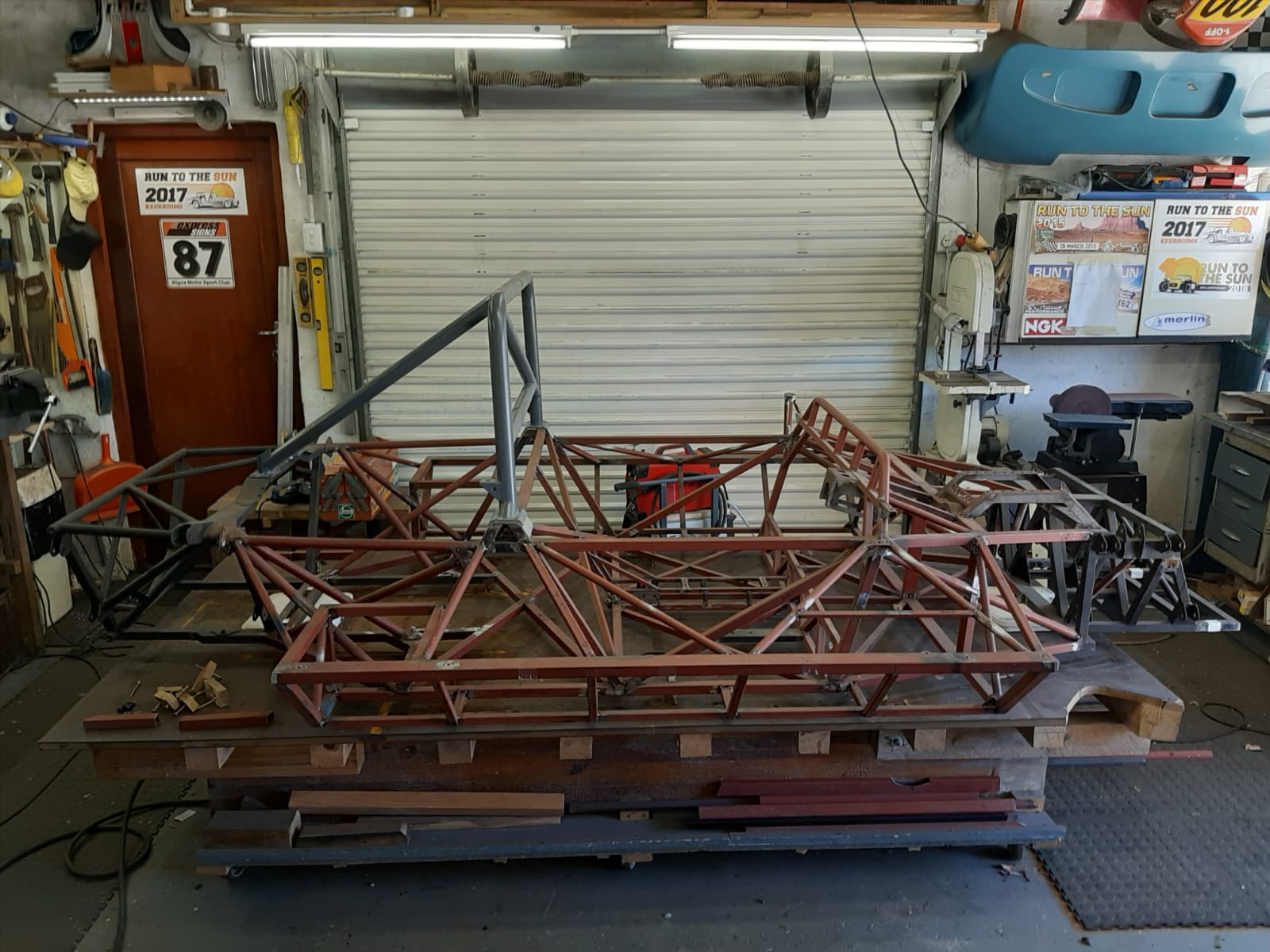

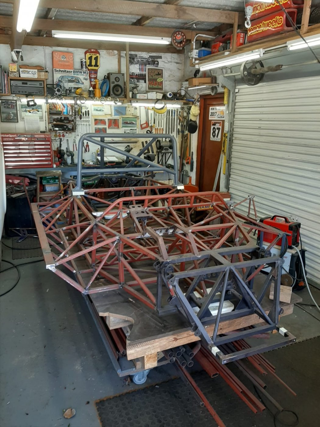

Finally a mention of some progress. Eventually I can unscrew the 99 percent finished tacked up space frame from the build table and weigh it. Very roughly (on bathroom scales) it weighs 110 kg / 243 lbs. without the roll bar and 123 kg / 271 lbs. with. That includes all mounting brackets for the suspension, steering system, pedal box etc., as well as in the order of 60 internally threaded bushes and weld nuts as attachment points for such as engine mountings, seatbelts, the front and rear body and door hinge mounting subframes, and the detachable rear chassis section.
Still lots of welding to do, but it does feel like this is another milestone I am pleased to have reached.
