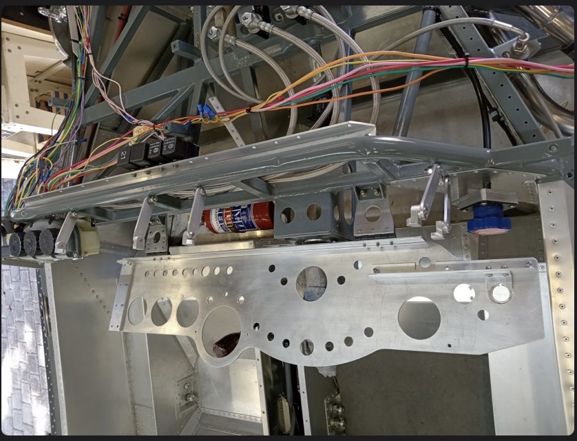

I've also mounted the dashboard, which I had laser cut in 3 mm (1/8") thick aluminum after several iterations of mockup.
The panel on the passenger side covers the fluid reservoirs, the fuse box and most of the relays. I'm not yet sure what finish to use on the dashboard, this panel as shown above is sanded with 600 grit and brushed with purple scotchbright in straight lines.
The main panel is mounted with hinges to the lower edge so it can flip down to enable easy access to the wiring and components behind it. The dash weighs 1.43 kg (3.15 lbs.).
