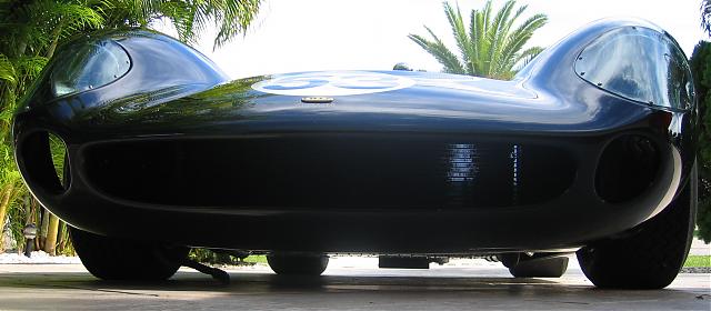

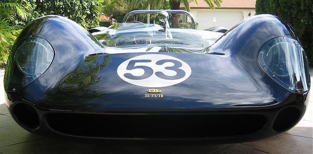

Hey fred,
Heres a picy I took which gives you same perspective. If you need more pictures of any certain angles etc let me know as I live only 3 miles from a 'real' T70 !!
Good work, keep it up, you've inspired many.

Thanks scratcher. I've been thinking for a while I have to add a bit more "bulge" to the inside side of the front wheel arch bulges (above the tops of the front wheels), and that top photo reinforces that.
My nose has ended up more like the "heritage" cars, or am I getting way too anal about this, and no one else sees any difference?
Fred W B
