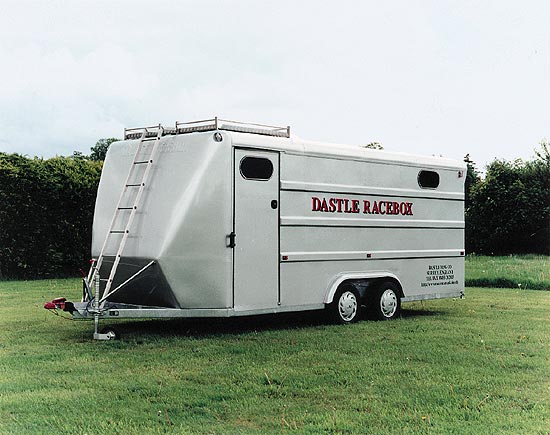

I can't believe you guys would spend multi $'000's on a '40 and not get one of these!
