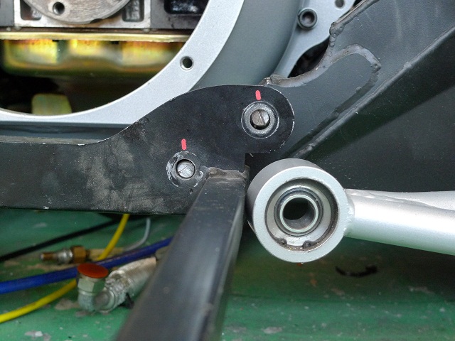

Probably I should have included this picture in the first place. Here's the lower right side. I cut the heads off the 1/2" bolts and slotted them for use as locating pins. The one on the left is centered in its ~1" long tube and threaded another 1" into the hoop behind. The one on the right is also threaded ~1" into the hoop and would like to go through that ear but obviously can't. The camera is aligned with the one on the right, so the one on the left looks off-center in its tube, but it's not.
You could probably pull all this together by starting each bolt just a few threads in, possibly aided by a drift ahead of the bolt, without damaging threads. I tried it without a drift and never found a sequence of bolt starting that worked. But then there are 720 different sequences so maybe I gave up too early. :cry:

I see your predicament, besides being annoying the misalignment of the holes shouldn't be there in the first place. The question is if the way the chassis is supported is contributing to the problem. I suspect not as we're looking at the bottom of the rear hoop and the SPF chassis is plenty strong.
Be that as it may, I'd be grinding out the holes in the base plate of the rear cage so the part fits on easily. The holes would be opened up enough to sleeve the bolt holes so once you know the cage is back on the car, square both horizontally and vertically, the sleeves can get tig welded into the base plate.
Then the part is absolutely perfect for your car.
Bingo!
I've been trying to think of a clean way to do that. As it is those holes in the base plate are already sleeved with 1/2" ID tubing, and the magnitude of misalignment is around the tubing wall thickness so my quandary was how do I "relocate" them. Obviously a hole saw of size = tube OD would do it, if I could pilot the hole saw somehow (stuff the tube with 1/2" AL rod or carefully chosen/fabbed tubing).
Or just drill 'em out with size=OD drill and replace them. I guess that's the fastest.
Or... ???
I wasn't quite so worried about moving the other (link-end) holes because, after all, those ears are really just de-cantilevering the link mounting bolts; they're not establishing suspension geometry.
Comments?
