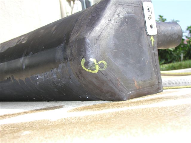

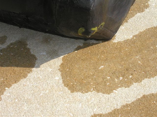

I have been working on the fuel smell on my CAV Mono and it led me to pull the right fuel cell to follow up on suspicious staining under the right side of the car.
It appears that the front bladder wall on the cell is not adequately bonded. There is no sign of abrasion or abuse so it looks like an OEM issue. The cell was made June 2002. Attached are photos and perhaps they may be useful for others to check.

Pat
The yellow circles and arrow point to the leaks.
