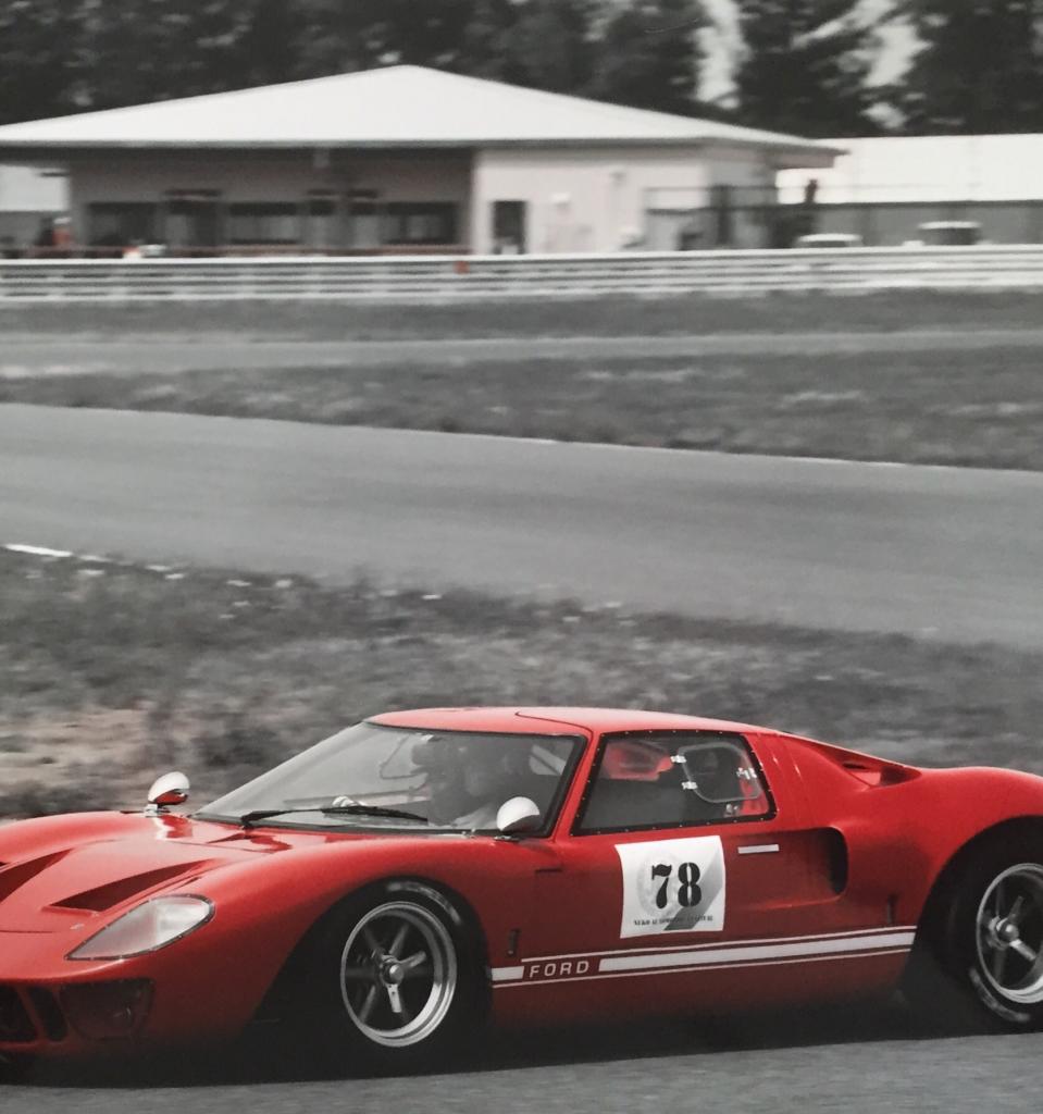

I use Vintage Wheel with 15' which I'm pretty satisfied. Yuji
