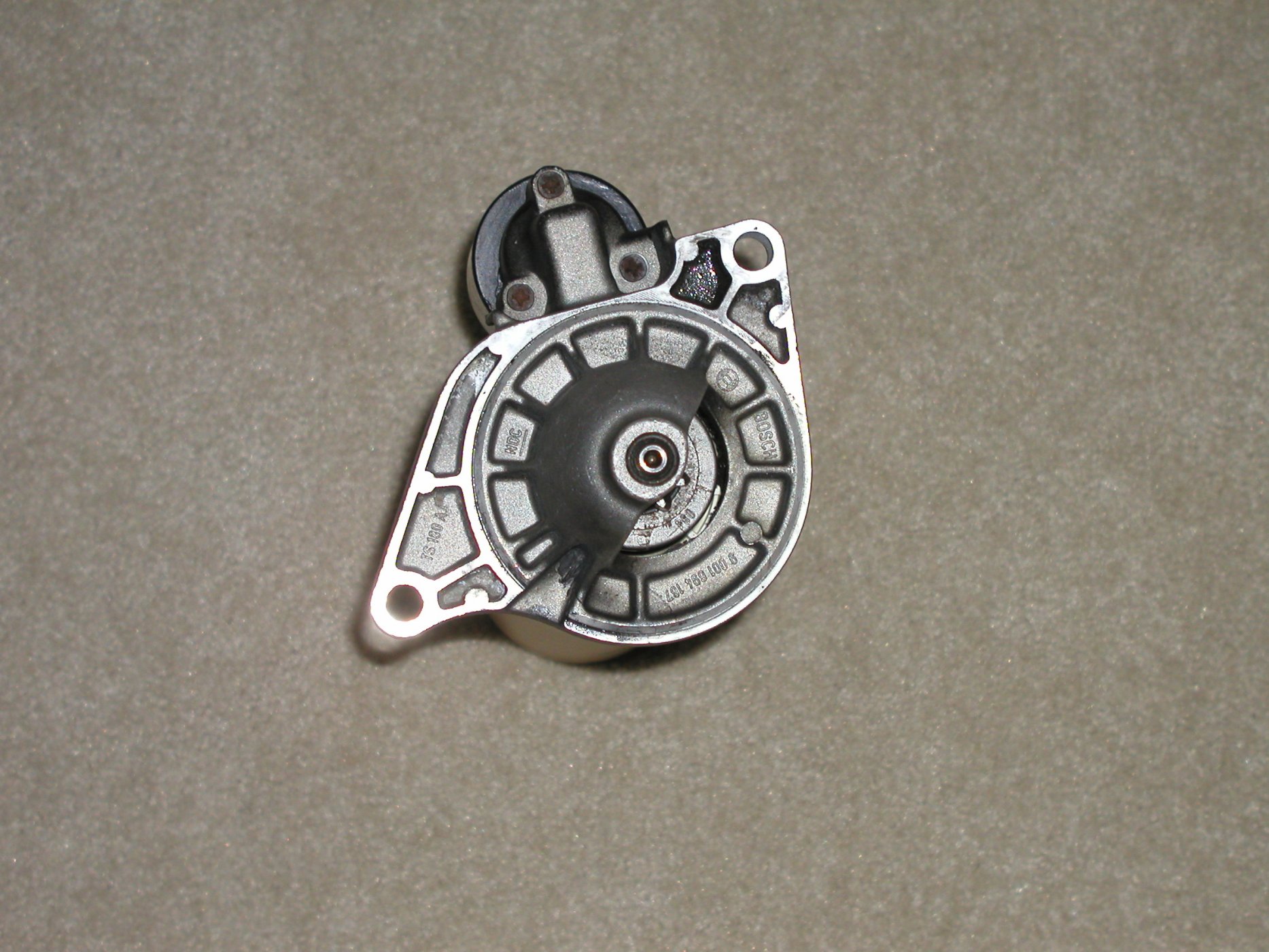

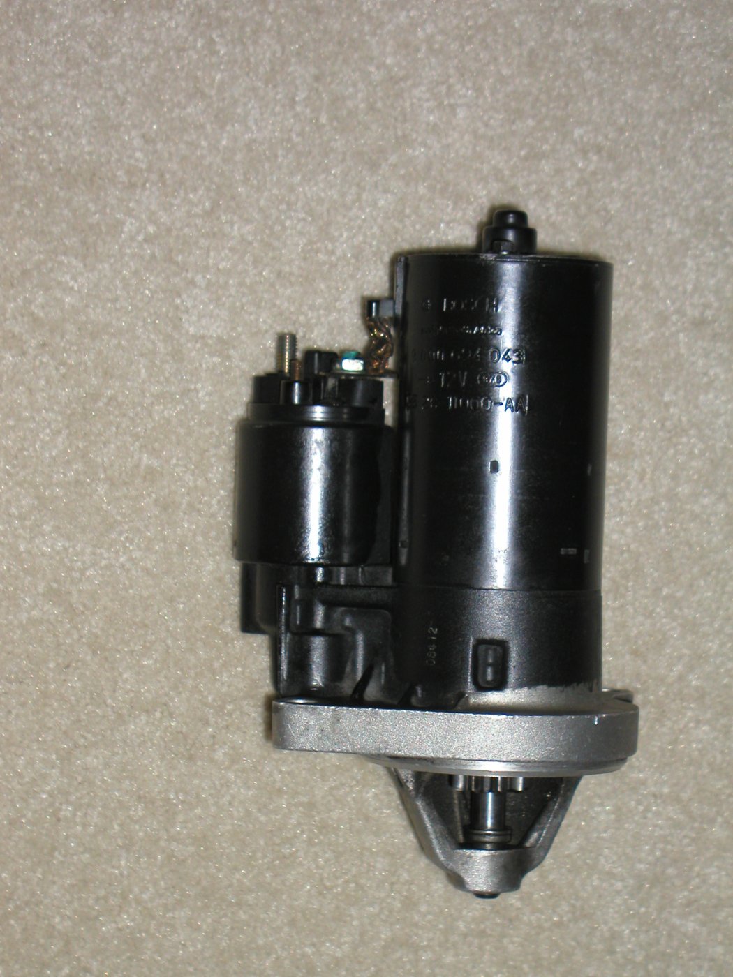

anyone know what startermotor was fitted to CAV out of the factory? my car has a 5speed Audi transaxle fitted with adapter plate to a 302 ford small block, starter is mounted to the forward side of the bell housing, the solenoid is getting a little weak and I want to replace it. it is a Bosch starter made in South Africa, part number on the starter is: 9 000 694 o43, part number on solenoid is: 331 303 505, any help greatly appreciated , thanks in advance, Neville in New York.

I agree with Ian, taking it to starter/alternator shop is by far the easiest option. They'll bench test it and even paint it. It will comeback as new. But given the numbers you provided, you likely have an 016 Audi box and the starter is probably out of a '74-'78 Ford Capri V-6. On the case says it has BOSCH 9 000 694 043 and that number is followed by the Ford #952C-11000-AA. Bosch, Lucas, Prestolite and Delco have cross reference part numbers. FYI, if you don't have at least a 100AMP alternator, you'll have issues with the starter over time. When I put mine in for rebuild, they put on a bigger solenoid and a splash guard to protect the drain hole. Where it's mounted on most 5.0L SBF engines leave them susceptible for ingesting water.
