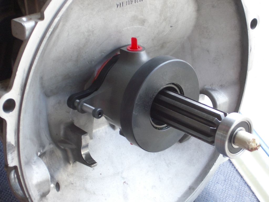

Hello Ron,
I have a Tilton hydraulic throw out bearing in my car (FSB 342/ZF-2) but have not finished the installation so I cannot recommend it until I have some driving time. I also have an untried Earl’s adapter on order to go from the stock CAV clutch line into standard AN-4
M12-100 TO -4AN ADAPTER
P/N# 306-4-M121D--£10.63 each
I will be glad to post the Tilton part number information Monday night when I am back in the shop with the car.

I have included part numbers on my website for the clutch system and pedal system. Obviously Bob and I are using different clutches and thus need different T/O bearings. Both of my systems work well. I encourage those reading this post not to mix and match parts (e.g. Bob's T/O and Gary's clutch setup) unless you want to look over the engineering, etc.
Gary and Ron,
Gary, thanks for adding part number specifics to your website. This information is very helpful to me also as it is a completely engineered solution which obviously is working well for you. That makes it a very safe bet.
Ron, forget my Tilton bearing and go with Gary on this, his setup has already proven itself on the track and on the road. If I was staring from scratch I would also follow his recommendations. The McLeod parts I listed are also a known good setup but not as trick as the Tilton brand. Depending on how my engine and trans go together, I might end up doing the same.
