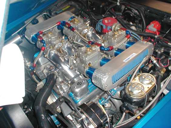

OK, then here's my final offer: DCOE webers a la GS Corvette and Lamborghini. After all, who wants to look at an ugly old four barrel. Might as well paint the window. :shocked:
OK, then here's my final offer: cross-ram webers a la GS Corvette. After all, who wants to look at an ugly old four barrel. Might as well paint the window. :shocked:
Or, do what Lamborghini did with the front engine cars (and the early Countachs) when there was a clearance problem: DCOE webers.
Noooooo, 1 carb is problem enough to get tuned perfectly ......... any more, forget that!

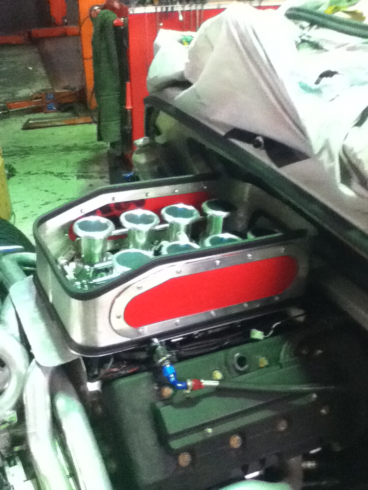

Why not make a duct come tray out of alloy sheet and use the rear window as the lid.
So you have an alloy tray with a large seal on the top that seals on the underside of the window.
You can use K & N foam to put the filter in a position that suits.
The pic is the one I made for my car it runs a clear lid, but lets say it was taller and sealed on the window when the clip was put down.
If you are worried about heat cover it in turbo blanket or similar on the outside.

Who said it has to be above the barb you need to think outside the square when you have space restrictions, Put the filter all the way down floor or sides of the tray as per the pic.
The tray starts at the carby area with a seal to the window it can run down the inside of the window to the rear, you could tear drop it as it travels down the window and put the hose and filter on the end were it is not seen if that suits you.
OR just run it down the inside of the window and have the filter in the side or floor of the tray as per pic.
Or a tray goes under the carby it seals on the window the tray drops down into the massive void of space at the rear of the intake manifold ,the filter is mounted into a sheet alloy box, use the foam or panel filters, bring a duct in for cold air.
You are stuck with the materials you have chosen ,I would look at sheet alloy ,if you want the trick more modern look get it covered in carbon adhesive.
People look in that window I would do something special but not complex
I think the bend out of the carby is setting the layout for your design.
You change that via a tray or whatever and you can the change the rest of the layout.
Also I would think a filter area of say 3 times the entry of the carby would be more than enough. the large it is the less you have to clean it.
