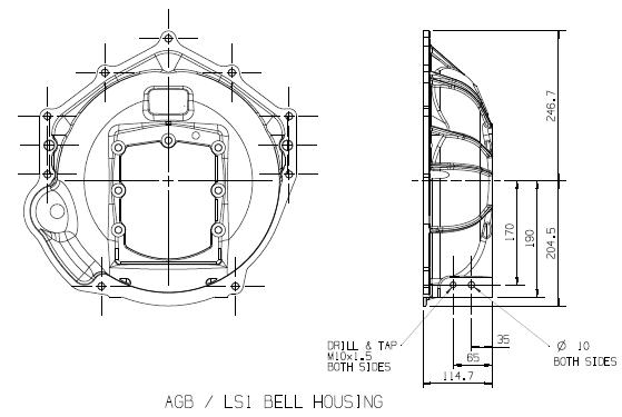

Try the Albins bellhousing. Mine arrived yesterday, and I'm using the LS2. It has a depth of 114.7mm, and uses the standard clutch and starter. Great looking piece of gear, cost is just over AU$1000 delivered.

I'm out of town currently (can't look at the motor), but if memory serves correctly, the pattern is the same except one of the bolts is missing. Not sure which one until I look, but other than that "minor" difference, I believe they matched. I know KEP shows a different adapter than the Gen 2 motors.

Note that the TOP bellhousing bolt is normally not used on older bellhousing.
