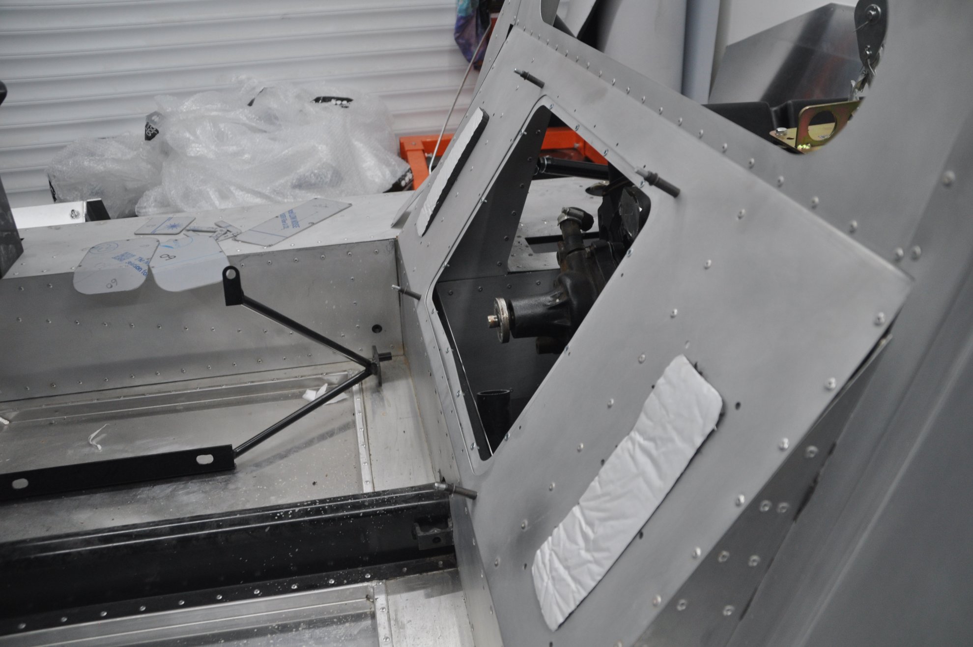

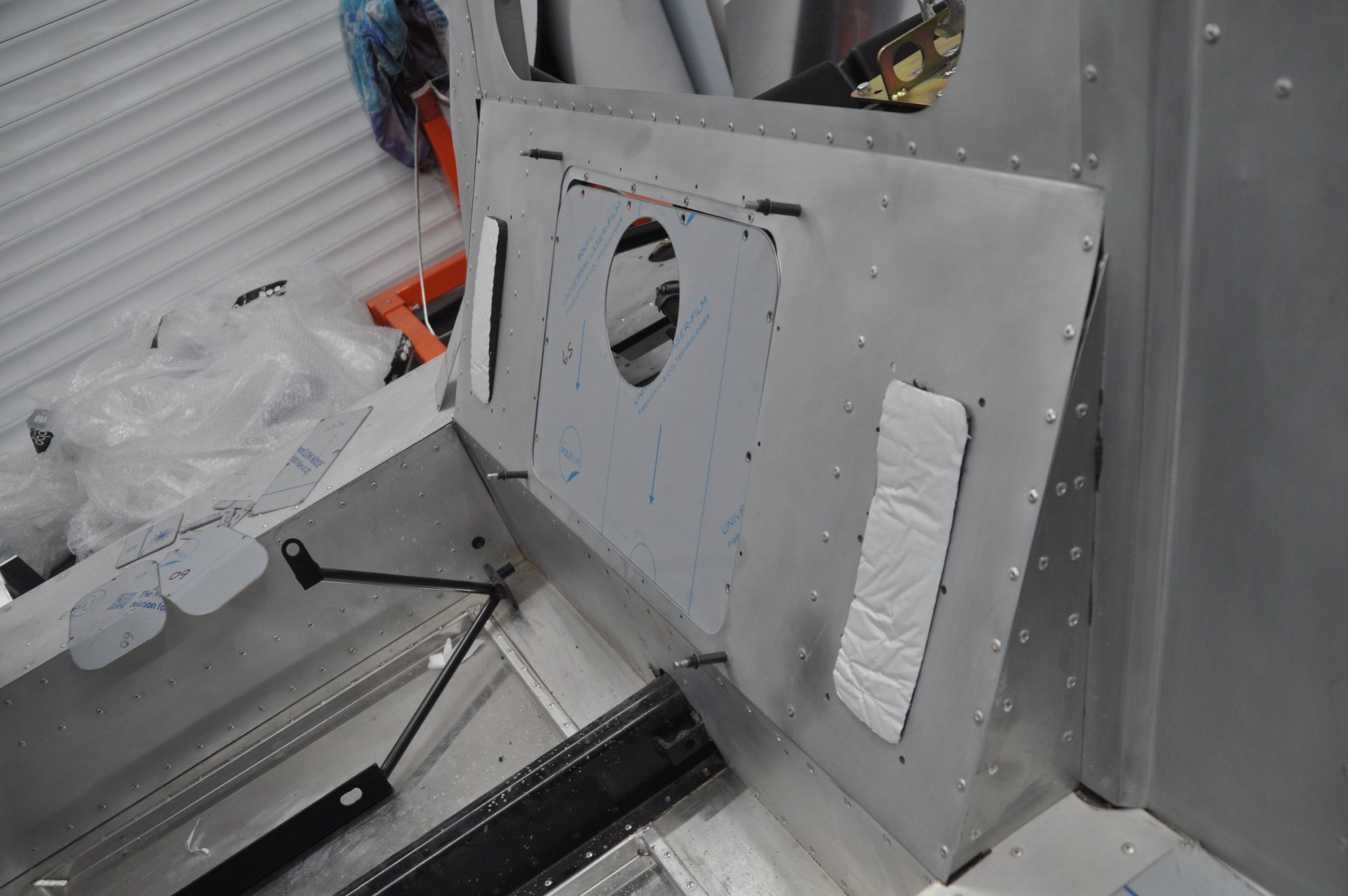

I've been getting on with a few bits and bobs, I have dry fit the suspension although I'm just waiting for some shims to be delivered to tighten it all up (and given it's all imperial I can't just walk 10min round the corner to screwfix), although I don't have any uprights yet so there isn't much more I can do till I get them.

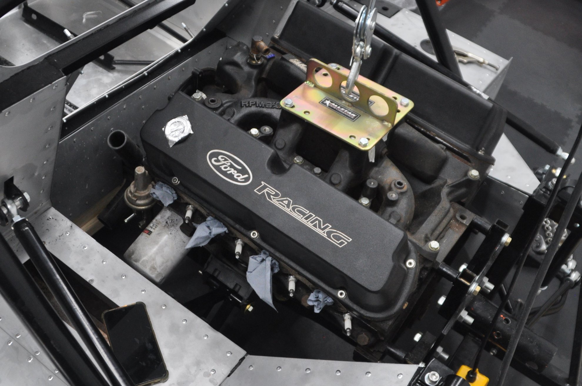

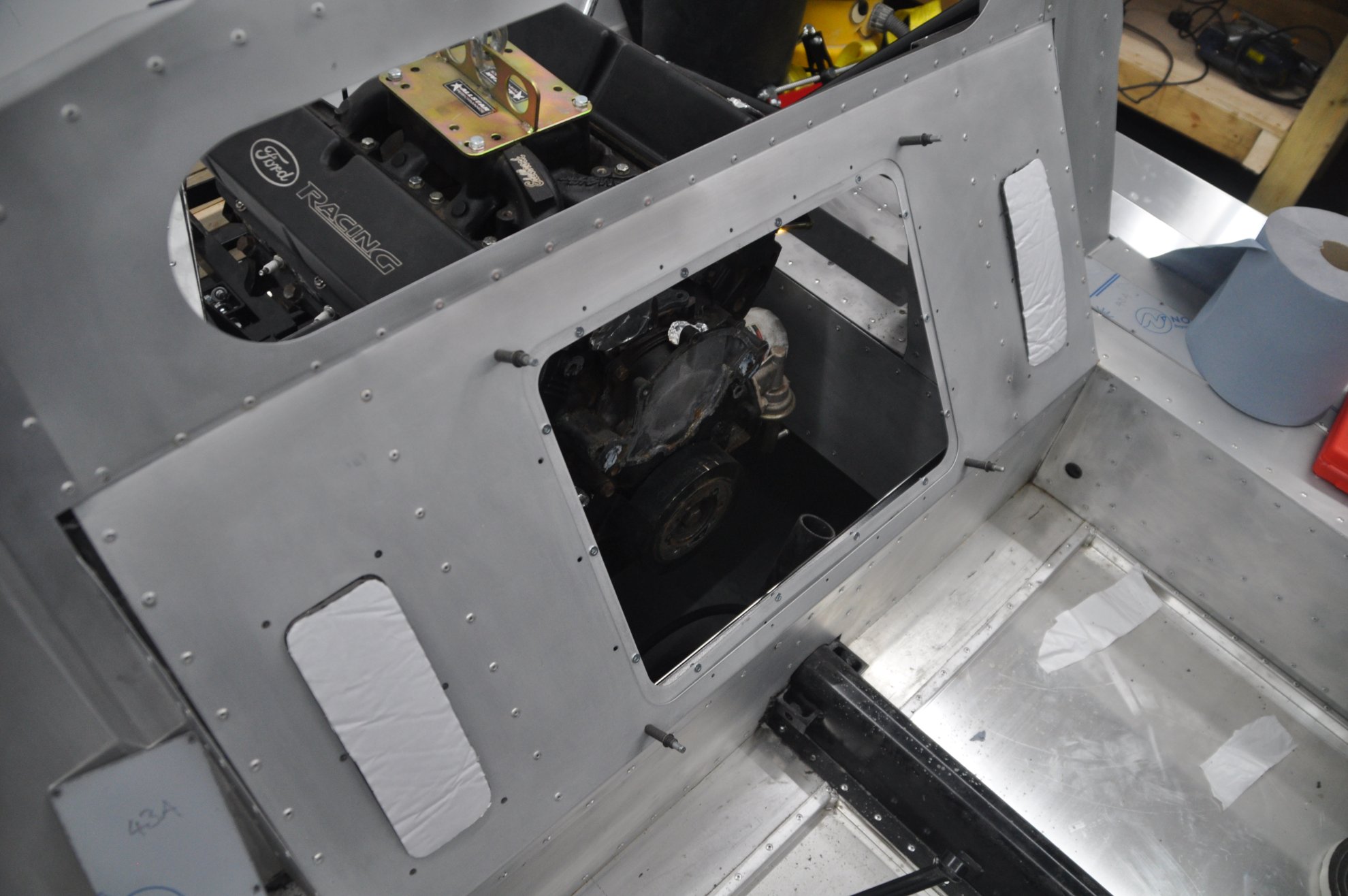

What I have done is test fit the engine in the car, I seem to have more room that I expected, there is about a 140mm air gap from the crankshaft damper to the chassis, is this normal for fitting with a ZF gearbox?
Often a big gap low down but gets tight to the bulkhead at water pump level due to sloping of bulkhead.
I've refitting the old water pump which I was expecting to poke into the cabin slightly (hence the predefined hole in the paneling), but even that sits further back

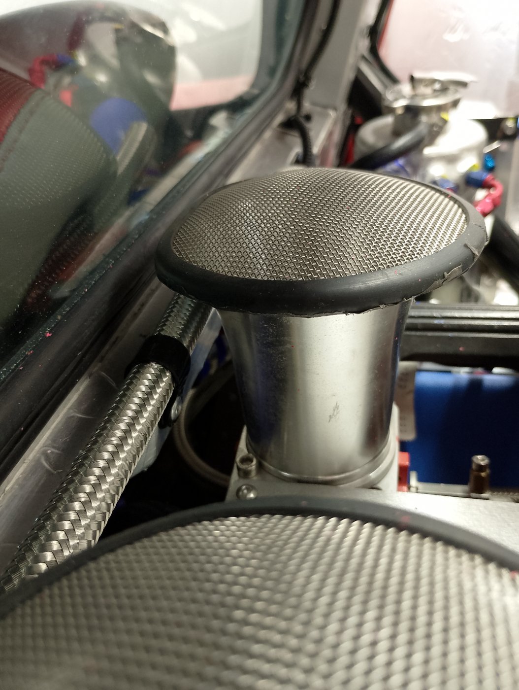

My engine was positioned like that when I first fitted it on its own. Be careful as, when the bellhousing is attached and located on the chassis, you may find you'll need to move the engine forward. I had to move my engine mounts forward about 40-50mm to get the bellhousing in the right place. I'm happy it is in the correct place now as, with the ZFQ transmission installed, the driveshafts line up with the rear hubs. Of course, now I have very little room at the front of the engine. Like you, I'm using an electric water pump which saves space. However, now I have fitted my throttle bodies to the engine, their inlet trumpet is very close to the window to the cockpit.
Hi Rob that is my concern, would you mind measuring from the front of the bell house to the driveshafts on the gear box for me please so that I can double check? Also did you get the bell housimg and gearbox from AK?

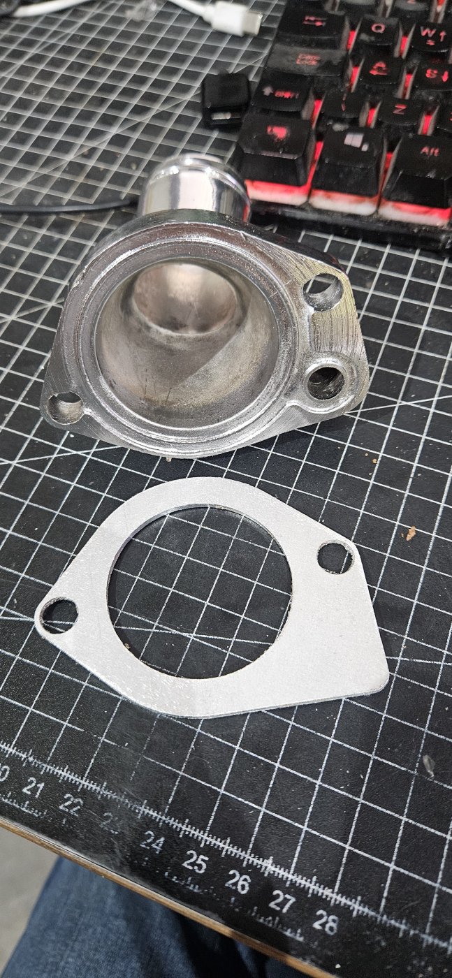

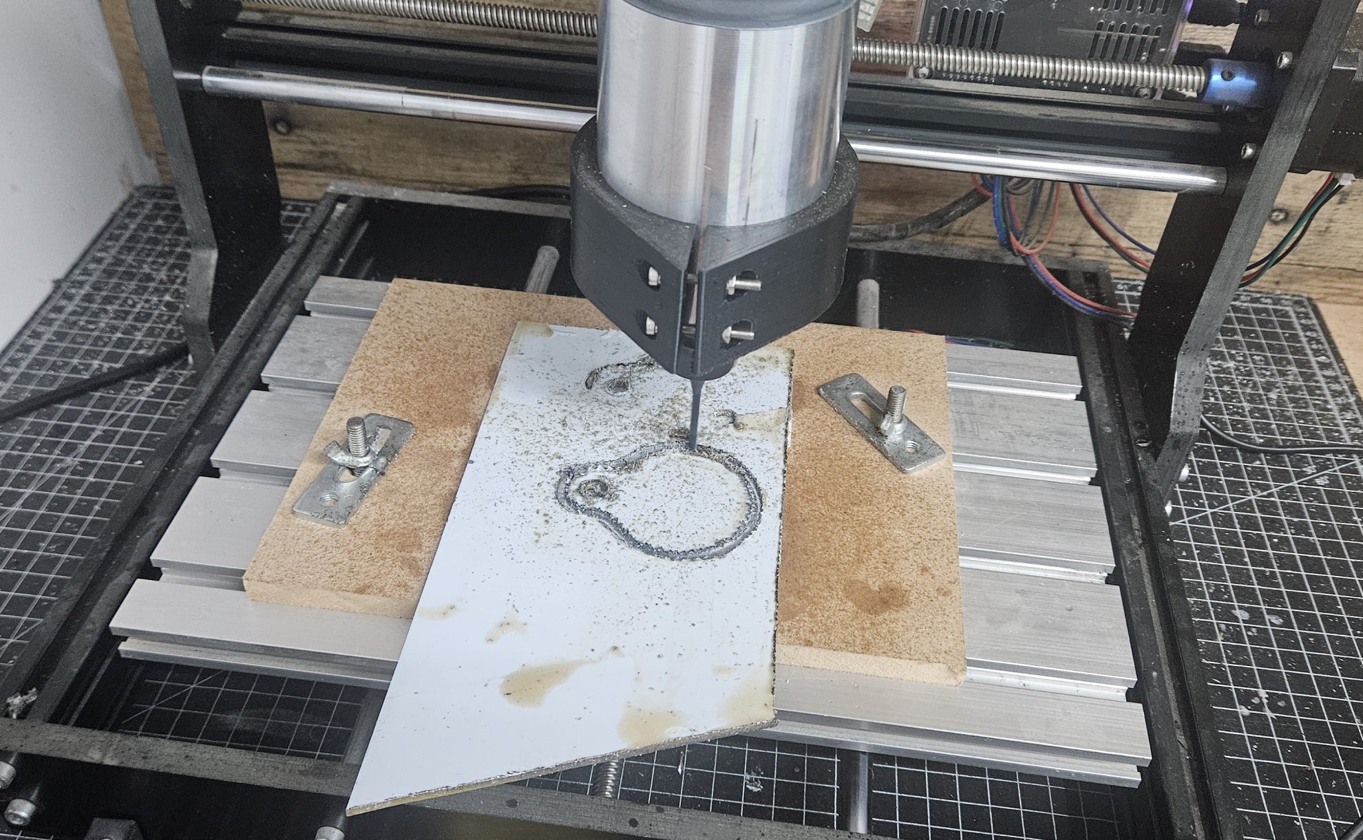

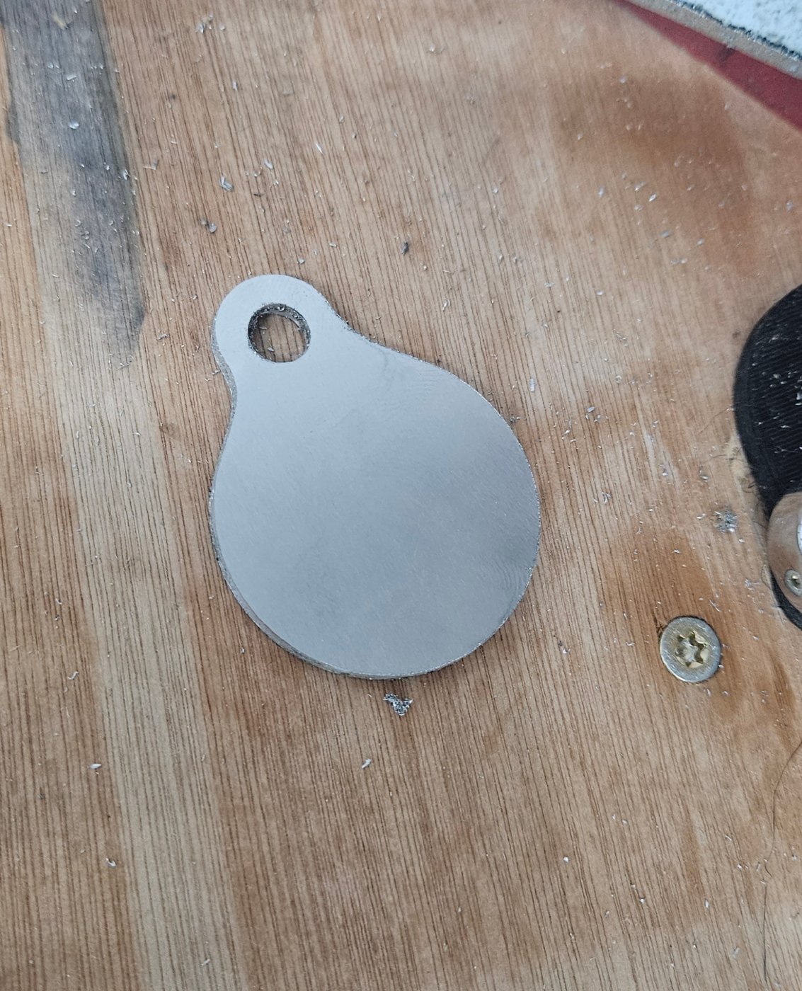

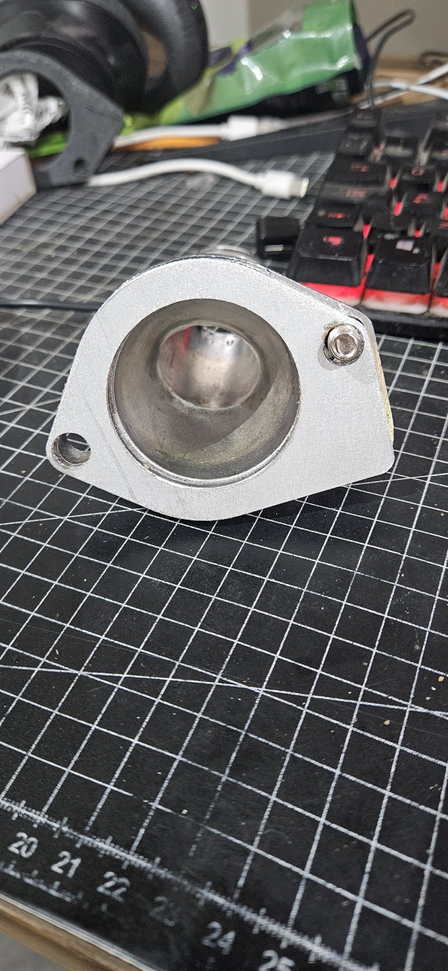

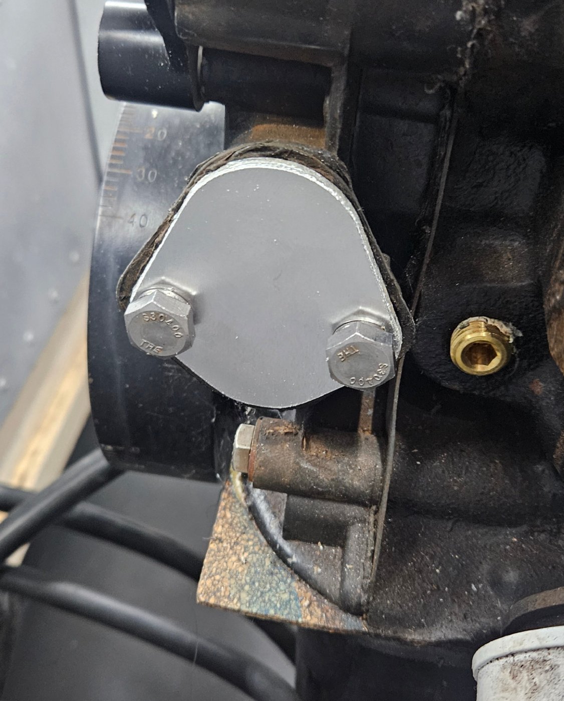

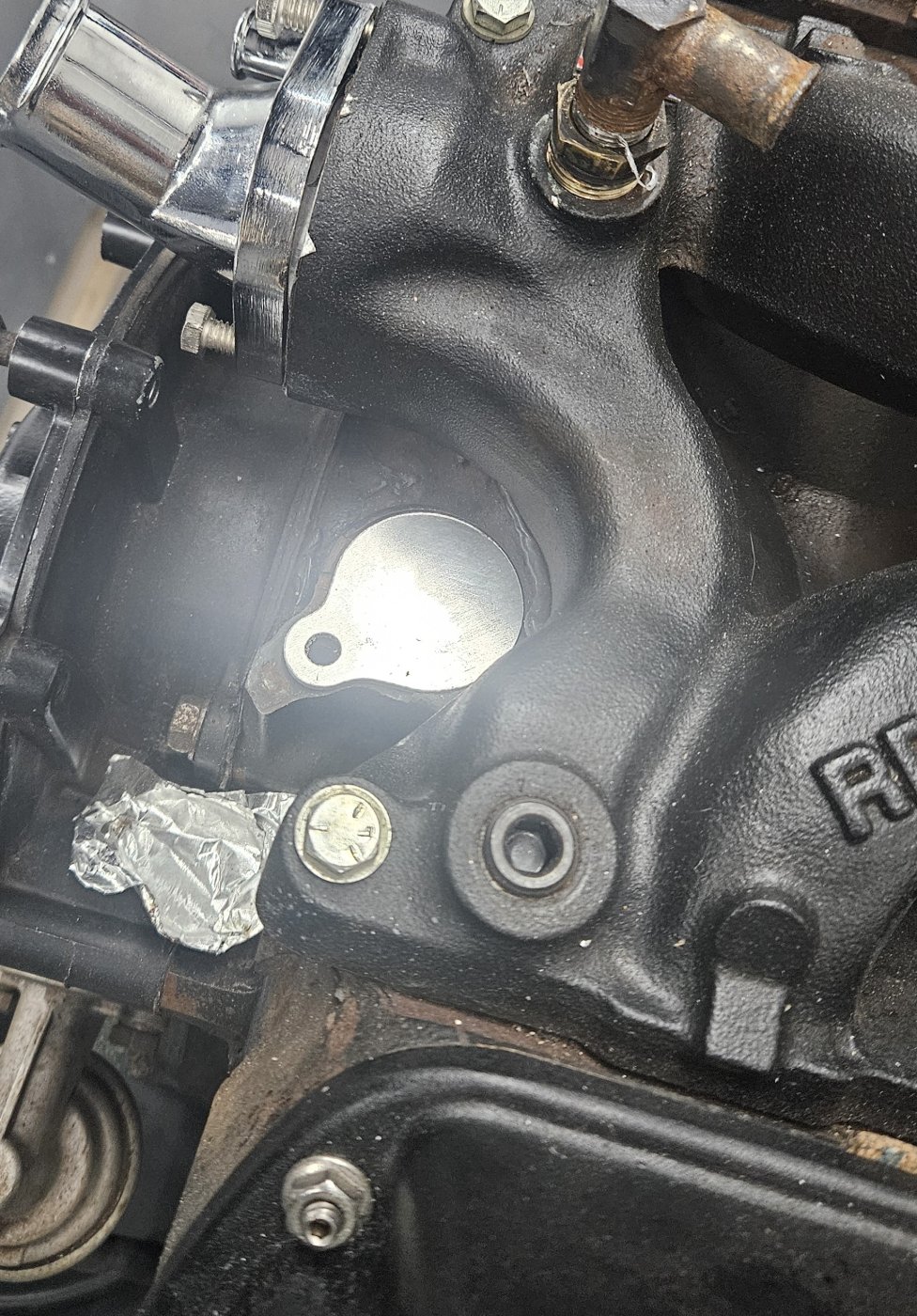

There's something strangely satisfying about CNC (above 3d printing), here's another blanking plate for the thermostat replacement, I've just blanked off the heater feed as I don't need this here.
not wishing to gate crash but the following may be usefaul
I have ak 302 chassis for quaife and ak supplied bellhousing and quaife box
distance from where engine 'mounts to bell housing' to 'centre of drive shaft' on box is 25.5 cm
I had to move my box pickup slots and also move engine mounts to make it all fit.

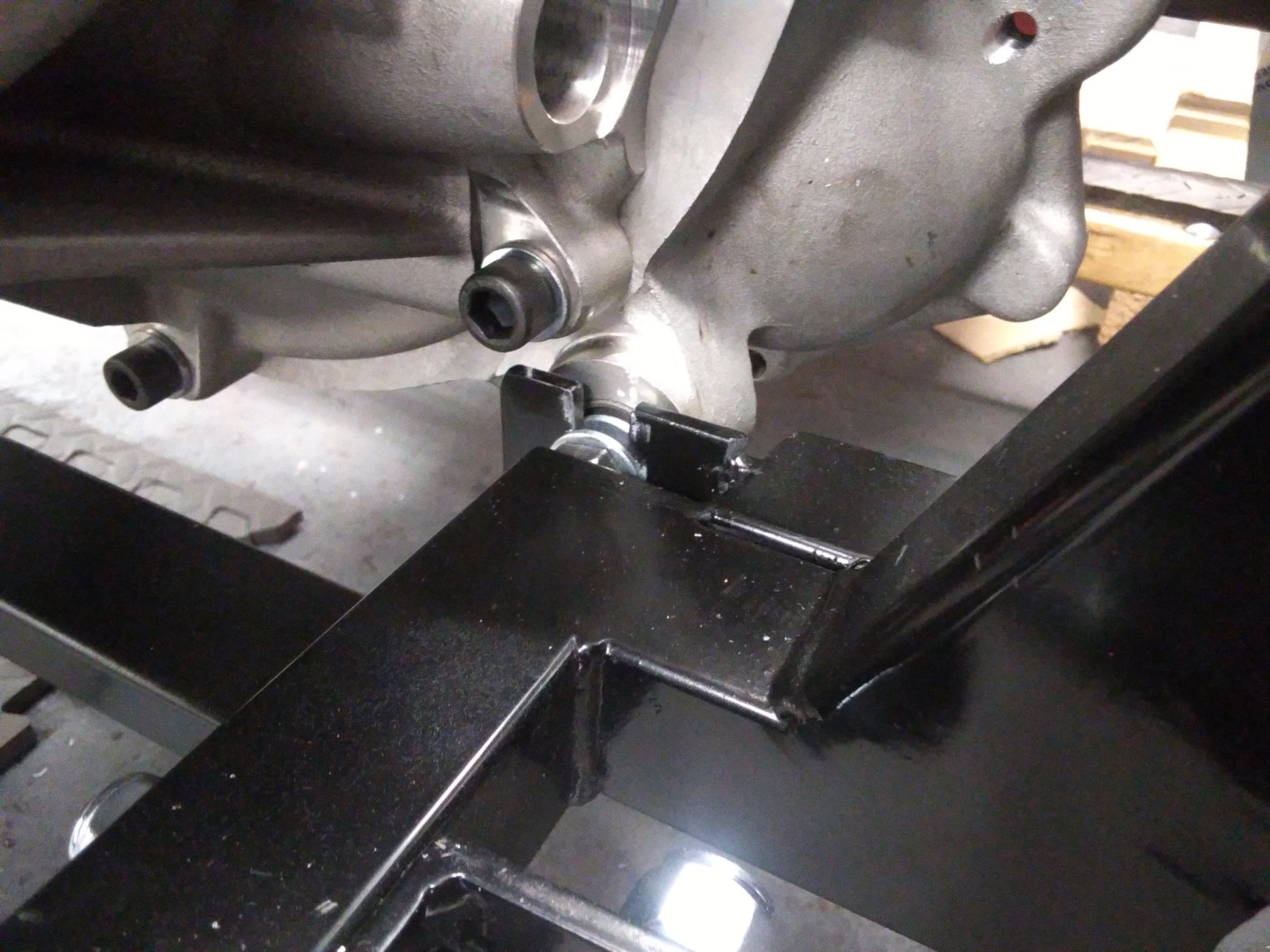

My trumpet is very close to rear screen but i have added a rose jointed link for aft between engine and chassis

Awesome, thanks Jerry, looks like I need to move the engine forward by about 50mm
I moved the engine mounts forward 60mm.
The distance from the front of the bellhousing to the centreline of the driveshafts on the transmission is, like Jerry, 255mm.
You'll have to move the engine if you are using the Quaife ZFQ. The position of the engine and gearbox is determined by aligning the driveshafts with the rear hubs and also the input shaft on the gearbox fitting correctly into the spigot bearing in the 302 crankshaft.
The reason the engine mounts on the AK chassis are in the wrong place for us is the chassis is designed for the 302 with the UN1. The ZFQ has driveshaft outputs in a different place hence needing to move the engine forward. I was talking to Jon on the AK stand at Malvern this weekend and I believe the plan is to modify future chassis accordlingly.
I've just heard back from Jon at AK and it looks like there was a misalignment between the jigs they were given and the paperwork, it seems that the first hole should be 365mm back from the bulkhead which aligns with with 50mm difference (not sure if this was a UN1 vs ZFQ difference or not)
I didn't want to have to buy the gearbox yet, but looks like that is going to be my next big purchase as I can't really do anything meaningful in the engine bay until I have the engine located properly

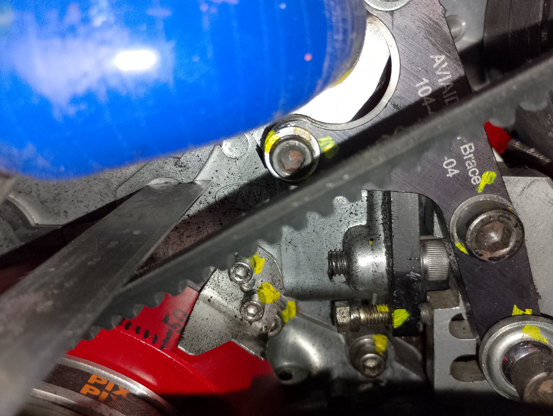

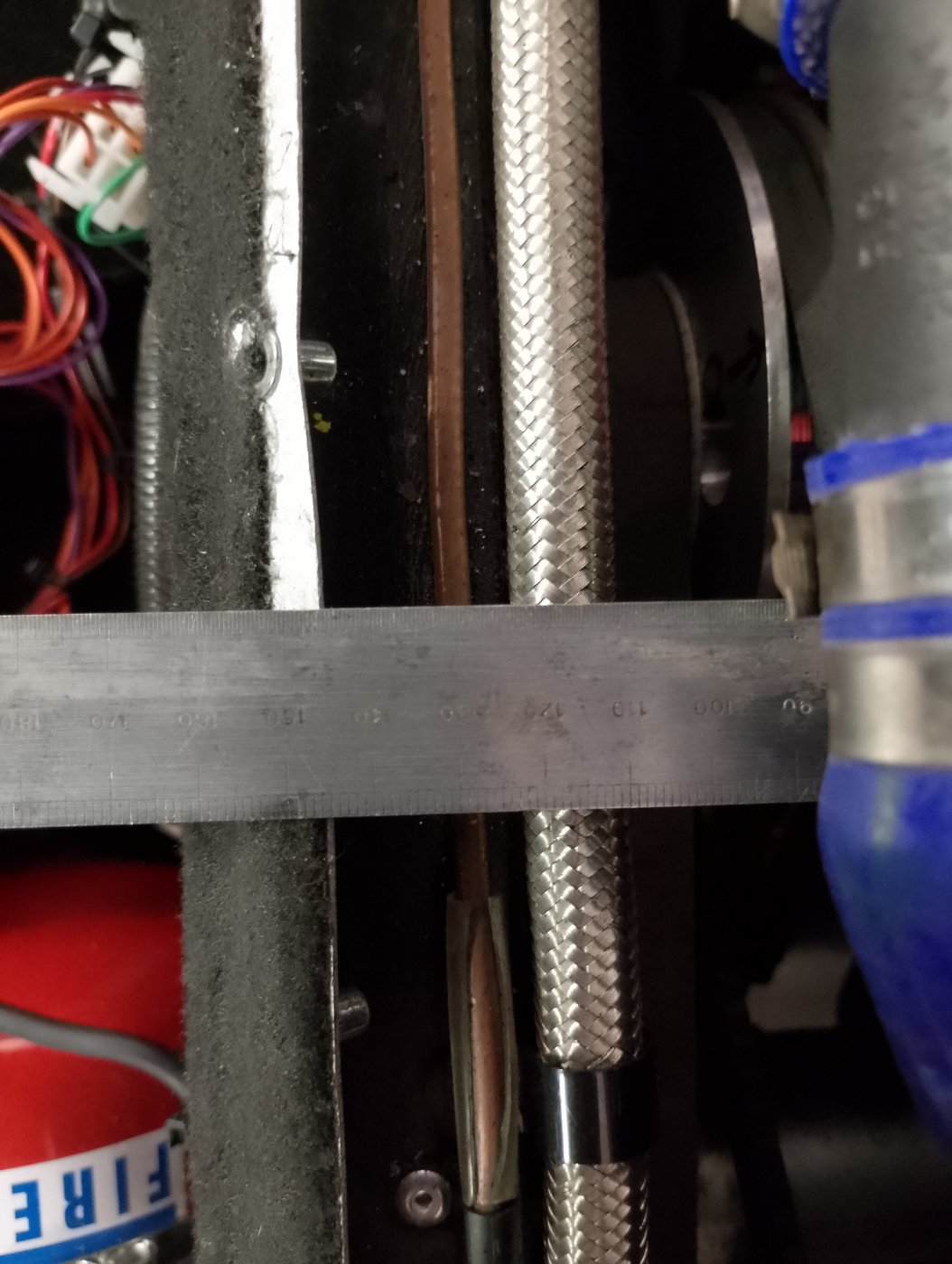

have got another measurement that may be usefull
distance from front chain cover to chassis
pictures attached
Jerry
