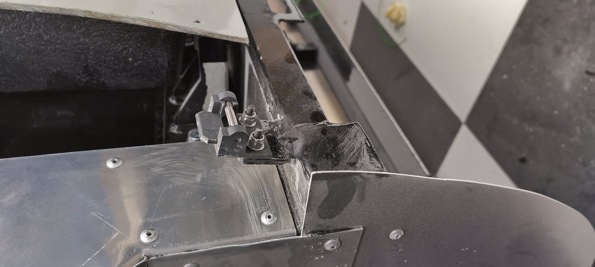

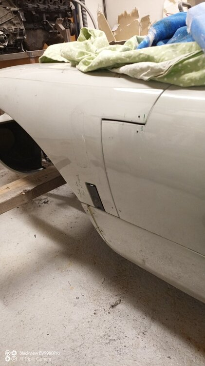

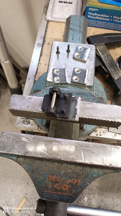

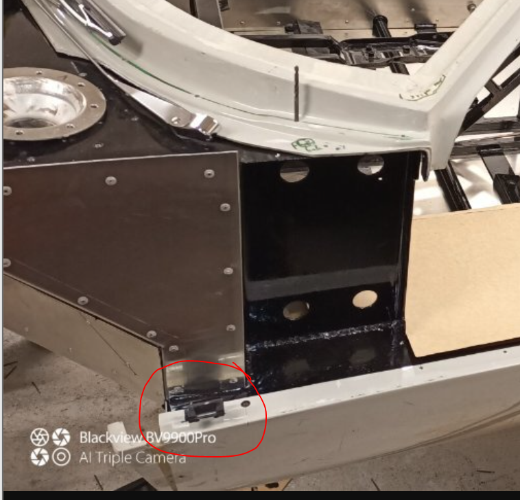

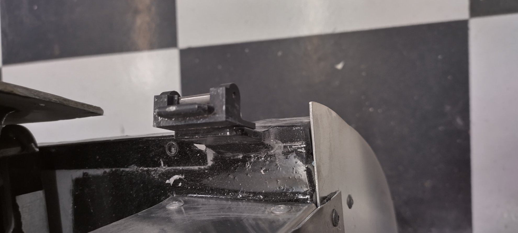

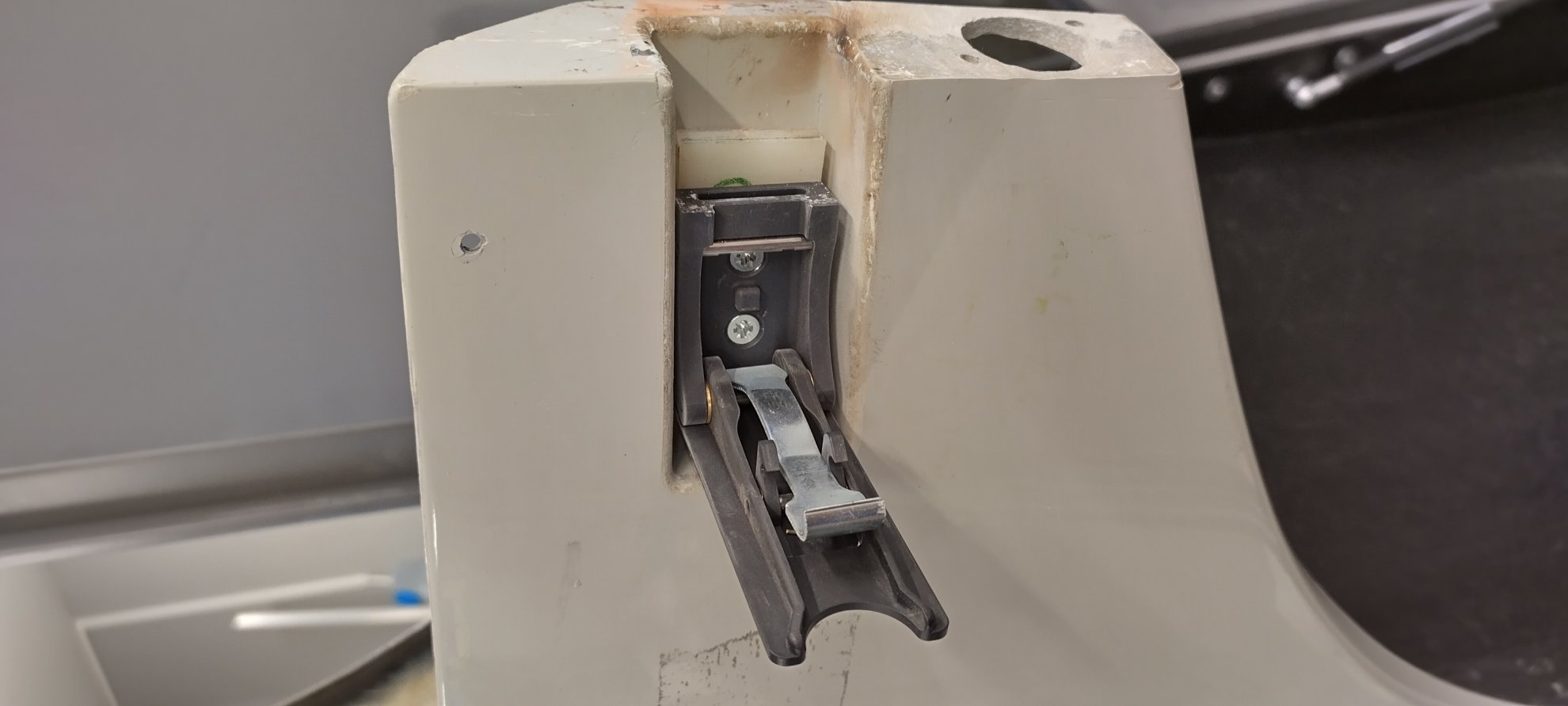

The alternative i mentioned does NOT need any modifications, it fits nicely in the recess in the clam.
The lower part that attaches to the frame has to have a small tab made to mount it though and can't be screwed directly into the frame.
Attached from my own build down below.

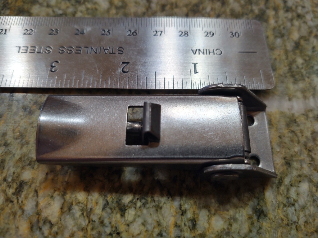

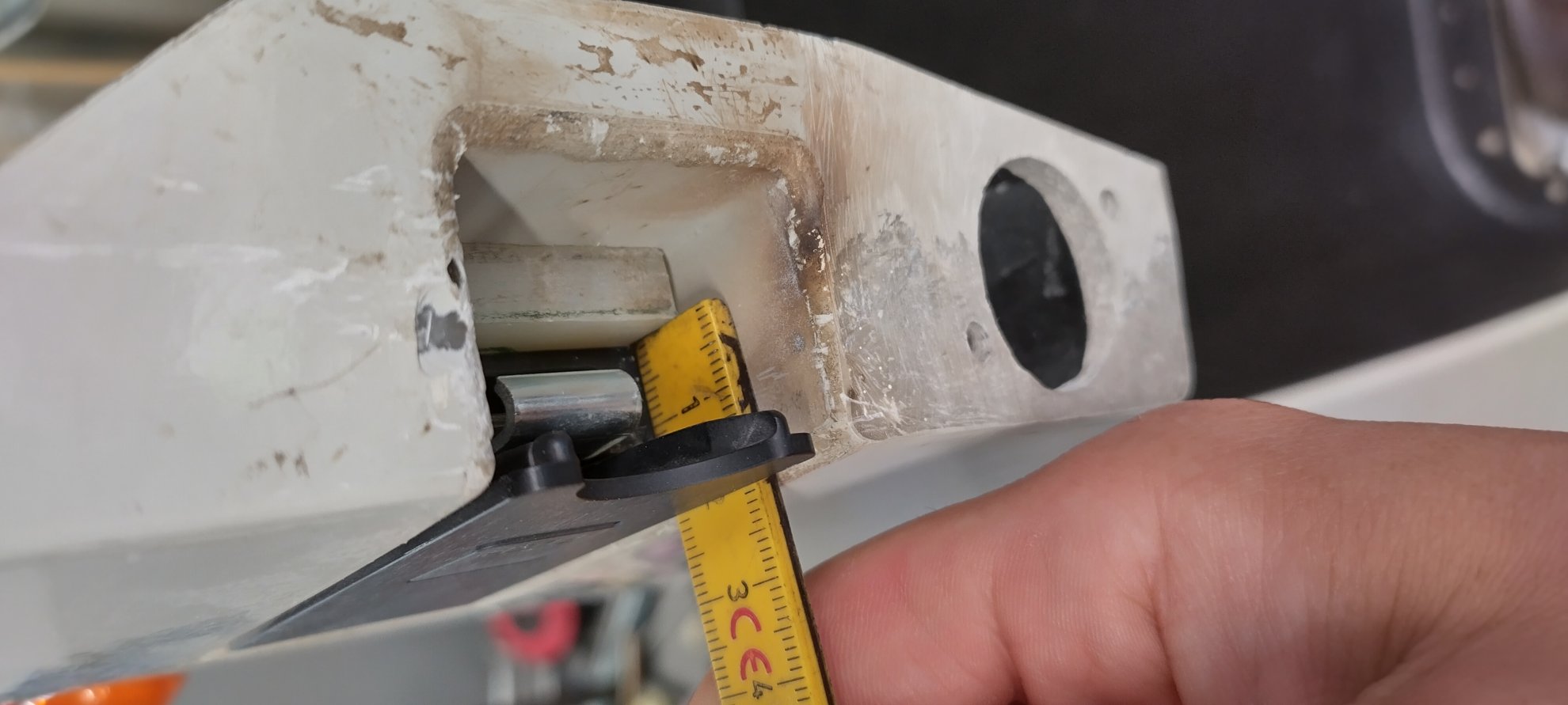

The Aerocatch latches look interesting. Wondering how to get the anodizing off to get them back to raw aluminum. I'm trying to find measurements of how big the latches are. Looks like the only mod needed would be a 90 degree piece bolted to the chassis that the catch would bolt to.
Ya, I contacted them last week.

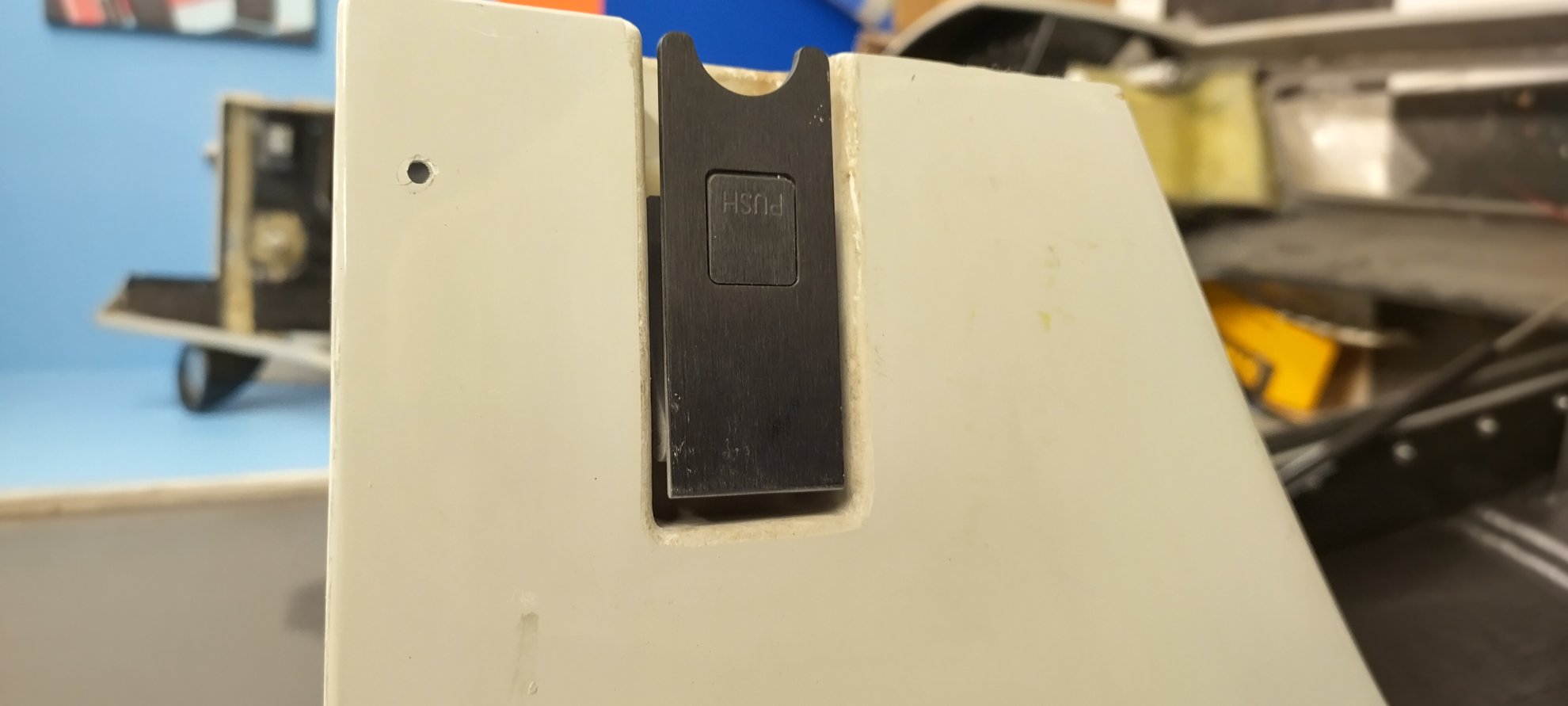

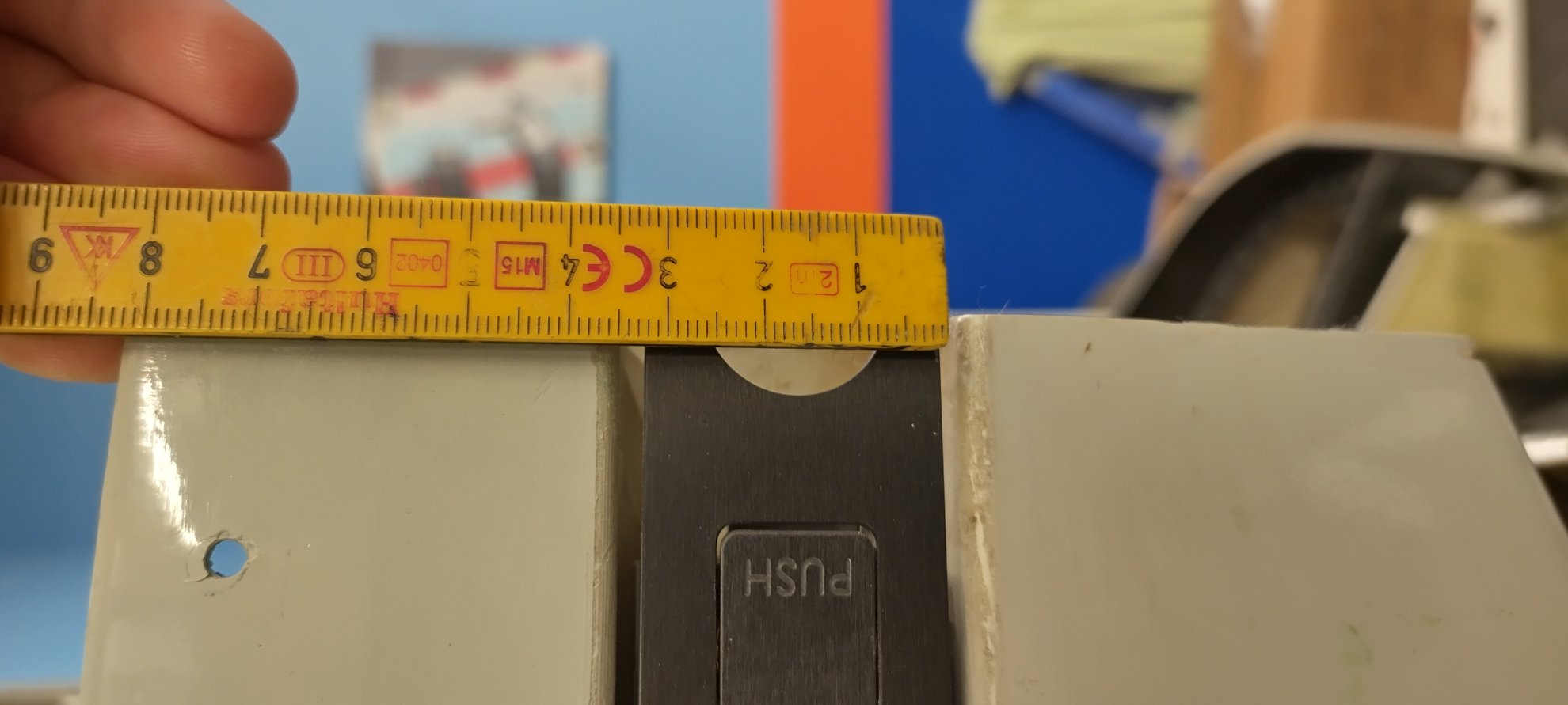

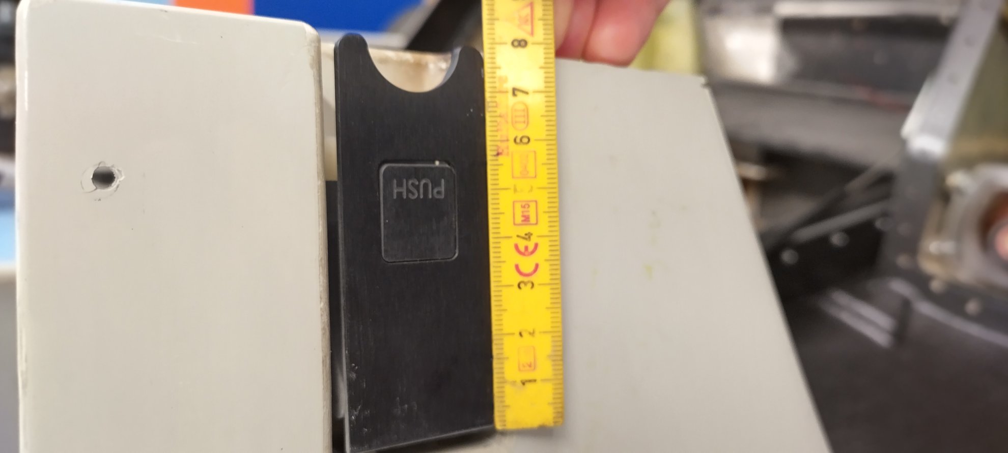

They aint cheap, but fits nicely in the clam reccesses.
Measures in pictures.

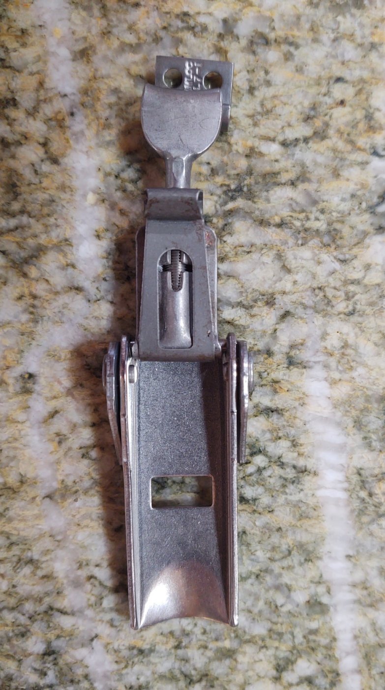

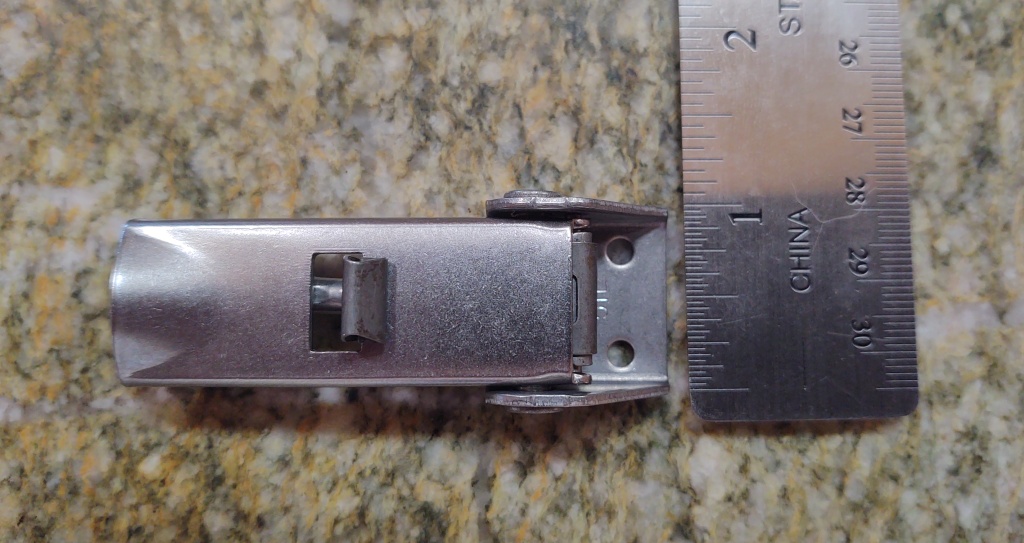

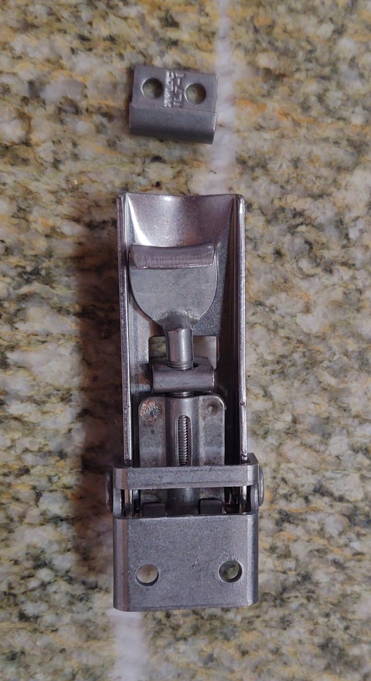

I have a few Camloc 51L stainless steel latches with a secondary lock. These are new old stock aerospace latches. Includes stainless steel catch. Working load 350 lbs. $50 per pair plus shipping.
Camloc Latches 51L Series Specs - Basic - Secondary Lock Versions

The camlocs are very similar to what I always sent with the car. They just don’t look substantial enough for my taste. I’ve seen them on a few AP cars that were for sale on Bring a Trailer. I think the Aerocatch latches will be a good compromise.
