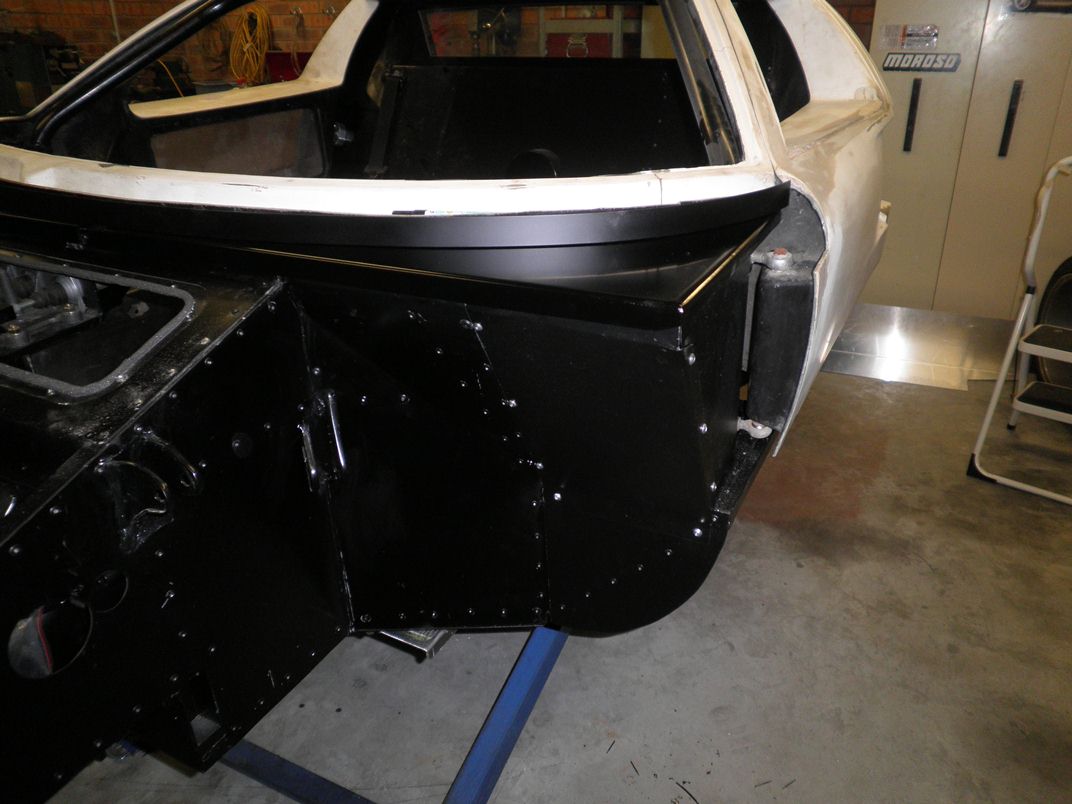

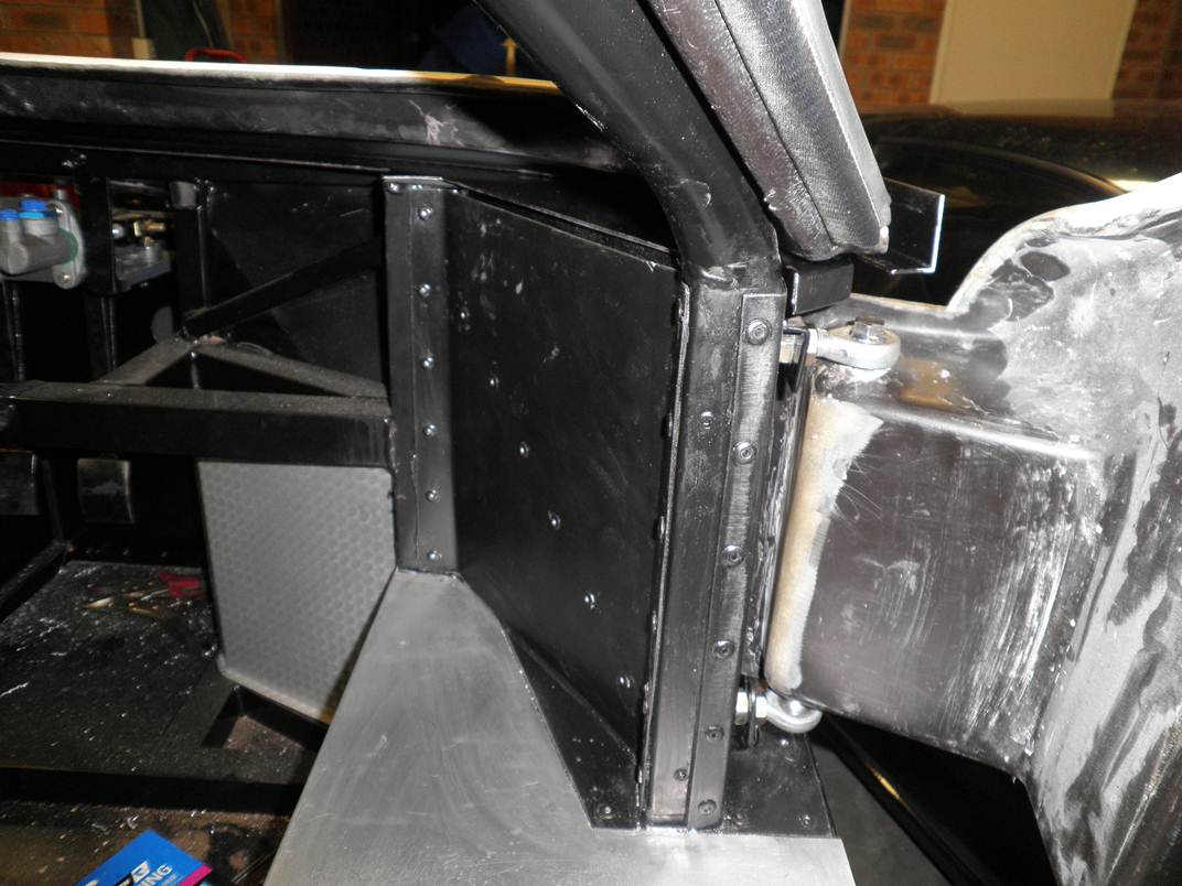

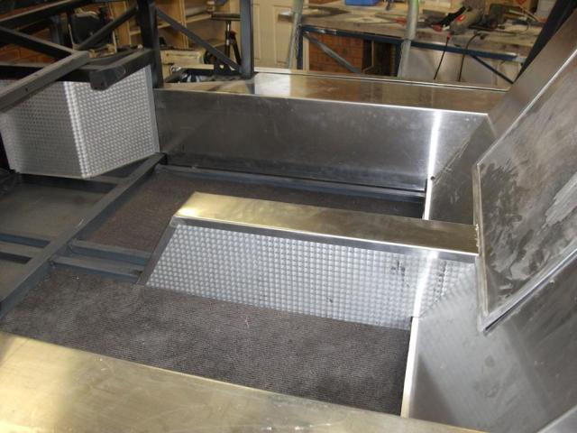

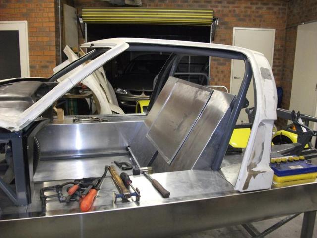

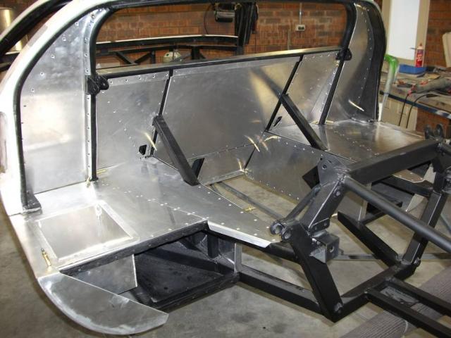

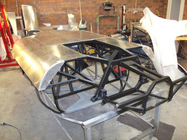

Have been continuing the install of the internal panelling, and wondering if I will ever get there.
A comment from one of our Kiwi friends on another scratchbuild thread explained the various stages of scratchbuilt items. He is SO right - It should be rule No1 for idiots like myself.

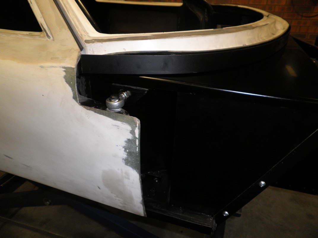

The majority of panels have been straightforward, but on arriving at the door hinge/spider/front clip area, the whole thing went pear shaped. There are only about 6 individual alloy panels involved per side, but I am convinced that in the time I have taken to get these right I could have totally panelled 2 Clubmen replicas :cry:.
Had it looking really smart last Sunday week, so decided to offer up the doors to see how the hinge adjustment worked. Really well - but I couldn't open the &$#@ doors. This weekend was spent redesigning/rebuilding the panels in question.
About to fix the spider into its final resting place. Have a misalignment of about 10mm, but I think I can live with that.
Clive

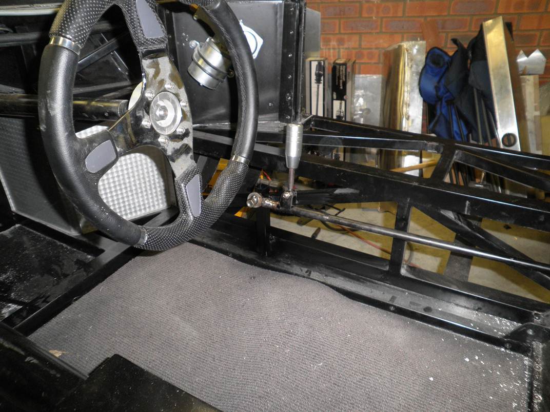

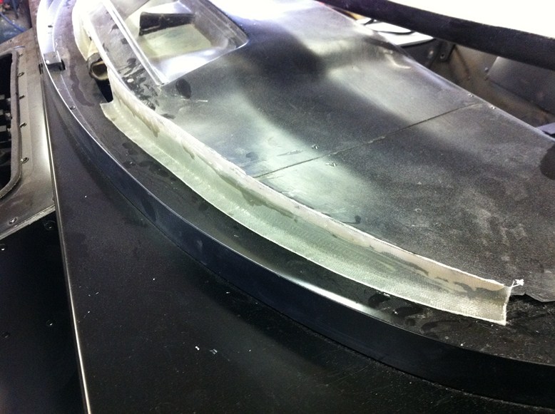

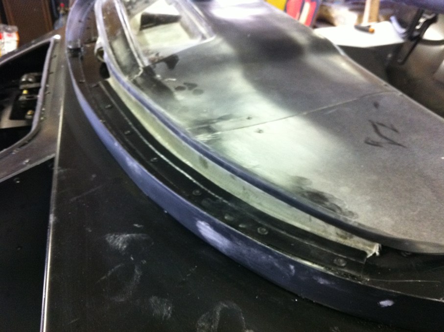

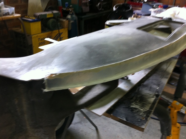

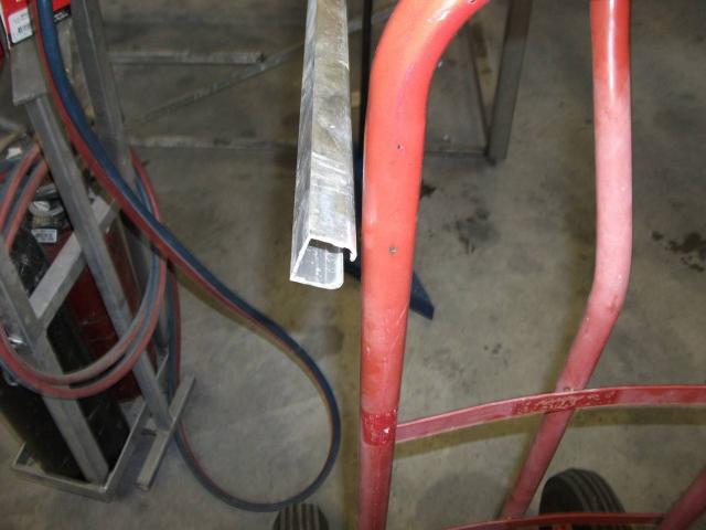

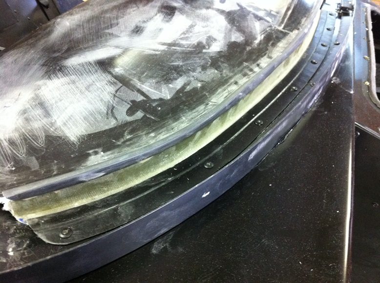

Slow progress recently, fitting the dash moulding.
Cut the outer ends of the dash so I can slide the dash in and out without snaring on the roll cage. The offcut bits were not at all pleasant, so I remade them in alloy. This allowed me to use 'H' section joiners, covering the joints.
I had to come up with a method of supporting the leading edge of the dash mould to prevent movement. The attached piccies show the glass "L" sections I made, which were glassed to the leading edge of the dash moulding. Then made up alloy (Z?) retaining sections which the lower edge of the "L" engages. Slips in and out easily, and as strong as.
Now able to bolt the spider into place, and will be able to adjust the rest of the body panels. A major forward step.
Clive

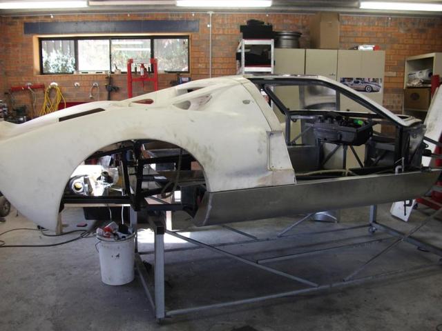

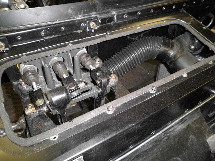

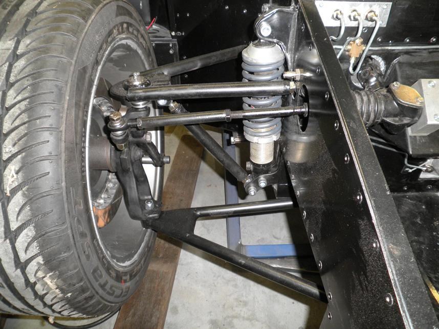

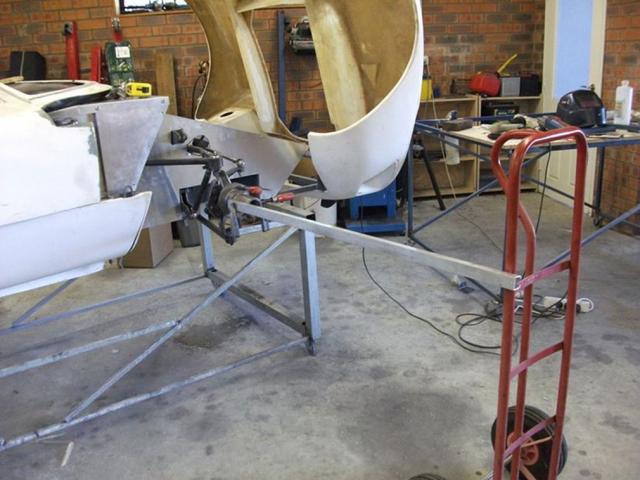

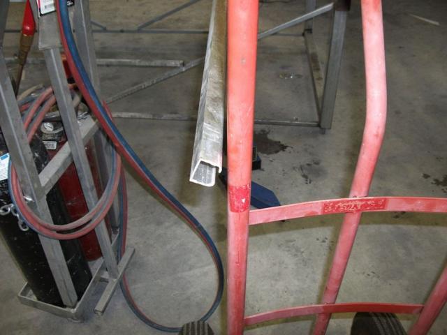

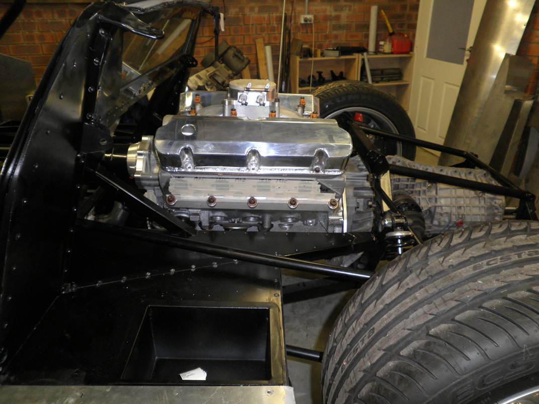

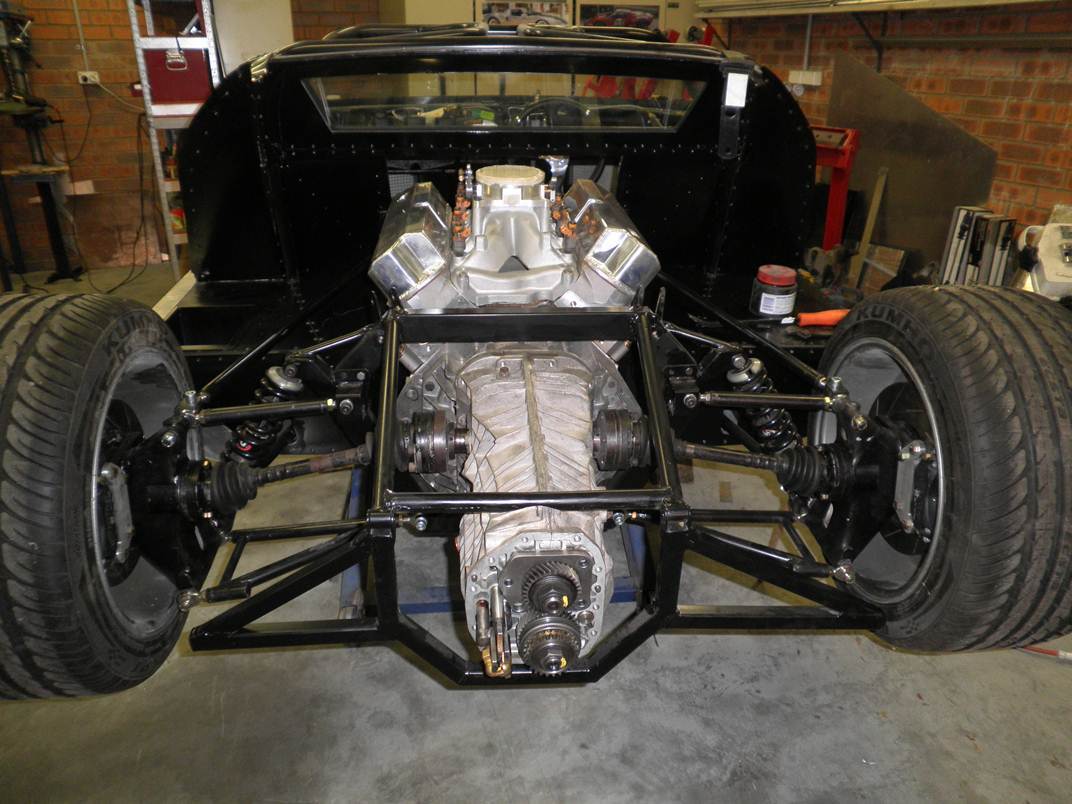

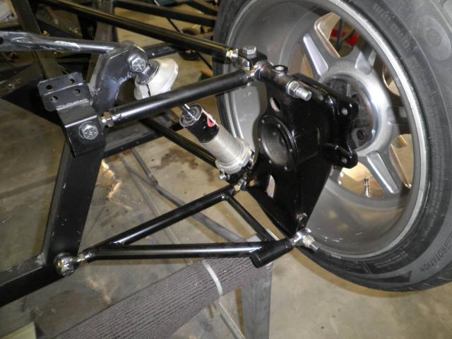

Slow progress. A bloke has to be mad to build one of these from scratch.
The suspension is all now in place and happiness. Working on the myriad other systems to make this thing fly. Working on plumbing, gear change, cockpit heating/cooling.
Have sort of set an October (this year) deadline, to get the second son to his wedding on time. Expect to have the mechanicals/technicals pretty good, but the body getting a quick straighten out and a jam job.
Time will tell.

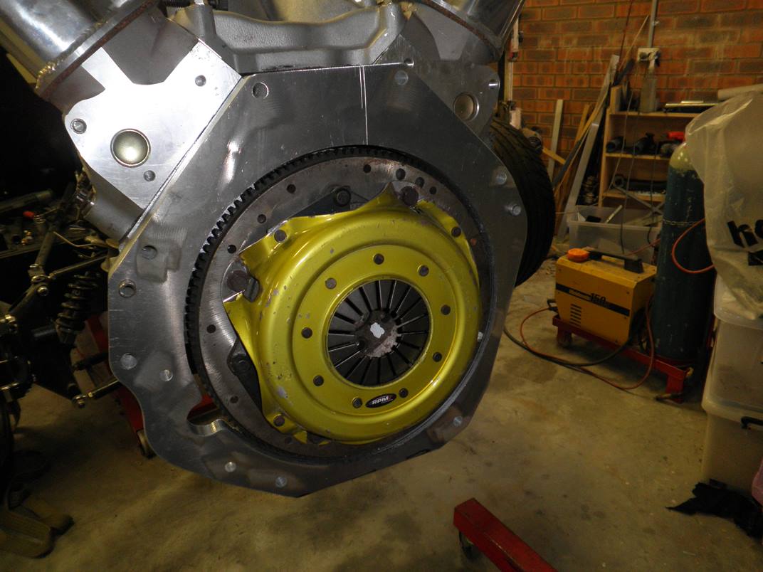

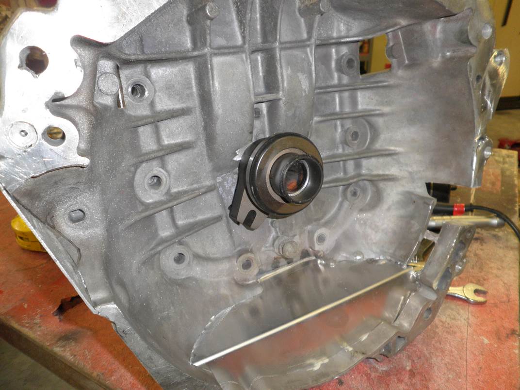

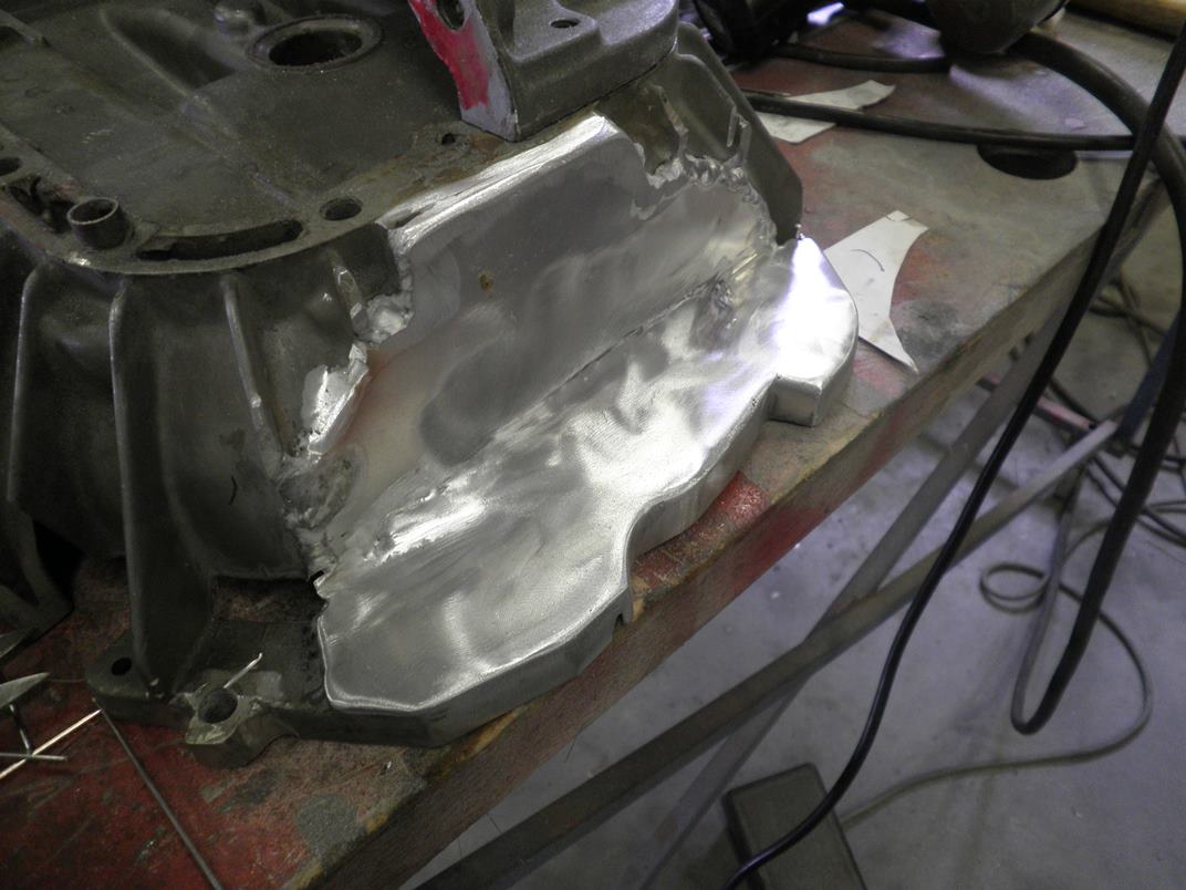

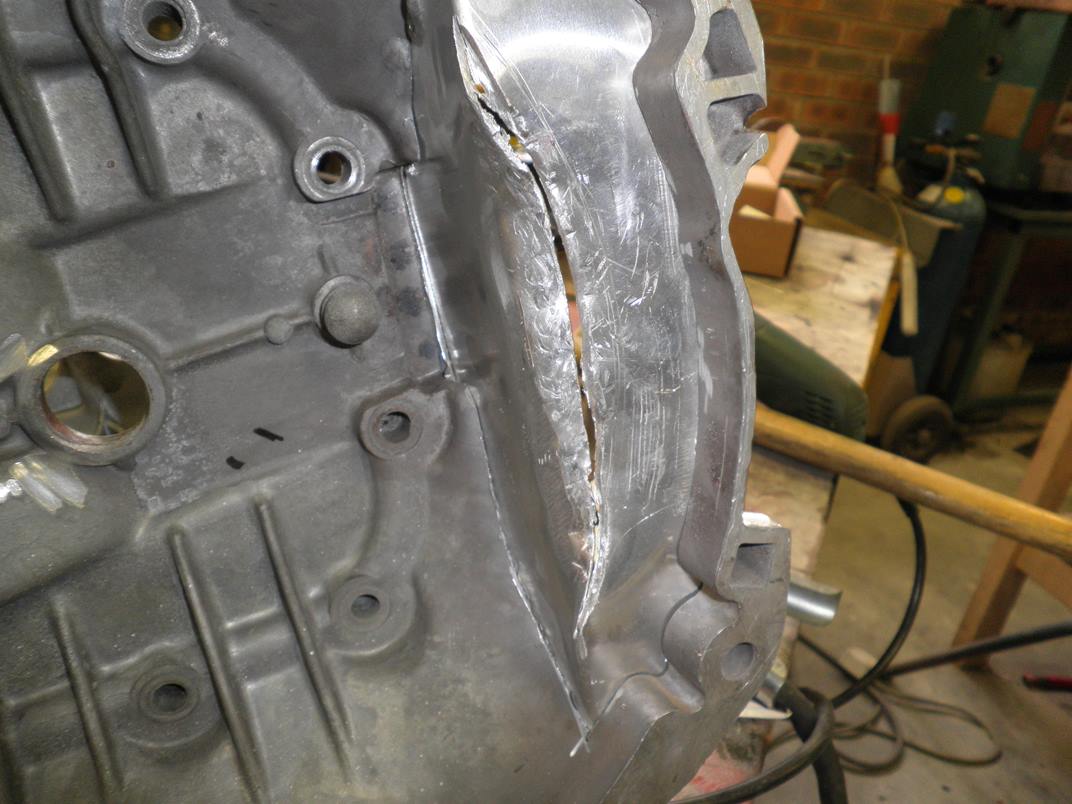

It has been a while since updating, but the economic climate in Canberra has been under a cloud for the last couple of years, courtesy of a politician promising to decimate the local workforce. It has made progress slow, as the dollars have been hard to find.

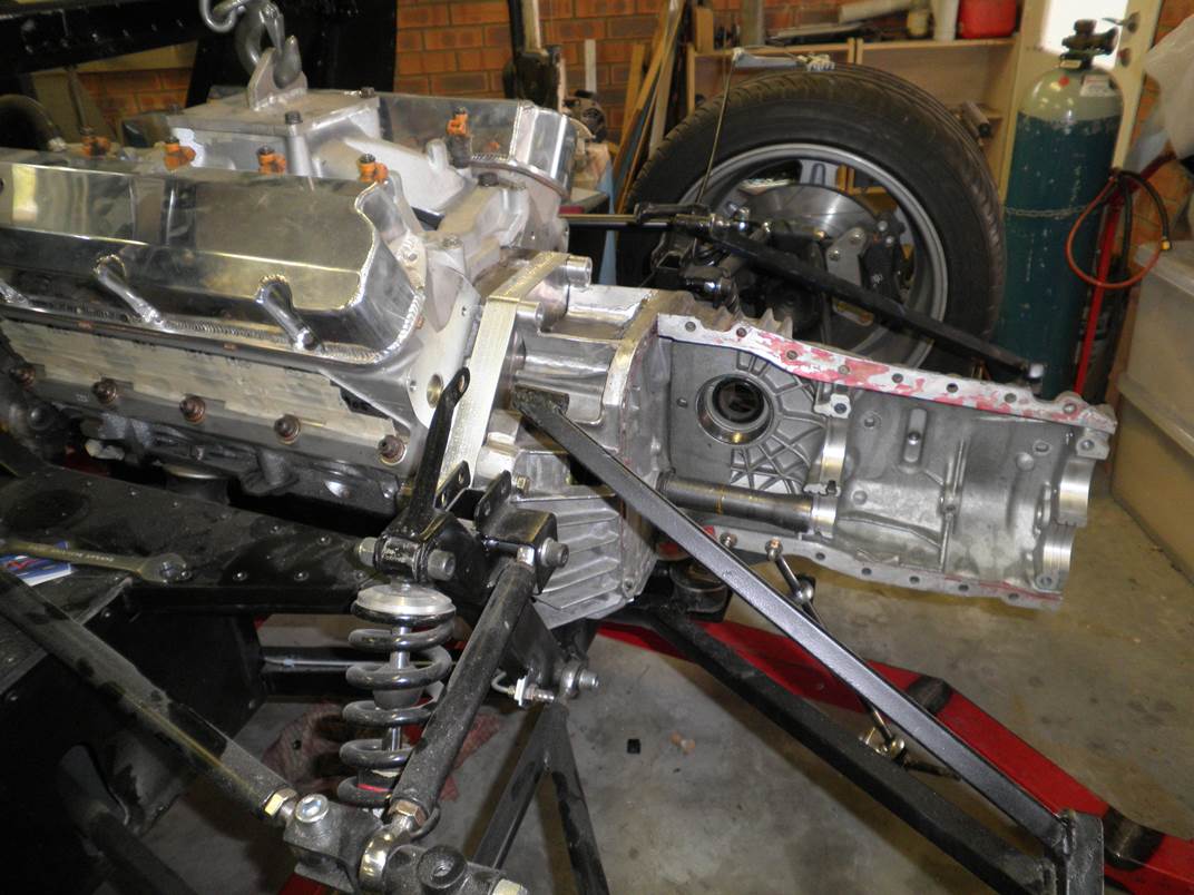

However, I had been attempting to source a one-piece input shaft for the UN1 tranny. Long story short, a conversation with a race car engineer has convinced me that I need not worry about the small diameters on the original. Apparently Hewlands run even smaller shafts with comparable horsepower/torque inputs. It's to do with gearbox multiplication factors apparently.
I was still left with the problem of lack of room in the bellhousing for a clutch throwout bearing. Decided that a 32mm spacer plate would give me room for a small concentric bearing, so machined up the required spacer. Nothing ever being easy, this required a relocated gearbox/chassis mount, and many indignities to be performed on the bellhousing to get it to fit in the chassis and also let the engine turn.
I now need to accurately measure the length required for the front input shaft, and have a lengthened splined sleeve made up to replace the original, and Bob's your uncle.
A couple of piccies.

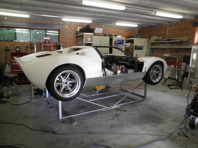

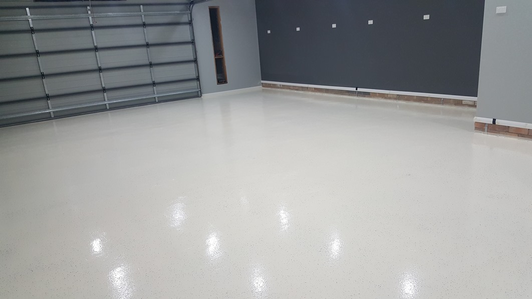

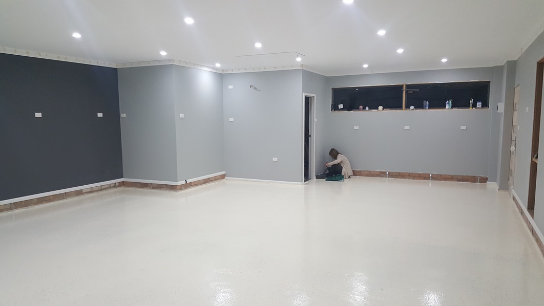

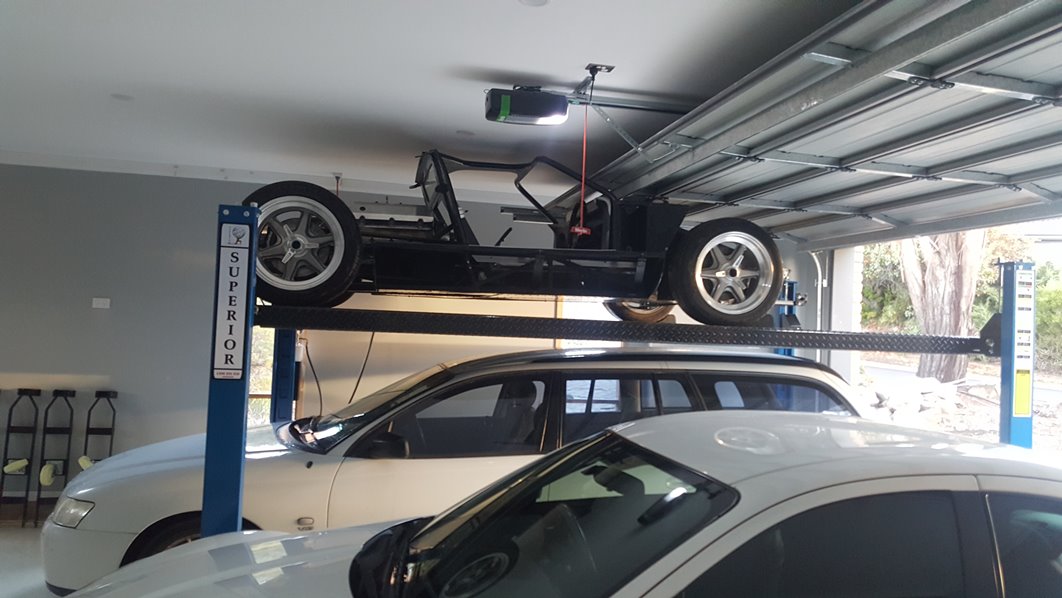

Been a long time between drinks. 4 years since moving house. Now built a decent garage/workshop to continue progress. Getting older, so hope to get to finish/drive the toy.
Sometimes life just gets in the way Clive...
I make notes of where I am and left off on my projects now - they help get me back on track again...
Hang in there!
This rather flash garage/workshop will be home to a very scaled down version of my sign business, but also the large number of machines one needs to build a scratchbuild.
Soooo looking forward to the next month or so.
