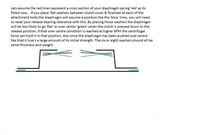

Its worth trying this, even though your combination may not be what you need.
I have a couple of similar engines in normal front engine, rear drive that have single plate clutch, but your ~50/50 weight and sticky tires probably push the envelope.
