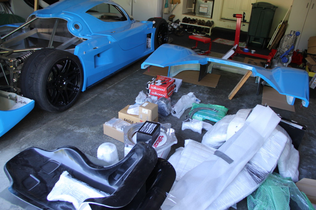

Well I have finally started assembly after taking everything apart and hanging all the body bits from the ceiling in the garage.
Thought I'd start with something easy - figure out where the brake line residual pressure valves and brake switch go in the new configuration with everything outside the foot-wells.
The bits that came with the kit don't seem to fit together; I have the bits in photo 1.
Can't seem to make these work with the brake lines as they were installed at the factory (photo 2). There is a black 1/2" fitting on the end of the rear brake line.
1. Where should the residual valve for the front brake line go?
2. How can you attach the brake switch and residual valve for the rear brake line with the 3/8" and 1/2" ?? black fittings as they have been provided?
Thanks in advance.
