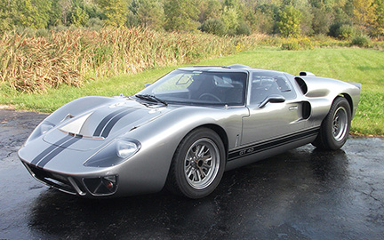

Rick, what happened to your Avatar? No more Gt40??
Gus,
The GT40 is still with me. That has been my avatar for a long time. P2171 is still hanging around but I do have a potential buyer coming to inspect it soon.
