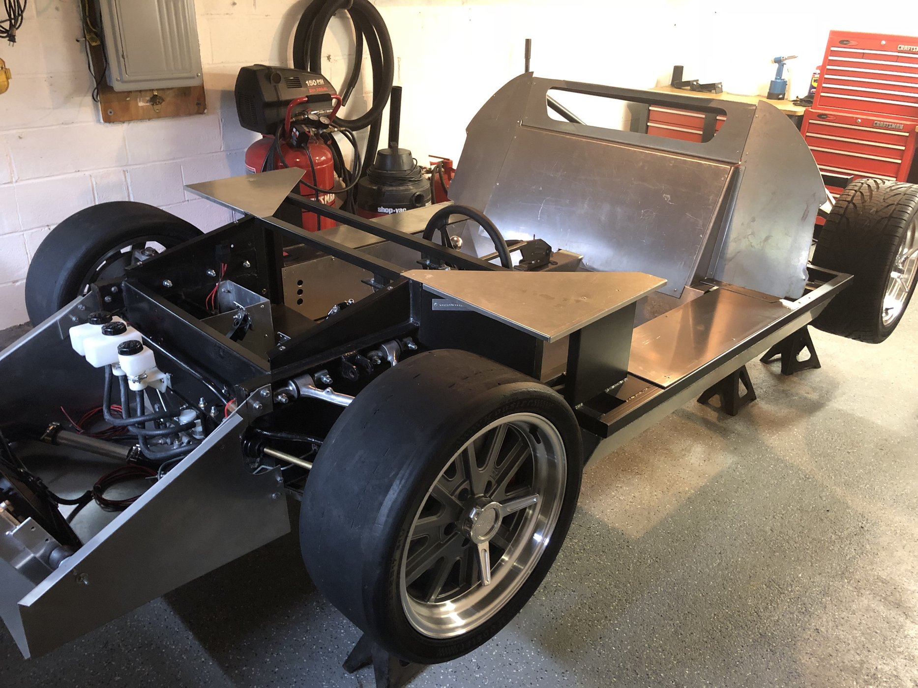

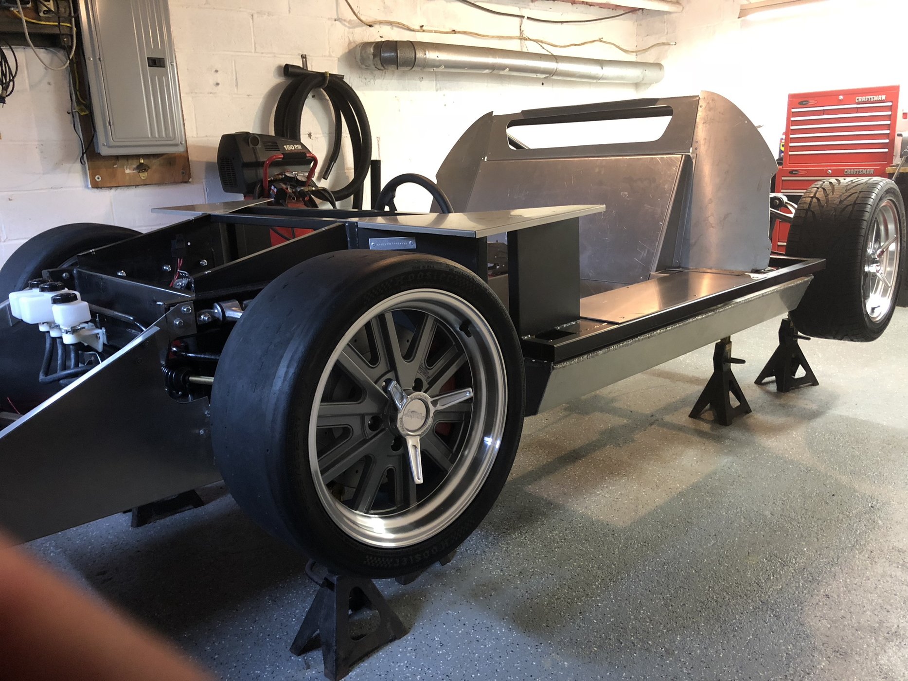

Well I decided what I’m doing. I went and bought a Gen II Coyote. 435hp out of the box.
I also got lucky and picked up a set of headers (bundle of snakes) all being delivered this week.
I’m actually further along in my build than I thought I’d be only 8 months in. Chassis is done, suspension is done, shifter and brakes all done.

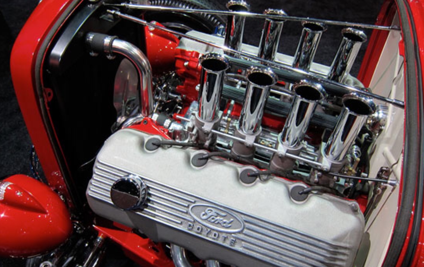

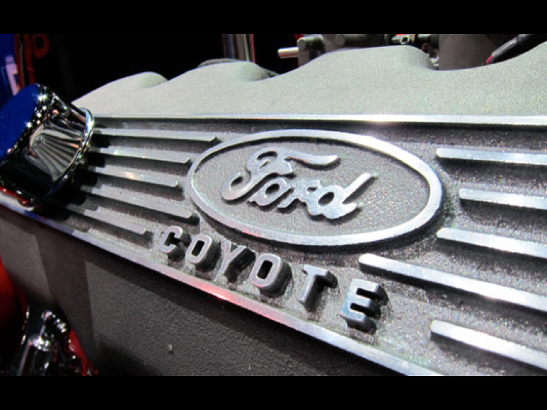

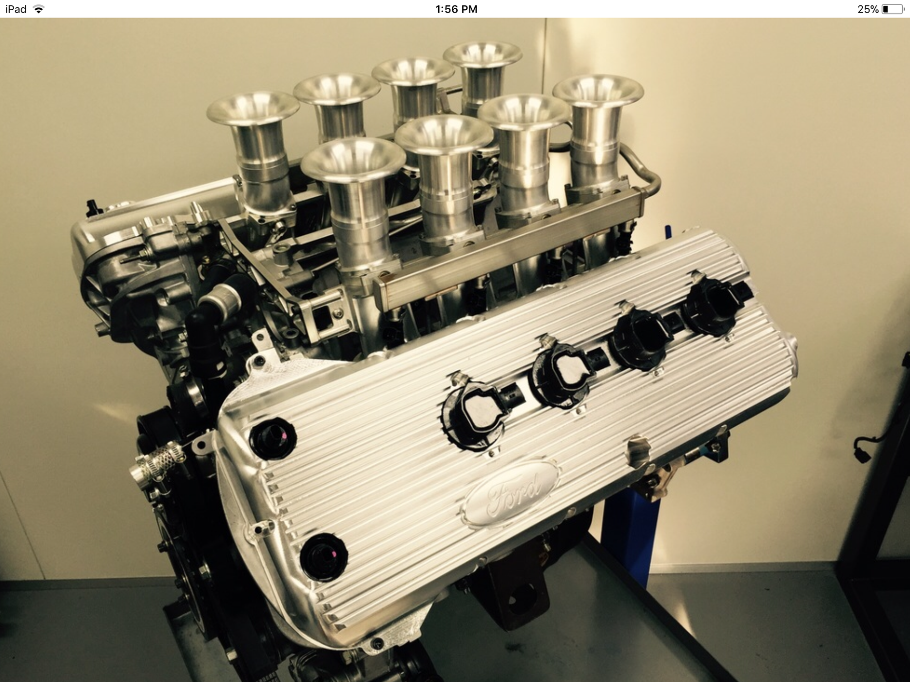

The engine will have an 8 stack intake and I actually saw some old school style valve covers (below although I don’t know where to get them) that would make the engine look like a big block Ford.
As said earlier in this thread, I doubt anyone would be able to tell unless you’re a geek like me.
My car will have a modern suspension, modern drivetrain, an original look and original looking interior. The only thing that may give someone a clue may be the 17” wheels and possibly some modern technology on the dash, but outside of that, this will look very much like it came from 1966.

PS: I know the tires are different, I’m getting Hoosier rears soon.
