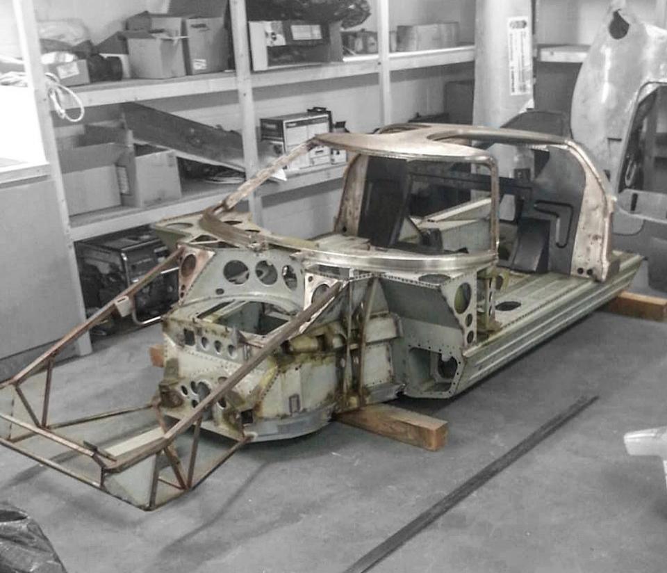

OK guys, so this does look to be the chassis of my car. It has a lot of correct gt40 detailing. Can anyone tell what year of mono it is meant to resemble? This should test a few of you.
Sim.
The photos in #28 also show that the "A" pillars are further out than the ones in photos in post #40.
is the Druriy chassis comment supposeds to be the "Terry Drury" chassis?
you can see the square box section at the front of the seat through the opening in spare wheel well.

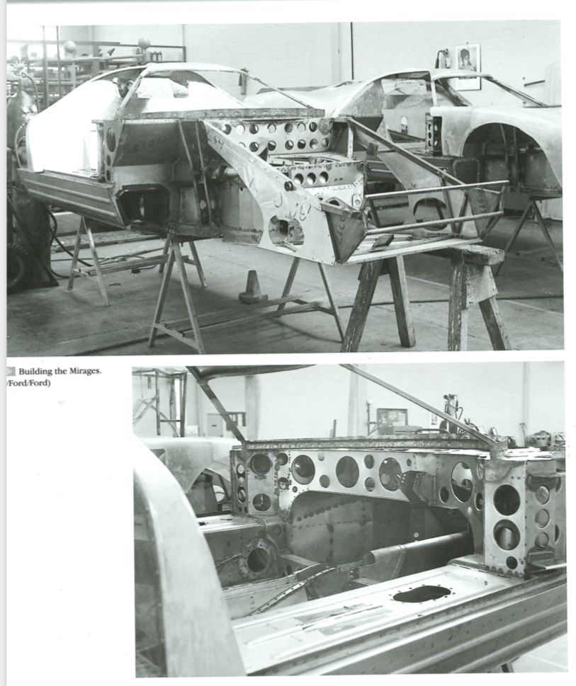

Ryan, post 28 is the same chassis as pictured above Terry Drury Tribute.
As Graham pointed out, post 40 is a Mirage chassis and the pillars are inset to make the car have smaller front area roof, they look much differents from the front.
