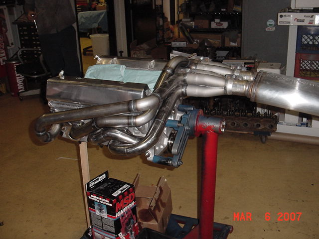

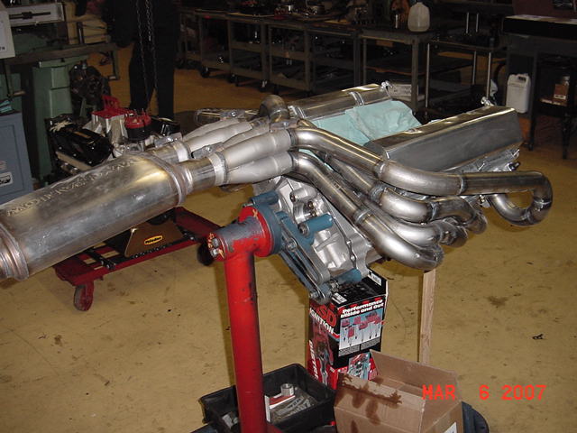

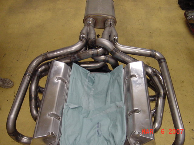

I wanted to give you a quick look at the engine. We are still waiting on the Weber intake for the 8.7 deck height Yates head motor. Check out those Headers!rockonsmile The rear suspension actually runs through the exhaust. The tubes are 1 7/8 to handle the high flow engine. I am not going to coat them. I am just going to spray them with WD40 and let them yellow out naturally.

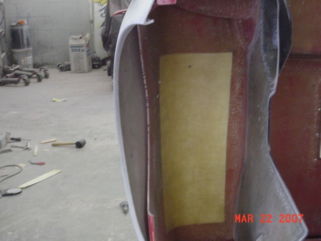

Dean - I like the idea behind the 2" flares and think they'll look great on your car.
That said - I have always ground / sanded away the Gel-coat when adding fiberglass.. Not sure how good the bond will be here.
Maybe Bill H or Fran or someone else more knowledgable than I will chime in.
Chris Kouba
Re: Dean's new RCR build thread
I've heard the same thing- grind through the gelcoat before glassing or glass to the backside of the part.
I am a real rookie though- others will hopefully confirm.

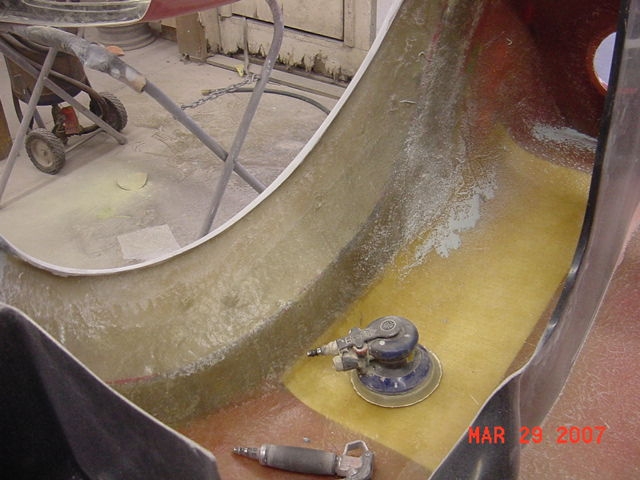

I made sure they ground through the gel coat on the otherside. They did scuff that side pretty well. I am not to concerned. It will all be glassed from the back after all the extra material is ground out from the under side. I have some more pictures but I haven't down loaded them yet.

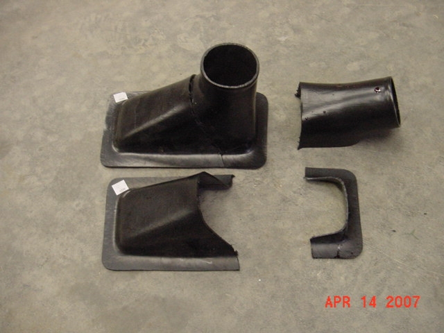

Dean, You don't have to grind through the gelcoat, but it's better to. If you leave the gel, rough it up with #36 grit dry and all you need is a 4" wide strip of mat on the outside with as wide as you want on the underside. It's best to tear the mat than cut it. I should have the ducts done this week for you.

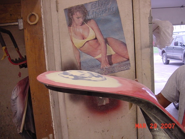

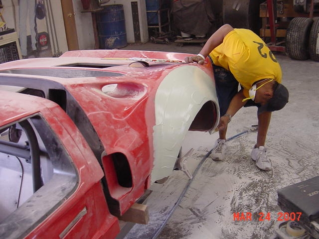

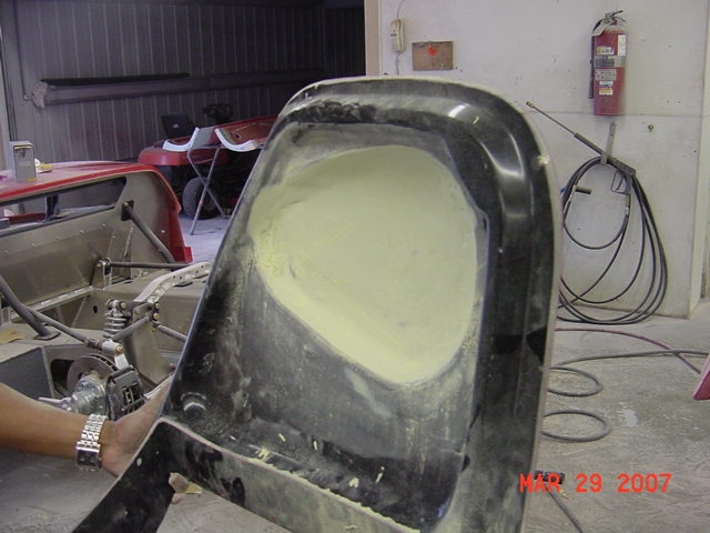

Pete you are right, I have a lot so share. The body shop has been busy but hey work slow. I am always amazed at how much longer it takes to get from 90% to 100%. They have finished up the flares. They turned out great. The 2 inch wider hips are really cool. I actually thought I had better pictures but here it is....
The under side looks like it was built this way after the extra material was removed.

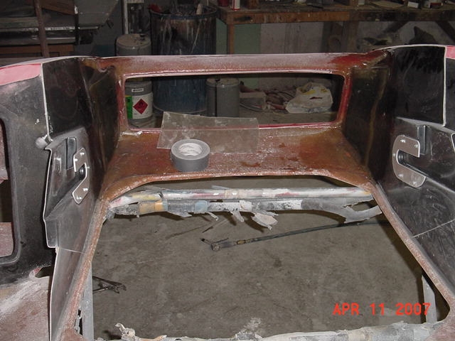

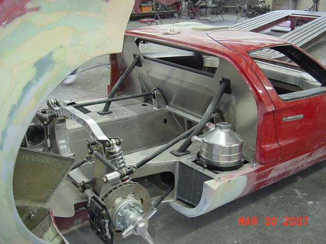

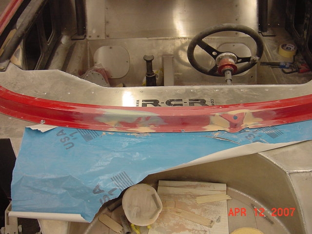

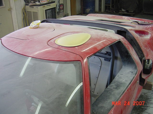

They have also been hard at work on the gurney bubble. I was going to just pop rivot the thing on but I didn't like the look so we ended up glassing it in. I really like the smooth lines.
Here is a look at how my oil tank will fit. I thought i would just through that in!

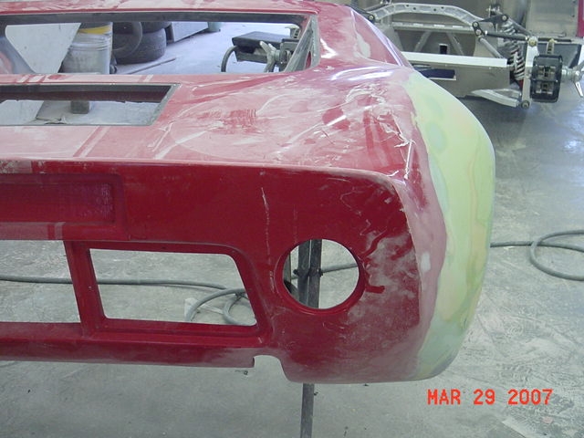

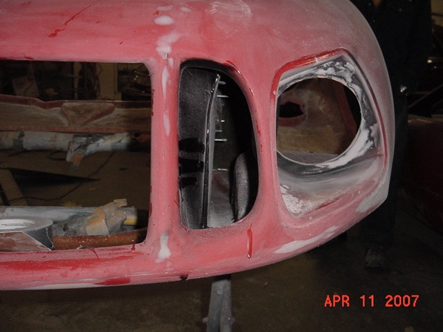

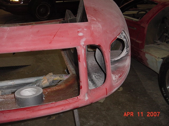

I didn't like the way the front brake duct holes looked when i bent down and looked inside. The fiberglass panel inside seemed to "split" the brake duct hole. I thought it would look beeter if it was over to one side and defininately work better if it was sealed so we did that too.
These were the after shots.
Now it will better funnel the air to the brake vent tubing.

Looking like great progress Dean.. I guess I never noticed the panel that "split" the brake cooler duct in the front before. I'll have to consider a similar mod..

Dean, I can see by the pics, that the original brake ducts that I make you asked about, probably won't fit in the nose. The inner panel splitting the duct opening in the nose will not allow the duct to fit up to the opening.

Looking great Dean! Is the Gurney bubble for appearance sake or necessary when you are wearing a helmet?

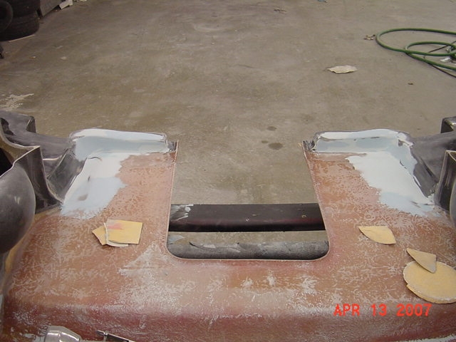

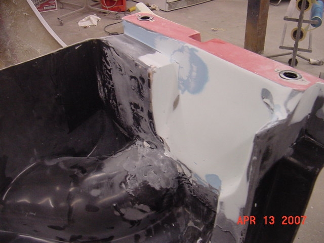

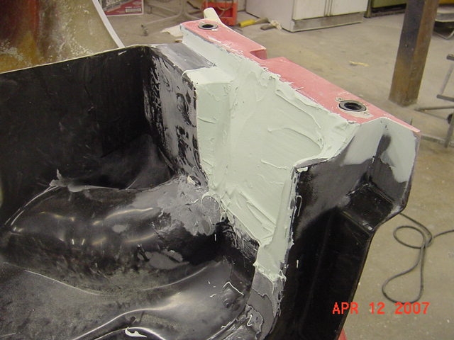

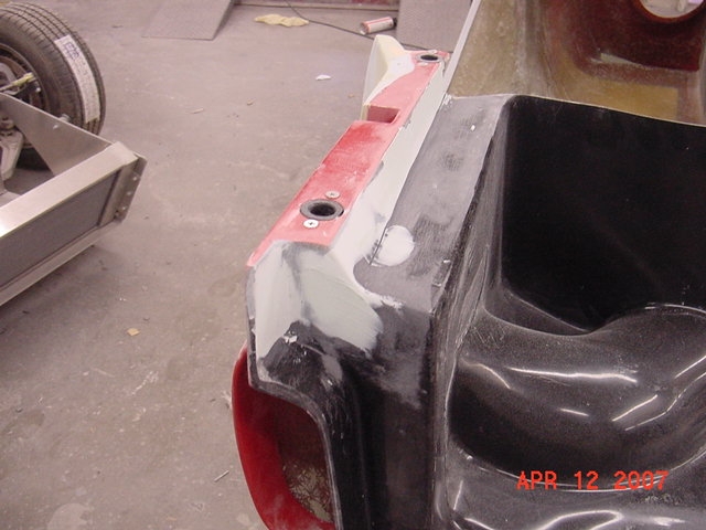

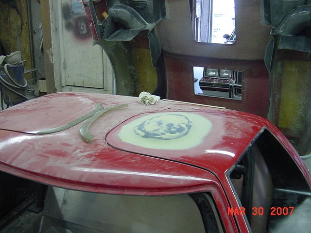

We finished filling all those odd little openings in the rear bonnet, some of which I created!:rolleyes: There where a couple of holes where the panels where joined and one I created to clear the oil tank. We finished changing over the wiper to the left side too.
Part of the car was in primer when I left the shop today!:pepper:
Doug S.

I actually had plenty of room with out the bubble but I like the way it looks.
Me, too!! For me, it's a big part of "...the look".

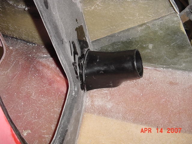

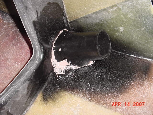

I really liked Bill's idea for fresh air in the car when the AC is off so I found some old ducts I had on the shelf and cut them up to fit the NACA ducts on the hood. I can then fasten the 3 inch hose to them and incoorperate the hose into the AC system. The palstic duct was glued to the fiberglass with some kind of epoxy. The body shop seemed to know how to do it so it would be solid. i haven't seen the finish product yet.

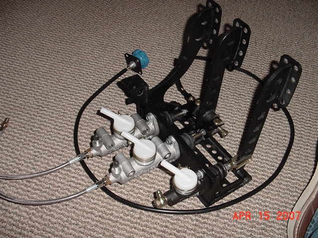

I completed the pedal assembly assembly this morning and it looks pretty good. I used the 3/4 Tilton 75 series for my clutch, 1in Wilwood for the rears and 7/8 Wilwood for the front. I was not sure about the front and rear master sizes so I called Al Nichols at Wilwood who works with Fran and he suggested this set up. We will see how it works. I added the balance bar adjustment to tha pedals too.
