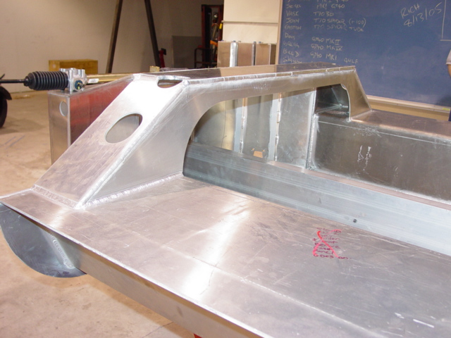

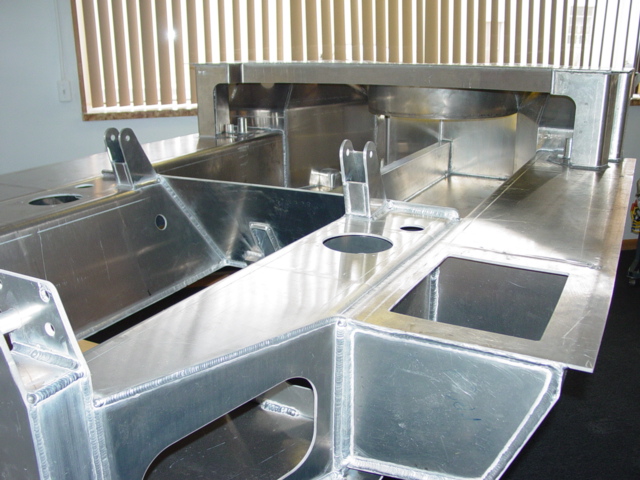

Also I agree with numerous posts that monocoque is the way to go (if more complicated to design and manufacture) because loads are distributed much more efficiently. There where problems with feeding concentrated loads but techniques to deal with it are well developed. There was also problems with skins "oilcanning" and even buckling under load but after people realized that if a core (ally honeycomb gives best weight/stiffness ratio) is placed between to skins it helps enormously by stabilizing them - stiffness increases dramatically with very little weight penalty.
Also reason to use fancy materials like carbon fiber is clear - stiffness of woven HS carbon is close to that of Ally - 70000 Mpa. Density is much lower. Ultimate strength (of most importance in terms of safety) is higher than that of steel Av. yield strength of carbon steel is roughly 280 - 350Mpa and Epoxy woven carbon is 700 - 800! And when UD (unidirectional) carbon was introduced it opened an all new world of tools - stiffness was up to 130 - 140Gpa, and typical yield is about 2000/1300 (tension/compression). And than there's intermedium modulus carbon, high modulus and ultra high modulus with stiffness up to 600Gpa! (steel is about 200Gpa) How ever use of those high specialized materials is not as straight forward because strength goes down at about same rate stiffness goes up.
How ever an ally faced/ally honeycomb core monocoque chassis still could be made extremely stiff (and much cheaper) - only major drawback is one would struggle to pass current safety/impact regulations because of low yield strength of ally (150 - 250Mpa)
