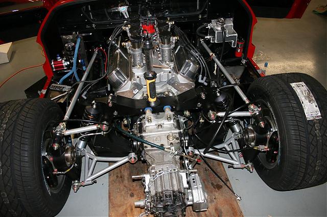

Here is a picture of it bolted to the block to align everything up. What bearing are you using for the shaft? Whats your opinion on the gearing of the M1?

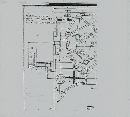

Hi Jack
The length of your input shaft depends on the depth of your bellhousing, the pilot bearing is 12mm and will probably need a carrier machining
regards
Chris.
The drawing below is dimensioned for a 4" bellhousing
According to my records, the M1 input shaft protrudes 4.54" proud of the bellhousing mounting surface. That's actually about 3/8" shorter than the Pantera DS2.
