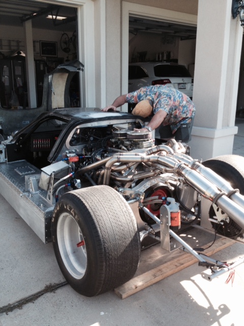

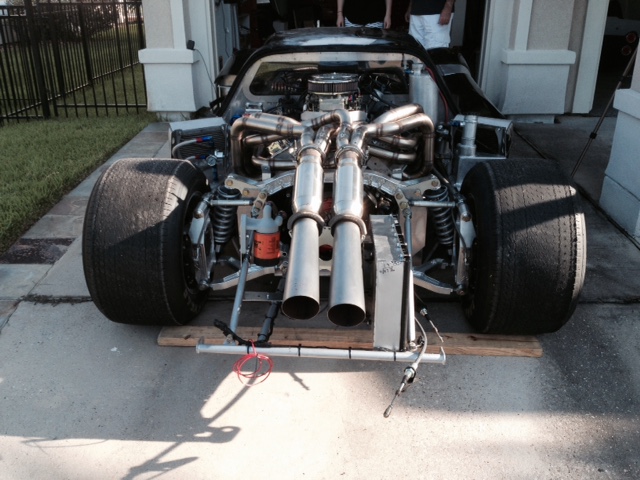

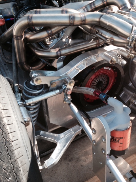

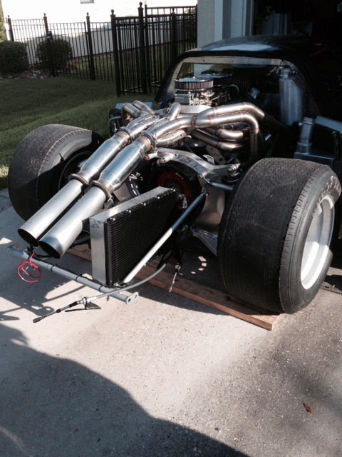

A friend took these August 1st at the engine start-up. Thought I would share.
Enjoy,

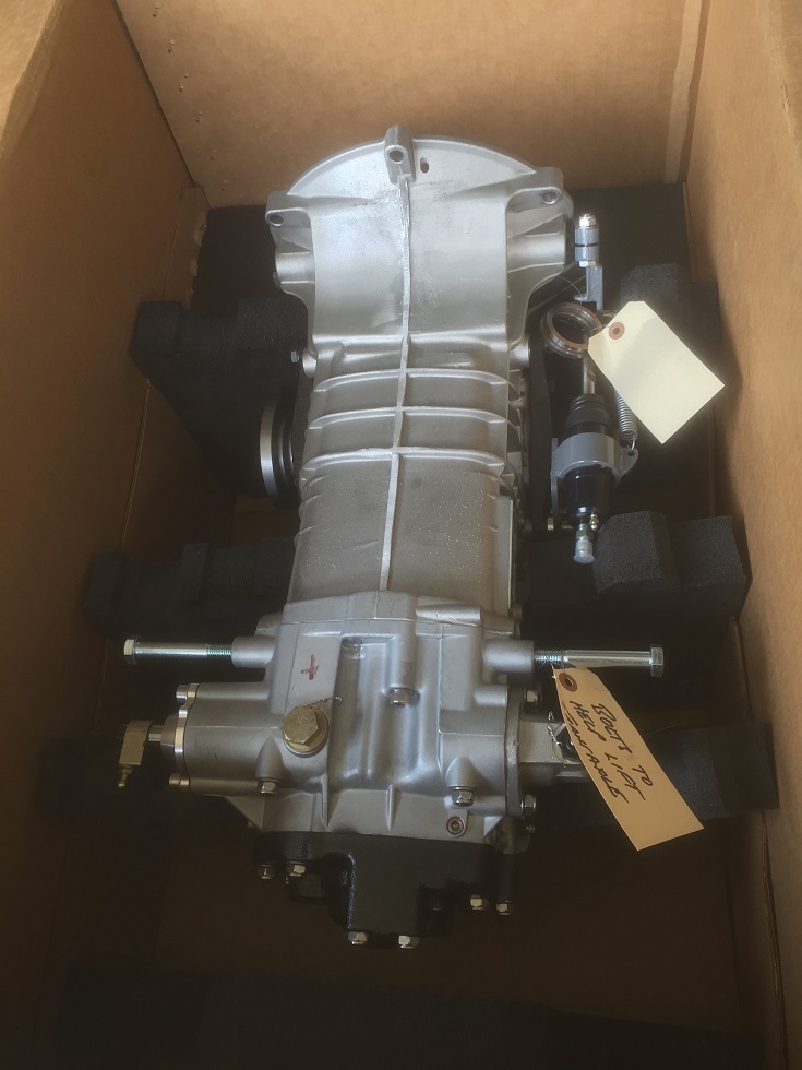

They have shipped the transaxle to me today and I received some pictures before they boxed it up.
The ZF has been fitted with Pantera Performance clutch slave cylinder linkage, new shift shaft housing machined for new shaft seal, new stainless bolts and washers. Also had the top cover plate gasket replaced, I know it’s new but I can’t believe they are still using cork gaskets, it was weeping as can be seen from some of the original photos.
I will share photos when bolted to the engine.
Enjoy,
Don
Very nice. That's the same clutch slave setup I have on my car. Nary a problem with it now since 2007.
I really should drive down the road a little ways and see your car.
Don't know that I have your address though, Don.
Kirby

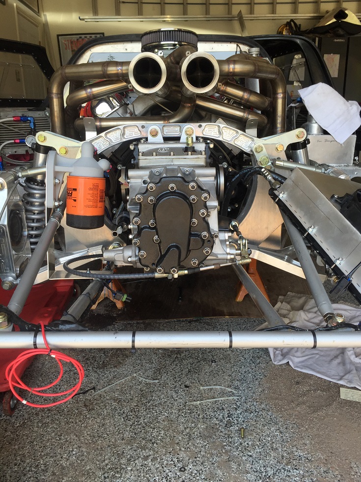

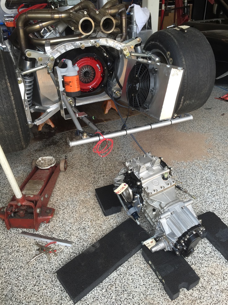

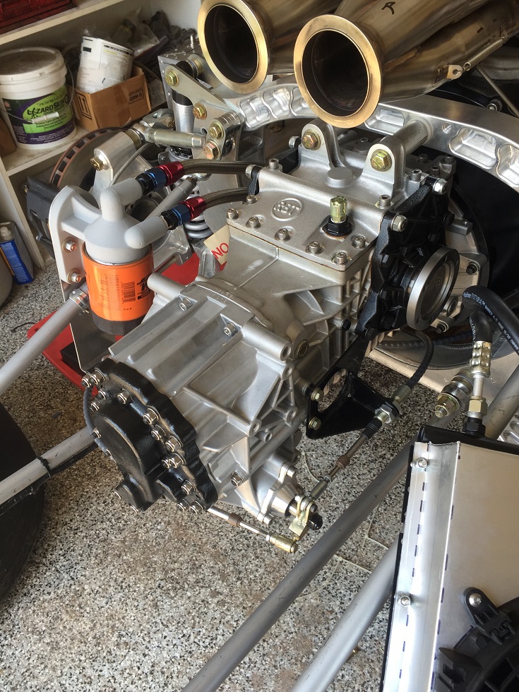

<!--[if gte mso 9]><xml> <o:OfficeDocumentSettings> <o:AllowPNG/> </o:OfficeDocumentSettings> </xml><![endif]--> Saturday I got the transmission bolted to the engine but not after some hard work. It seems when I pulled the clutch pilot tool out I pulled the pilot bearing out of the back of the crank shaft so I had to pull the bell housing and clutch to get to the pilot bearing and re-install. Note to self, bell housing and clutch cannot be removed unless the engine is out. By 2 PM transmission was in and shifter cables installed. Sunday I got oil in and headers re-installed, set the ride height, measured the drive shaft lengths and emailed Fran to get the drive shaft coming. I got the clutch stainless hose ordered and it should be here tomorrow so Tuesday I should have that installed and clutch working.
A test drive will happen when the drive shafts arrive. No I don't know how long that will be!
Major things remaining;
Install firewall cover and seats.
Cut side door louvers in.
Cut in spare tire access door in rear clam shell.
Install mirror's.
Mount marker lights.
Install drive shafts.
Drive.
Getting close! The Cobra is ready for me to pick up and I told the painter I would like to drop off the Mk IV and pick up the Cobra at the same time. He is fine with that so maybe we can trade cars in a couple weeks. David is really looking forward to painting this car.
By the way I measured the top of the spider with the car setting at ride height and it measured 38".
I know how everyone likes pictures so I attached some from Saturday.
Enjoy,
Don
