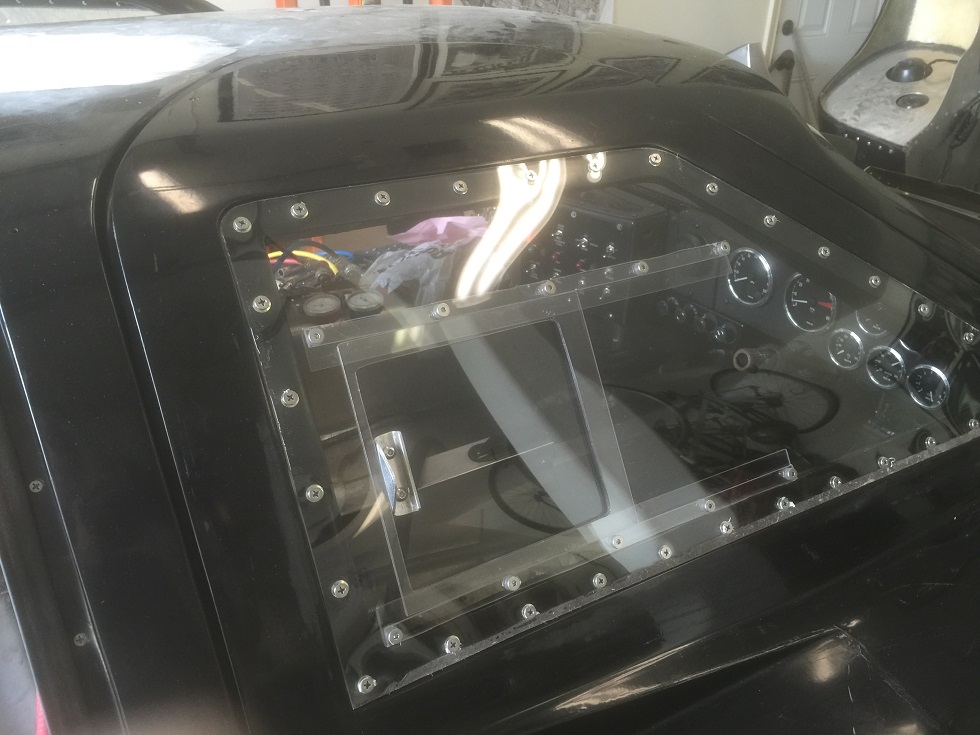

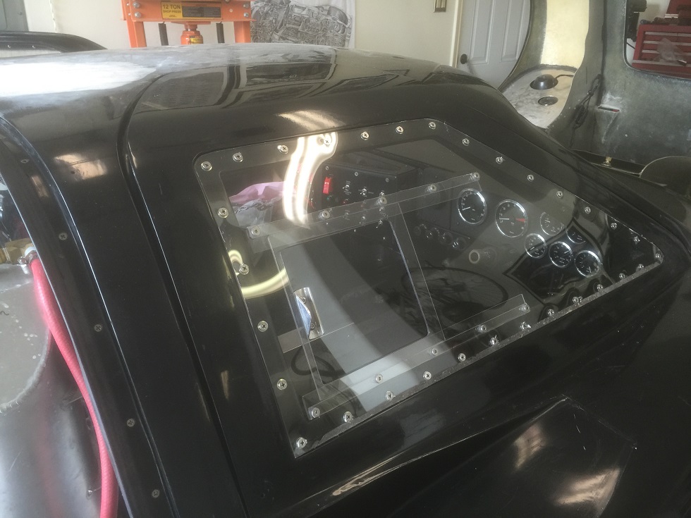

<!--[if gte mso 9]><xml> <o:OfficeDocumentSettings> <o:AllowPNG/> </o:OfficeDocumentSettings> </xml><![endif]--> After charging the AC system this weekend and feeling that cold air I decided to install the windows. I could have made the sliders out of metal but just like the look of plexi slides that I had seen in pictures. Without any real idea how I started with 1” wide by 1/8” Plexiglas strips and cut to size, 14” long. I than cut one in half making two ½” wide strips. Drilled some holes and mounted.
I like the look! I’ll have to be careful what I order at the drive thru window at my fast food place, not much room through the window but it looks cool.

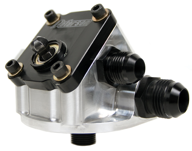

These remote filter/primer pump setups from Peterson would appear to solve the oil pressure priming issue for many applications with extended periods of non-use, have not used one myself though. Quick spin with bat drill or speed brace and good to go.
I like Maurice's idea for pump wiring, nothing worse than hearing that pump running after an incident or carb fire.

I learn something cool everyday. Had not seen the Peterson remote filter/primer pump. Gives me something new to think about.
Thanks for the info Jac Mac.

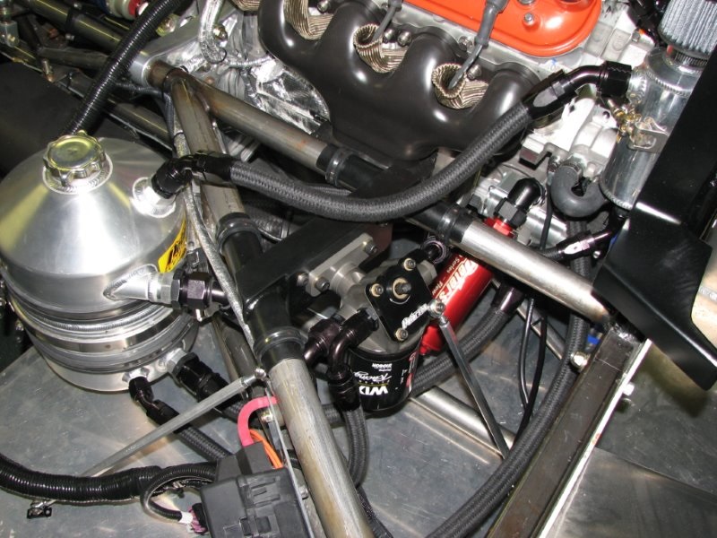

Dr. David
Great Work Don! Your build is awesome!
Here is a photo of the Peterson pump I installed on my LMP-1 car. I fabricated a bracket so as to locate it with access via a NACA duct, so the engine could be primed without removing any body panels. Filling the system was a breeze. I can see it being very functional in oil changes, as you can simply pump all the oil out,...then pump it all back in again, allowing for an easy and more complete change of the oil in the entire system. If the car sits for a while, simply get out the electric drill and circulate it through the system at 20 psi, making sure everything is pre-lubed prior to starting.

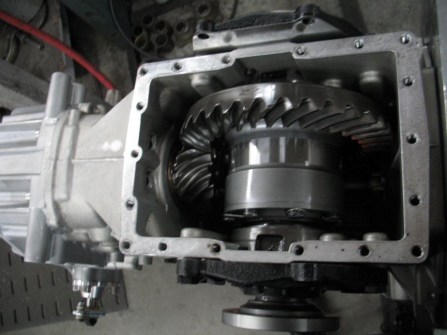

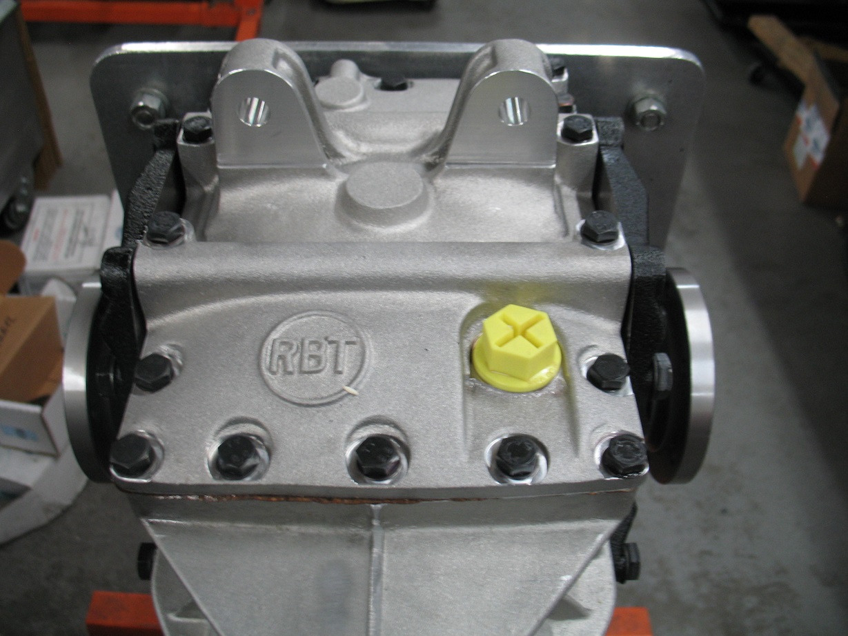

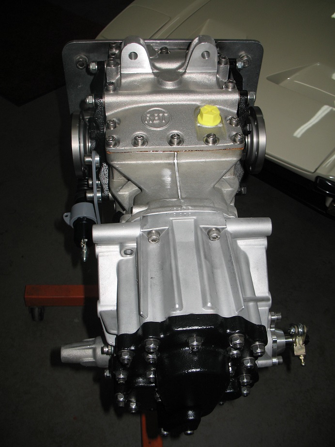

<!--[if gte mso 9]><xml> <w:WordDocument> <w:View>Normal</w:View> <w:Zoom>0</w:Zoom> <w:TrackMoves/> <w:TrackFormatting/> <w:PunctuationKerning/> <w:ValidateAgainstSchemas/> <w:SaveIfXMLInvalid>false</w:SaveIfXMLInvalid> <w:IgnoreMixedContent>false</w:IgnoreMixedContent> <w:AlwaysShowPlaceholderText>false</w:AlwaysShowPlaceholderText> <w:DoNotPromoteQF/> <w:LidThemeOther>EN-US</w:LidThemeOther> <w:LidThemeAsian>X-NONE</w:LidThemeAsian> <w:LidThemeComplexScript>X-NONE</w:LidThemeComplexScript> <w:Compatibility> <w:BreakWrappedTables/> <w:SnapToGridInCell/> <w:WrapTextWithPunct/> <w:UseAsianBreakRules/> <w:DontGrowAutofit/> <w:SplitPgBreakAndParaMark/> <w:EnableOpenTypeKerning/> <w:DontFlipMirrorIndents/> <w:OverrideTableStyleHps/> </w:Compatibility> <w:BrowserLevel>MicrosoftInternetExplorer4</w:BrowserLevel> <m:mathPr> <m:mathFont m:val="Cambria Math"/> <m:brkBin m:val="before"/> <m:brkBinSub m:val="--"/> <m:smallFrac m:val="off"/> <m:dispDef/> <m:lMargin m:val="0"/> <m:rMargin m:val="0"/> <m:defJc m:val="centerGroup"/> <m:wrapIndent m:val="1440"/> <m:intLim m:val="subSup"/> <m:naryLim m:val="undOvr"/> </m:mathPr></w:WordDocument> </xml><![endif]--> They have shipped the transaxle to me today and I received some pictures before they boxed it up.

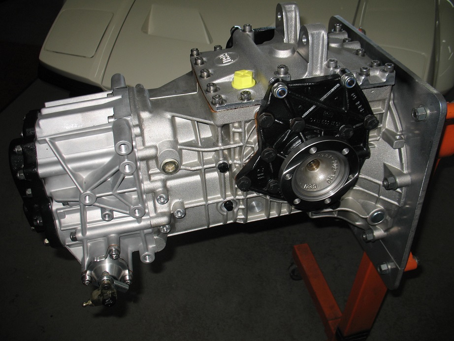

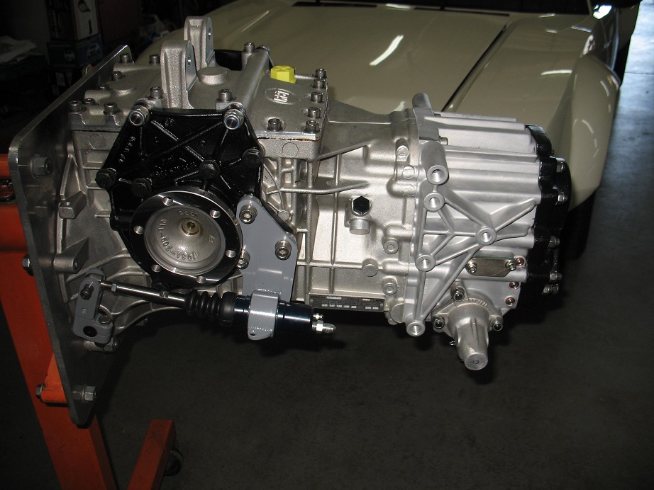

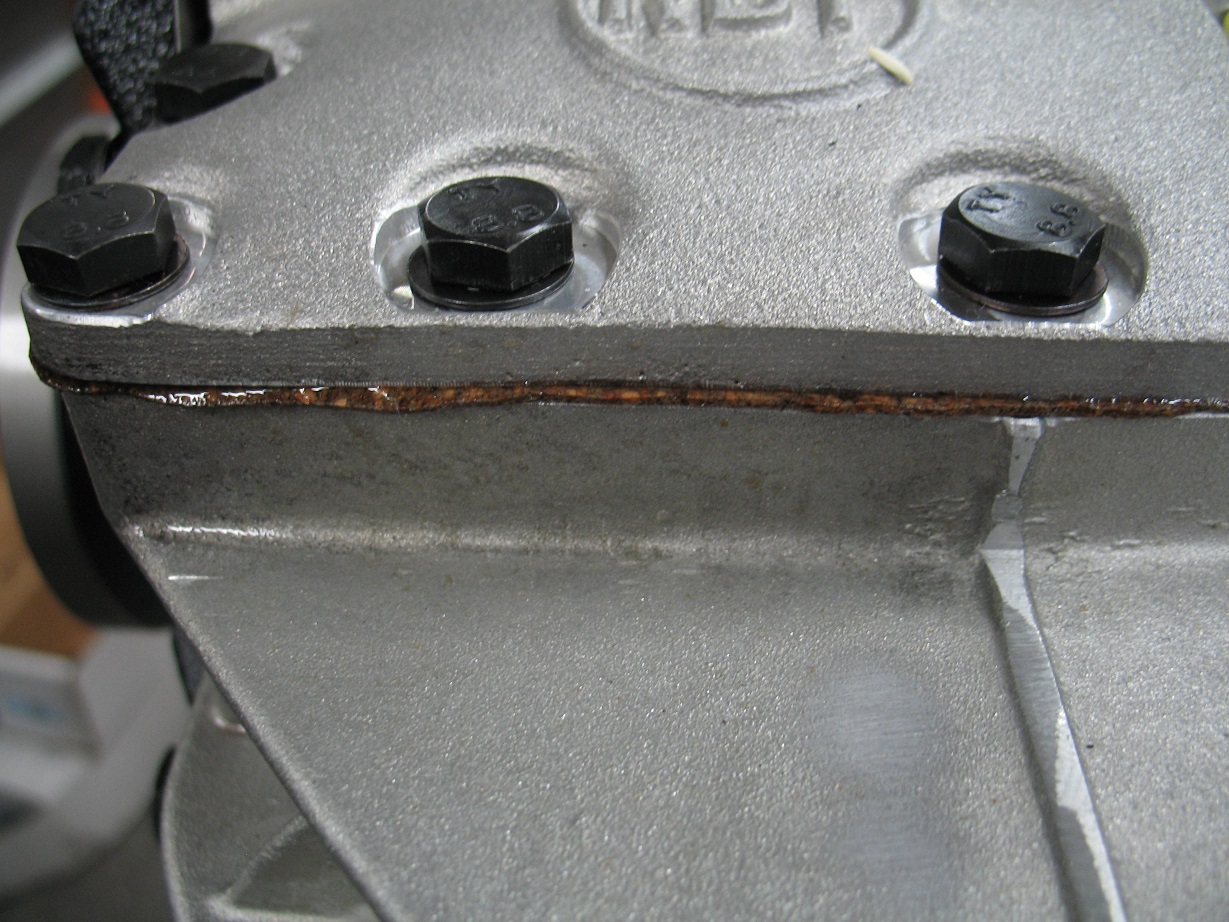

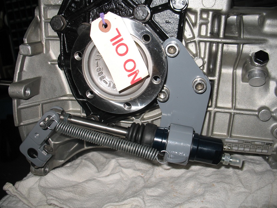

The ZF has been fitted with Pantera Performance clutch slave cylinder linkage, new shift shaft housing machined for new shaft seal, new stainless bolts and washers. Also had the top cover plate gasket replaced, I know it’s new but I can’t believe they are still using cork gaskets, it was weeping as can be seen from some of the original photos.
I will share photos when bolted to the engine.
Enjoy,
Don
