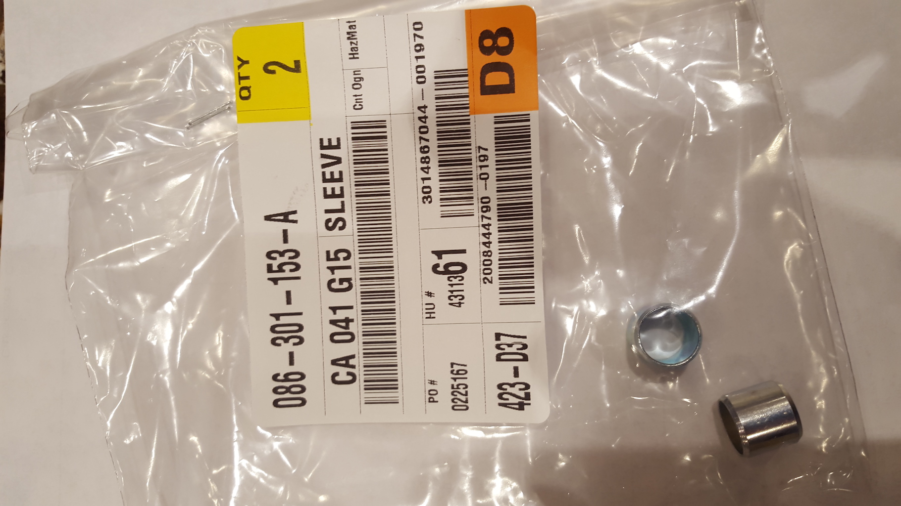

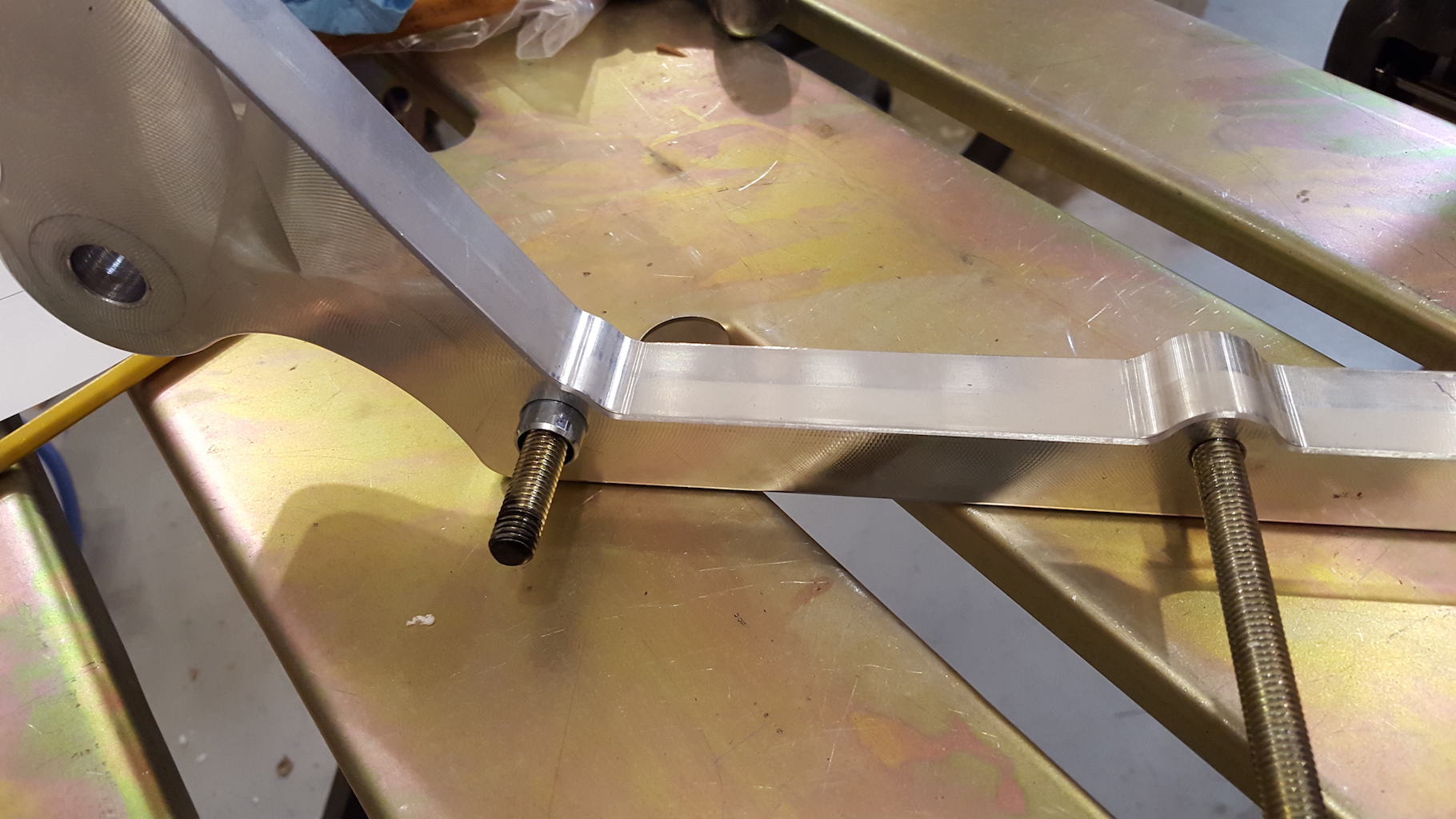

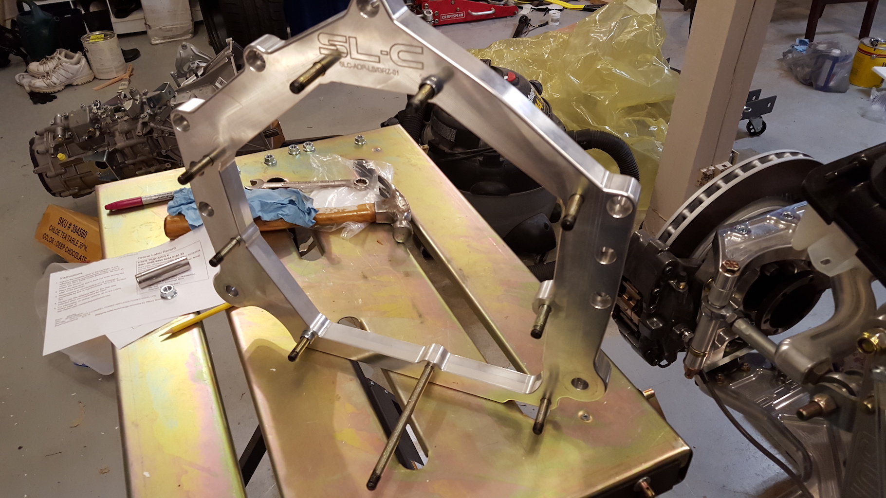

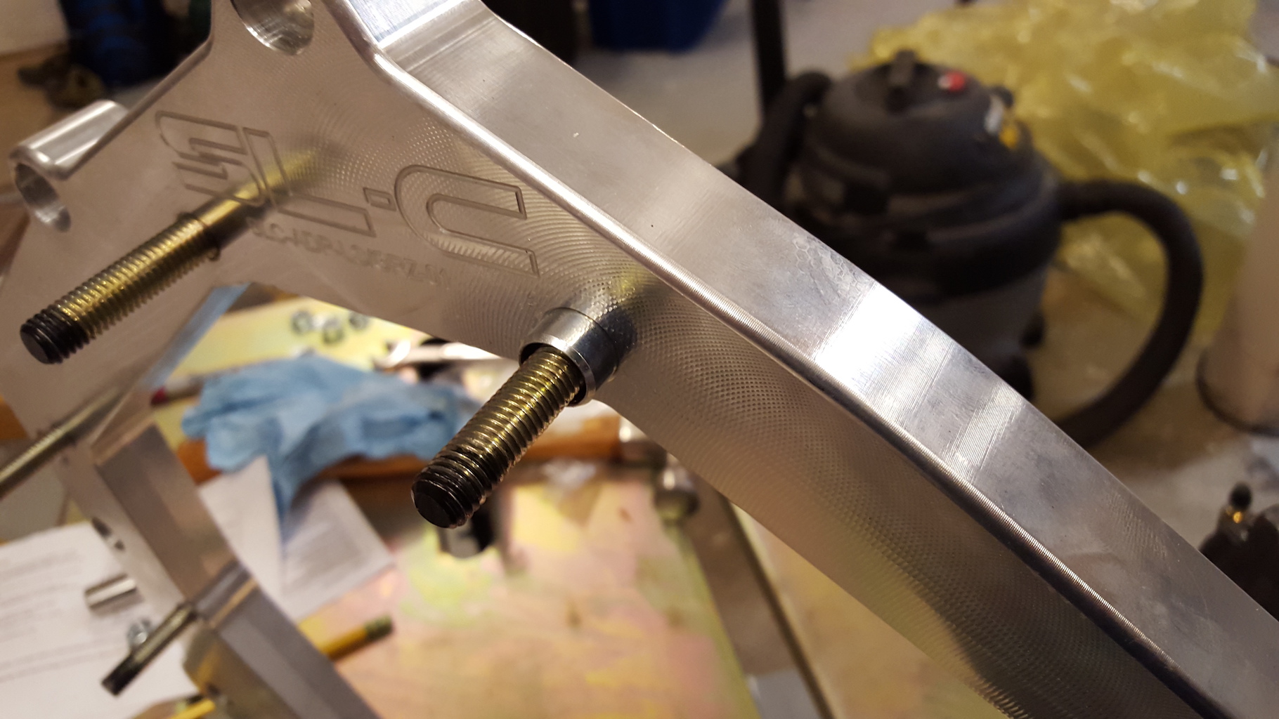

Thought I'd post this since I didn't see the info in any of the Graziano install threads.
There are two alignment dowels (aka pins, sleeves) required to properly align the Graz to the adapter plate. While you can install it without them, there's sufficient misalignment potential that you could run in to input shaft / pilot bearing wear issues.
On Fran's advice, I ordered them from Audi directly. At about $7 each they're probably the cheapest Audi parts ever made :rolleyes: .
Part number is 086-351-153-A (you need two).
They press-fit in to the adapter plate. You can also just slide them in to the trans, then use the trans bolts to tighten the plate down and press them in that way (they don't go in that tight).

Thanks for the info. One note, the part # in your text is incorrect. The part # on the bag in your 1st picture is correct .
I bought four ( for two cars) and the Audi parts guy told me that there was only 93 left in the country.
Ron
Mark B.
Thanks for catching the typo, Ron! of course, now the forum won't let me edit the post :(
Correct Part number is 086-301-153-A
