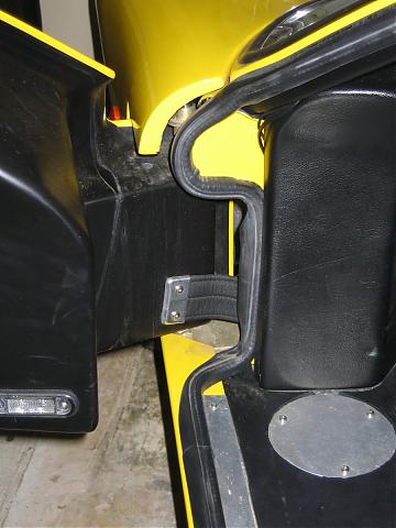

Is this the area that you are talking about.
I got mine a bit better than the photo. It seals ok but I am still not happy with it. When it is on the road and have a bit more time I will revisit this area and come up with a better solution then. There must be a better way.

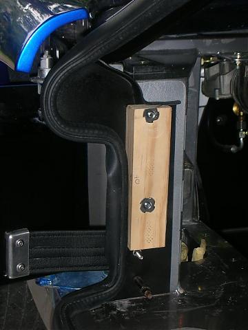

Another picture. The yellow piece, bolted under the leg of the dash, is a bit of fibreglass with a right-angle edge. The rubber seal fits on the edge.
