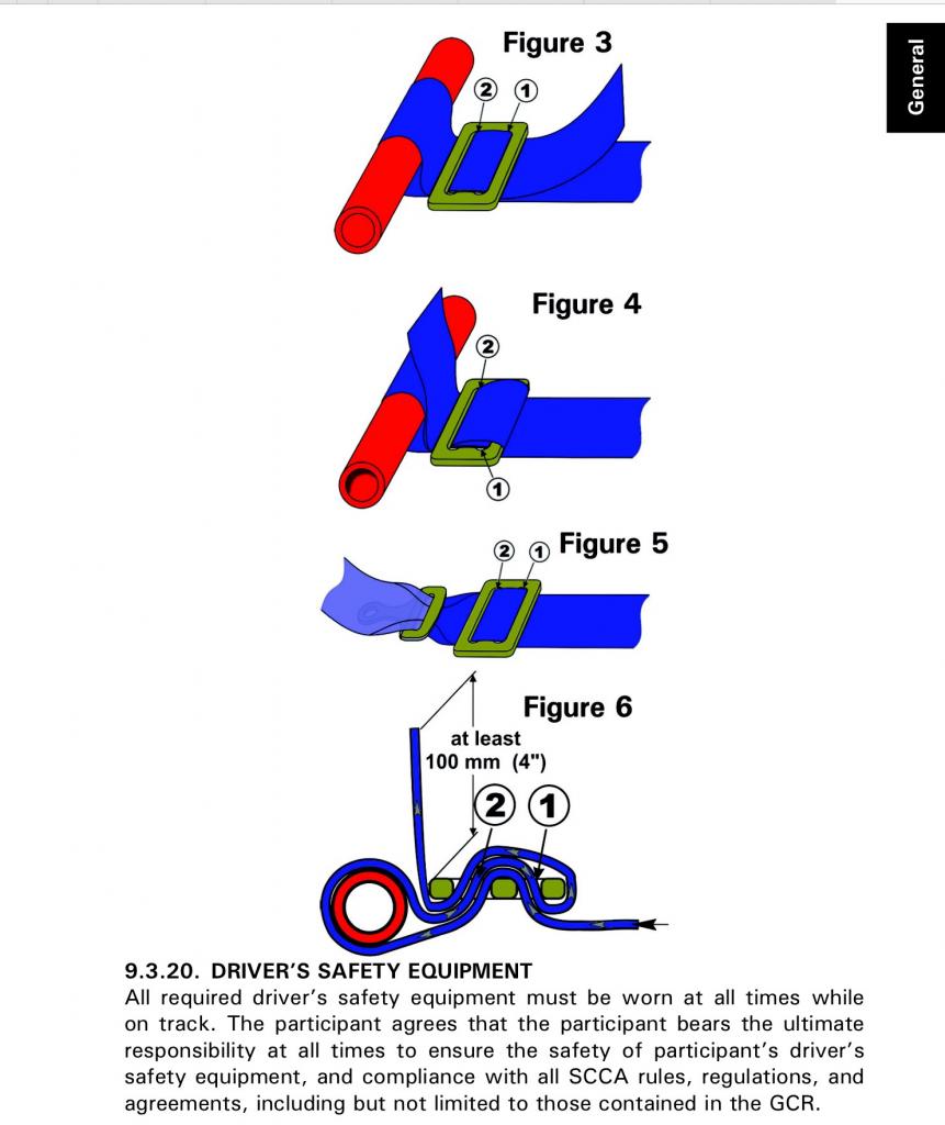

I used to be an SCCA Tech Inspector and I have to say that I would have failed any car's restraints that were anchored in the manner you are proposing. The metal bars provide a concentrated stress point and could easily cause the harness to tear.
Instead, take a look at a round bar or at the very least a SFI Certified single point mount.
If you go to page 92 in the link here, you will see a few different suggested mount styles.
http://scca.cdn.racersites.com/prod/assets/2015 GCR February.pdf

Remember that the belt must have the edges turned in as shown on the SCCA drawing figure 5...

Thanks for responding Randy. My lap and shoulder harness are well mounted using floor mounts or bars situated specifically for the belts. My problem stems from the anti-submarine belts. I wanted to attach them to the frame next to the lap mount points, but the seat prevents my sitting on them (without rubbing or placing an undesired angle on them) as they pass down the crotch area , and then under each leg (much like a parachute harness). So the last option I had was the double bar. The reason I dislike the other options is that the forces are not aligned with the mounting method. The double bar is aligned so that the entire width of the belt is stressed evenly (on forward body movement on impact), and the bars have been rounded to again, reduce point stresses.
Thanks again. I'll go over this again to see what can be improved.
