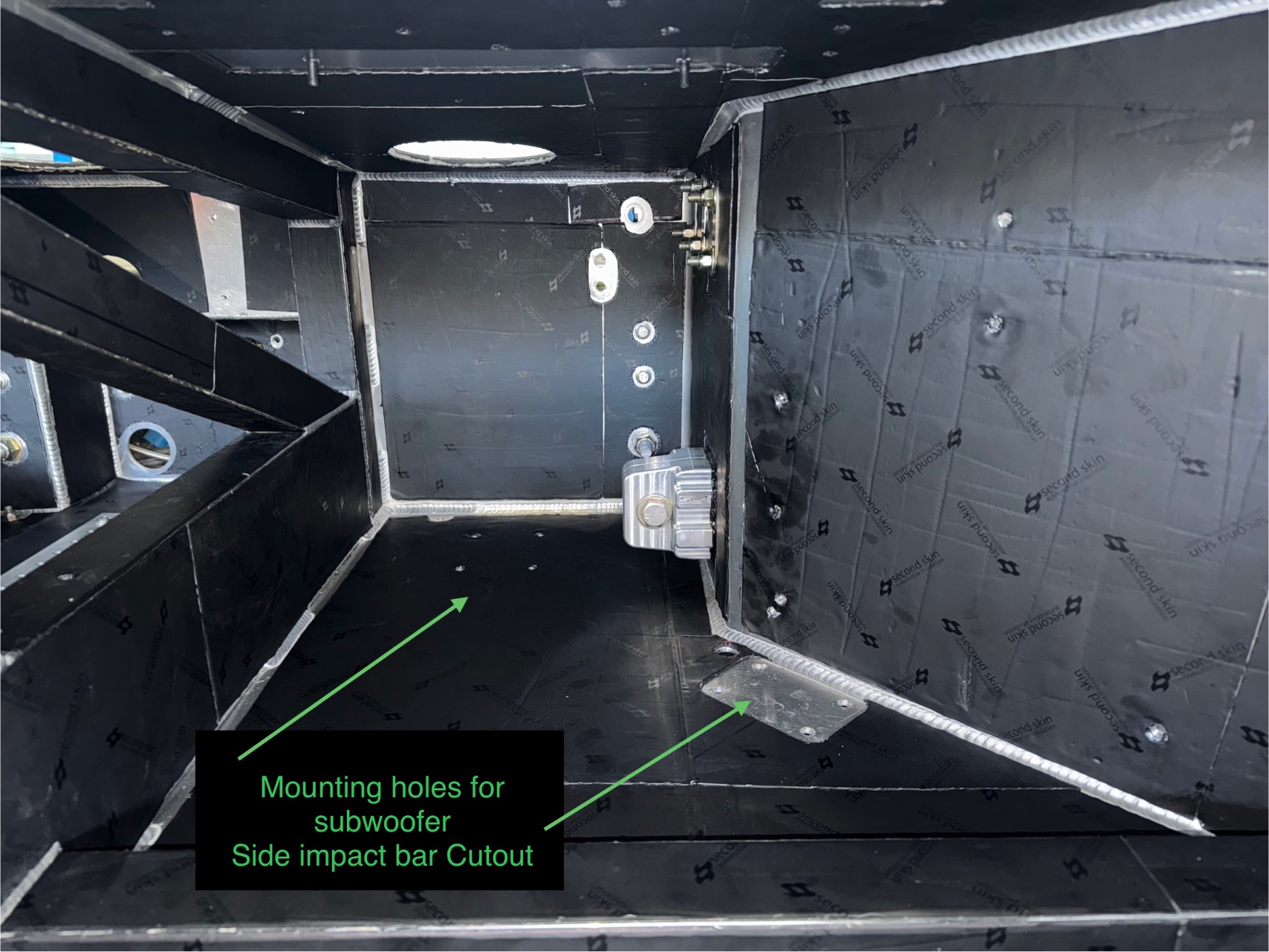

Figured a nice place for the sub enclosure is deep in the passenger footbox. The challenge being to make the sub box large enough with the correct volume to sound good but not too large and interfere with the passenger’s feet. You also need it shallow enough to install it with the AC evaporator in place. This just clears it.

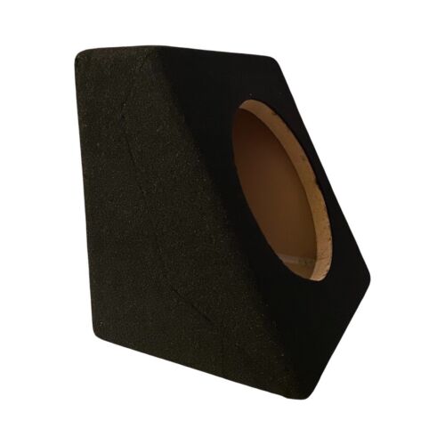

I bought a long throw 8” JL Audio subwoofer a couple years back and recently found a wedge shaped enclosure on eBay so I ordered it…
That sub box is really the perfect size and shape, but unfortunately the woofer I purchased was too deep to fit in the case. Note to self, “buy the enclosure first then the subwoofer”. I guess what is one more part to fabricate? So I got to work!

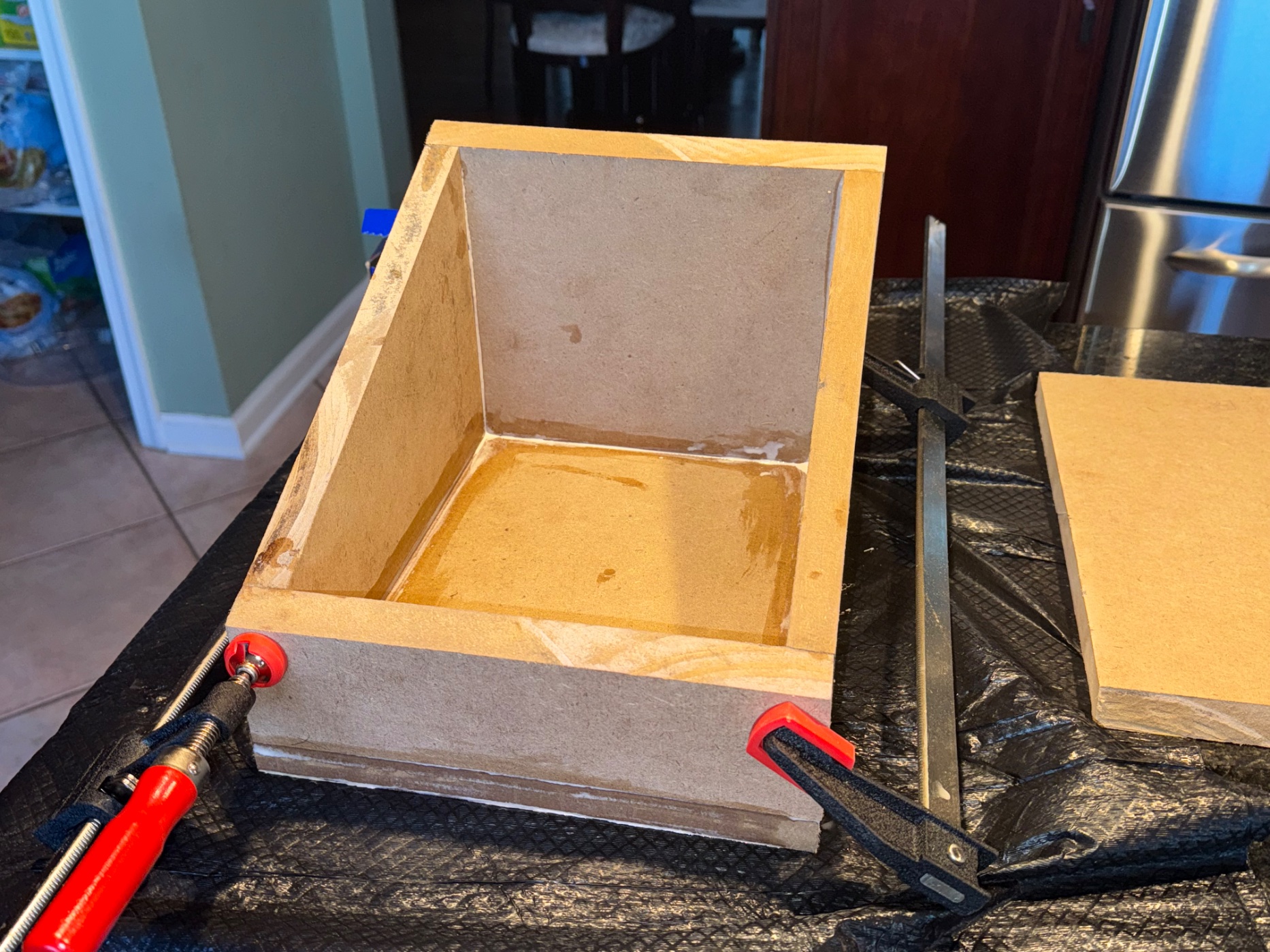

I drew out the dimensions on paper and transferred it to the 3/4” medium density fiberboard. The enclosure is 11”x9”x4.5”, a little taller and deeper than the eBay enclosure…

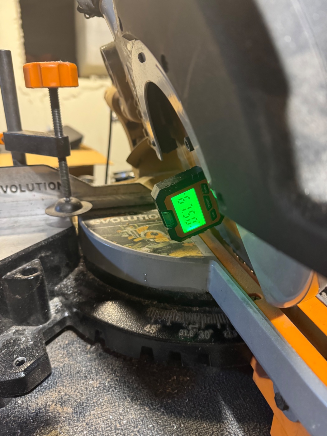

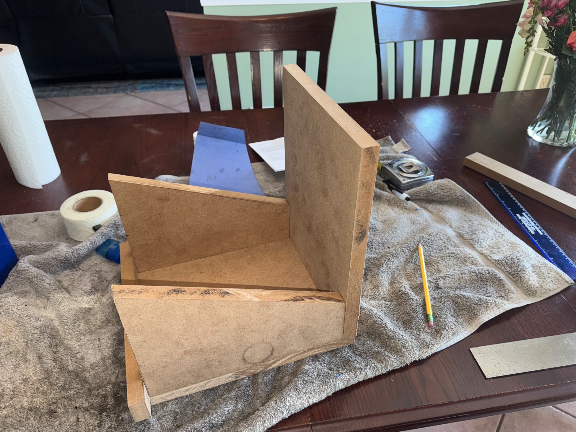

Then used a magnetic angle finder on the saw blade to dial in the right angle for the beveled end and face panels…
Used Tie-Bond 3 Ultimate Wood Adhesive and some clamps to assemble the back portion of the enclosure…

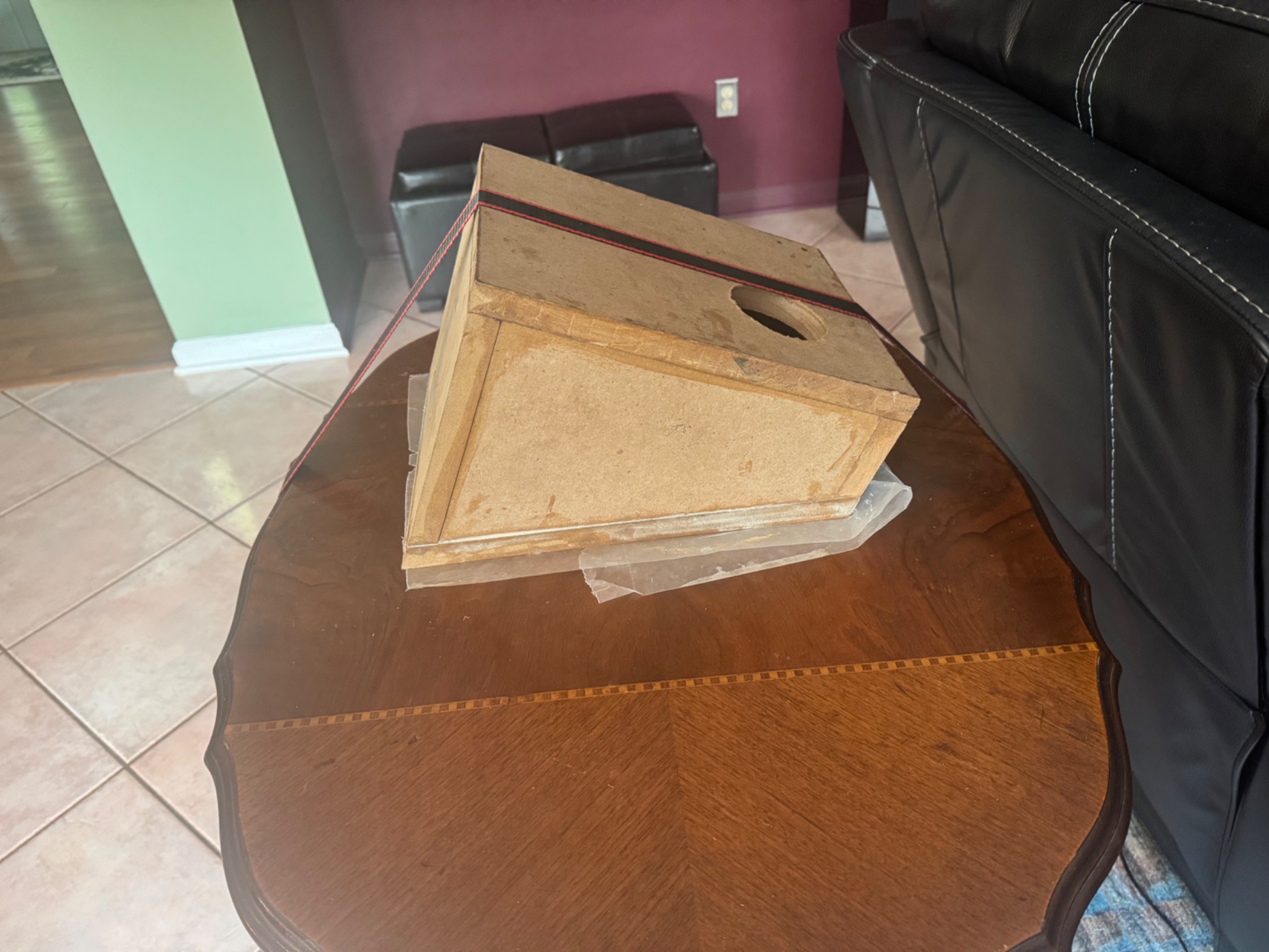

To glue on the front panel on I used a ratchet strap and an old table to tightly hold the back and front panel together…

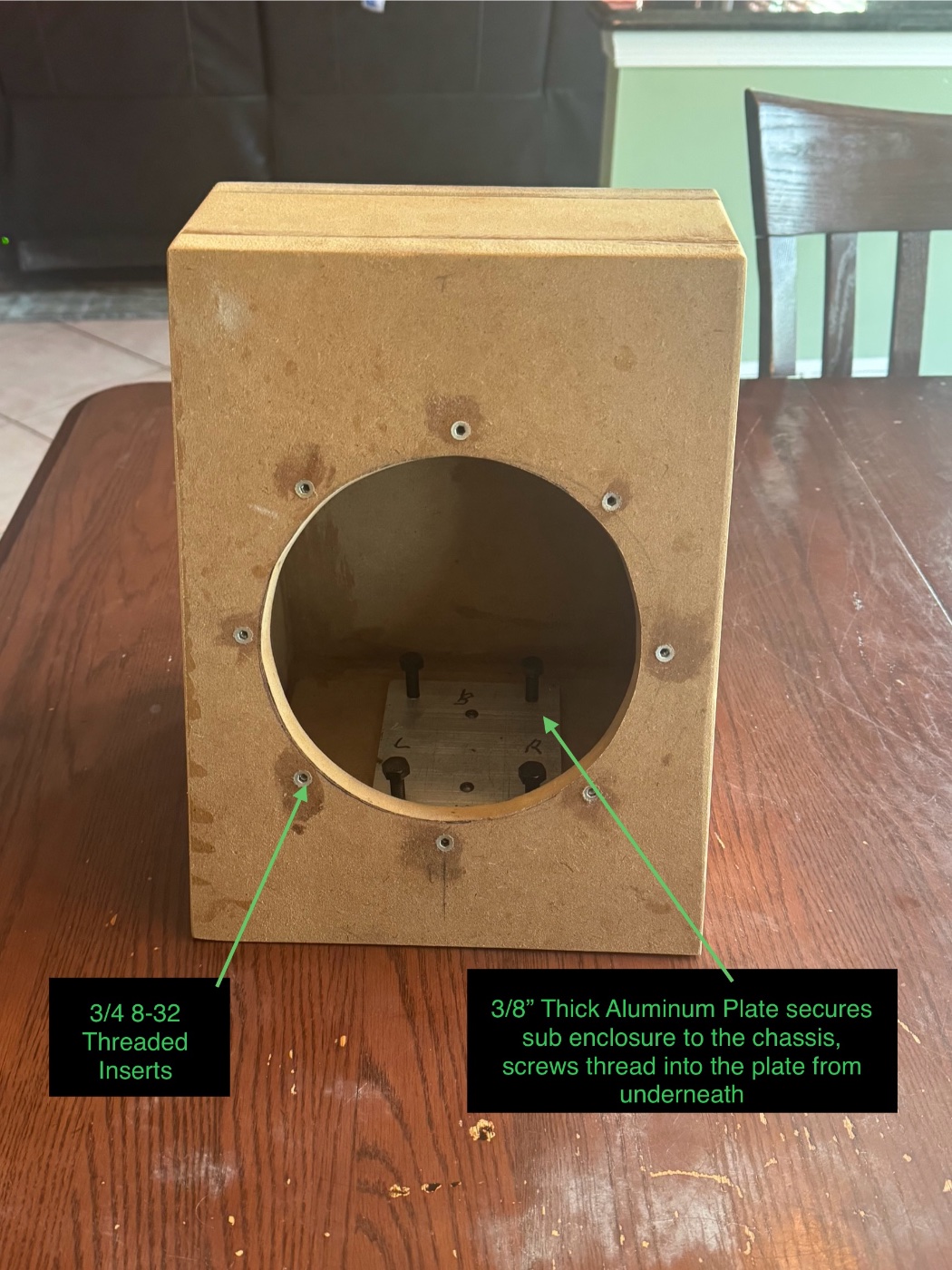

Epoxied 3/4” 8-32 threaded inserts to secure the sub woofer driver. Also fabricated a 3/8” thick mounting plate. The sub woofer enclosure is held in place from the bottom of the chassis with 4 M8 screws…

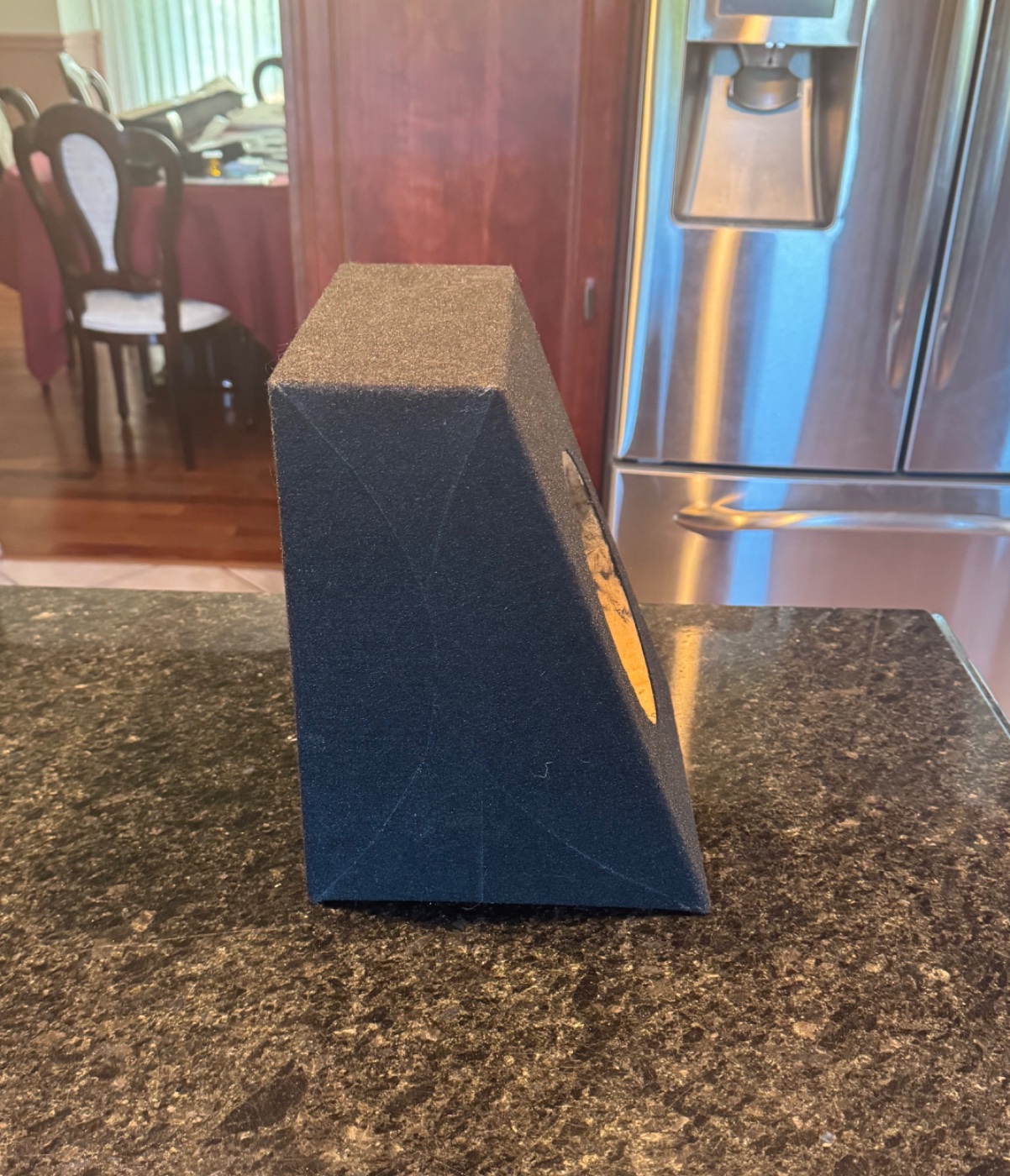

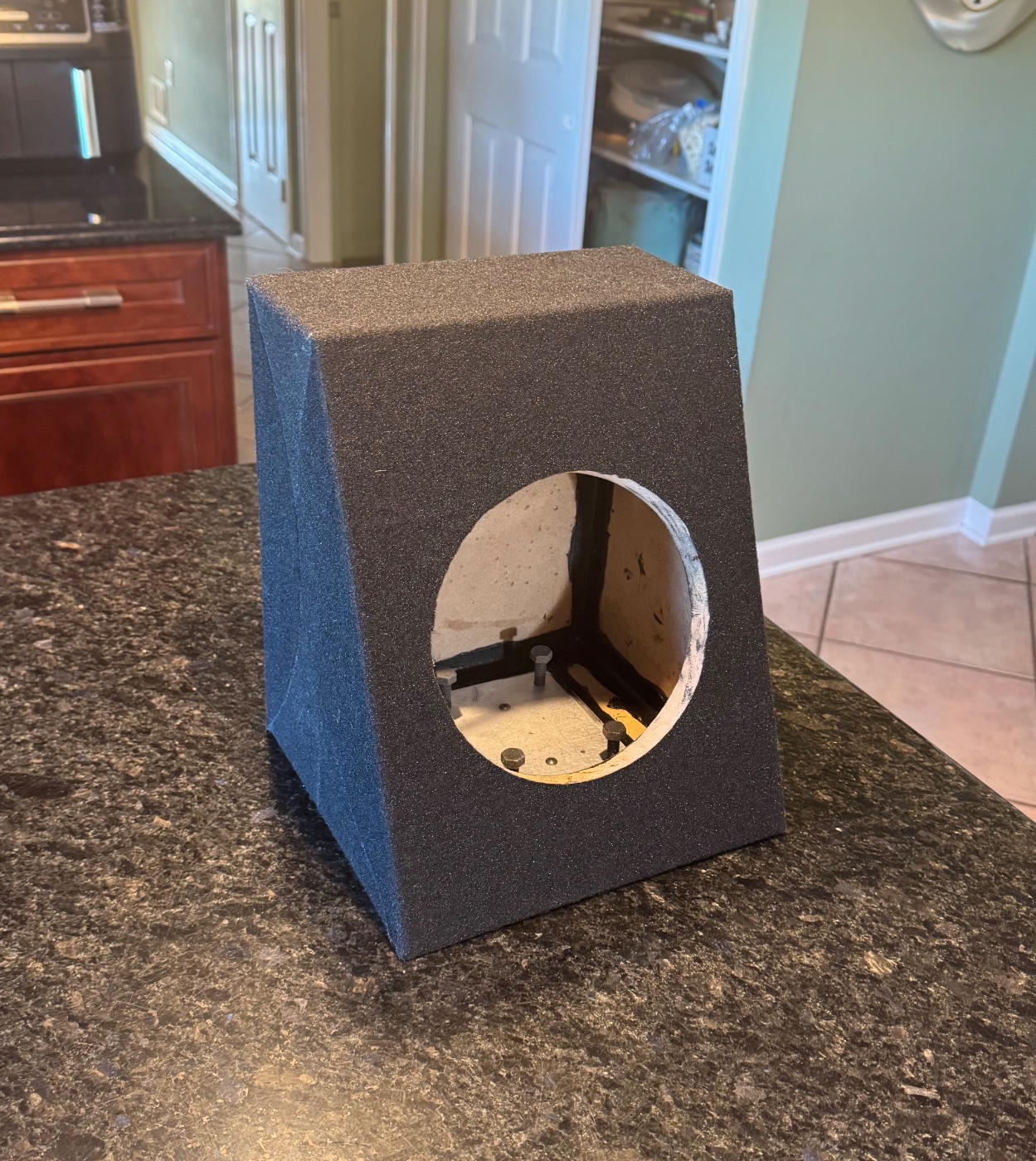

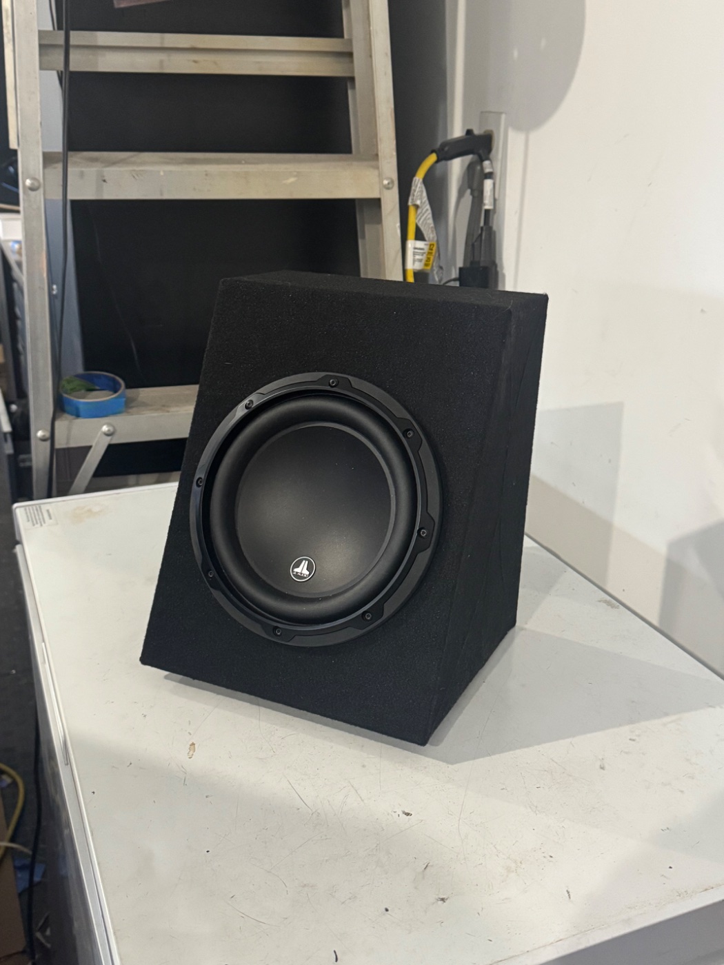

Used some lightweight felt fabric and covered the sub enclosure. Pic of the front…
I watched some YouTube videos on how to carpet a sub enclosure. I think the sides came out pretty good…
Installed the sub driver…

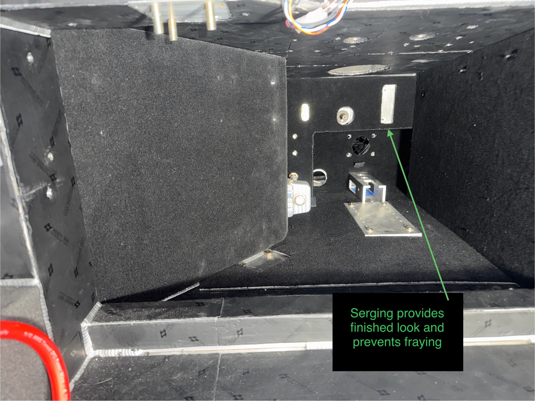

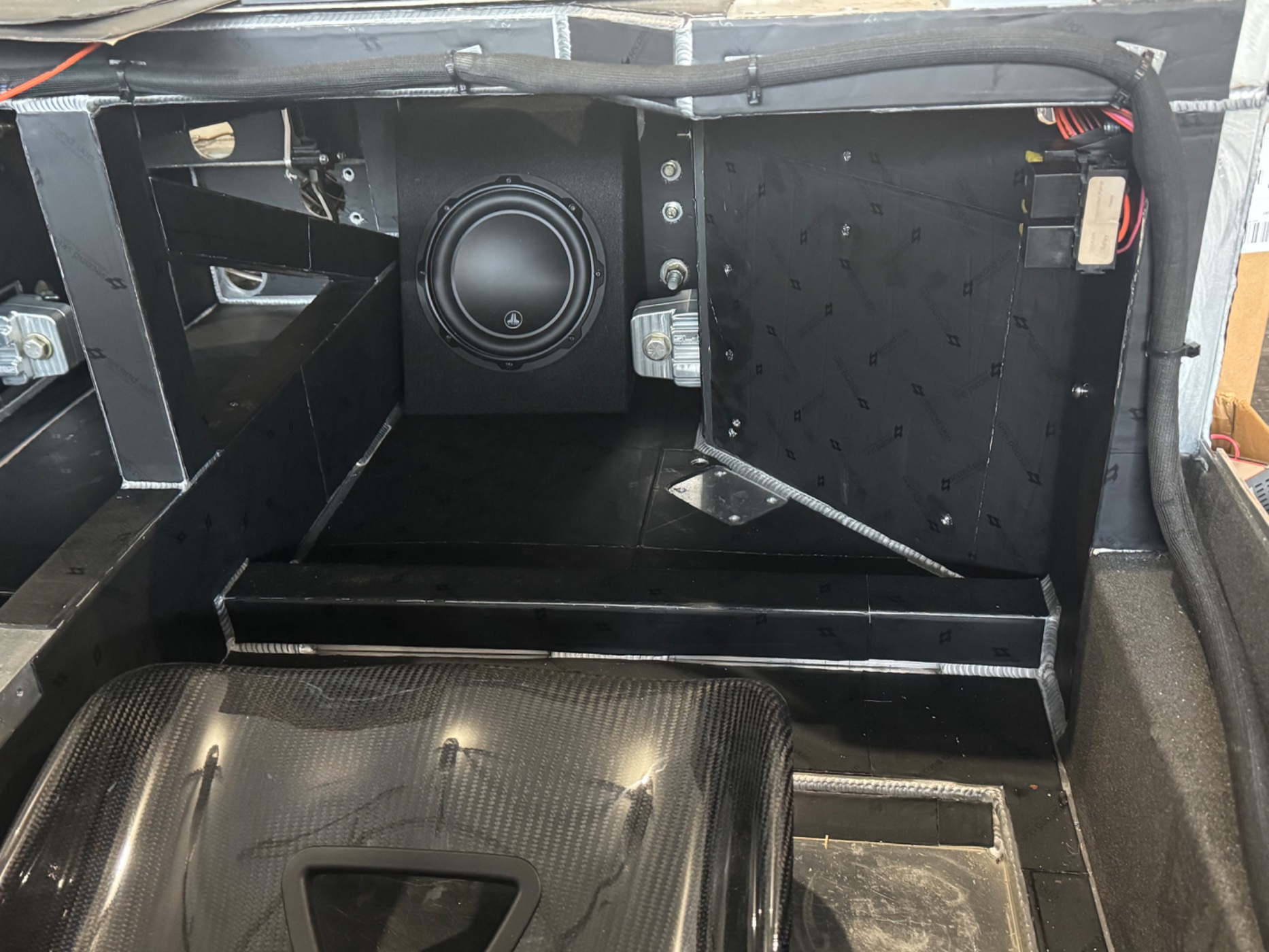

Pic of the finished sub enclosure placed in the foot box…
I’m 6’2” and with the seat all the way back I barely touch the sub with my toes so figure I’ve got enough room for most passengers. The sub has a grill which I’ll install to prevent the sub from being damaged.
