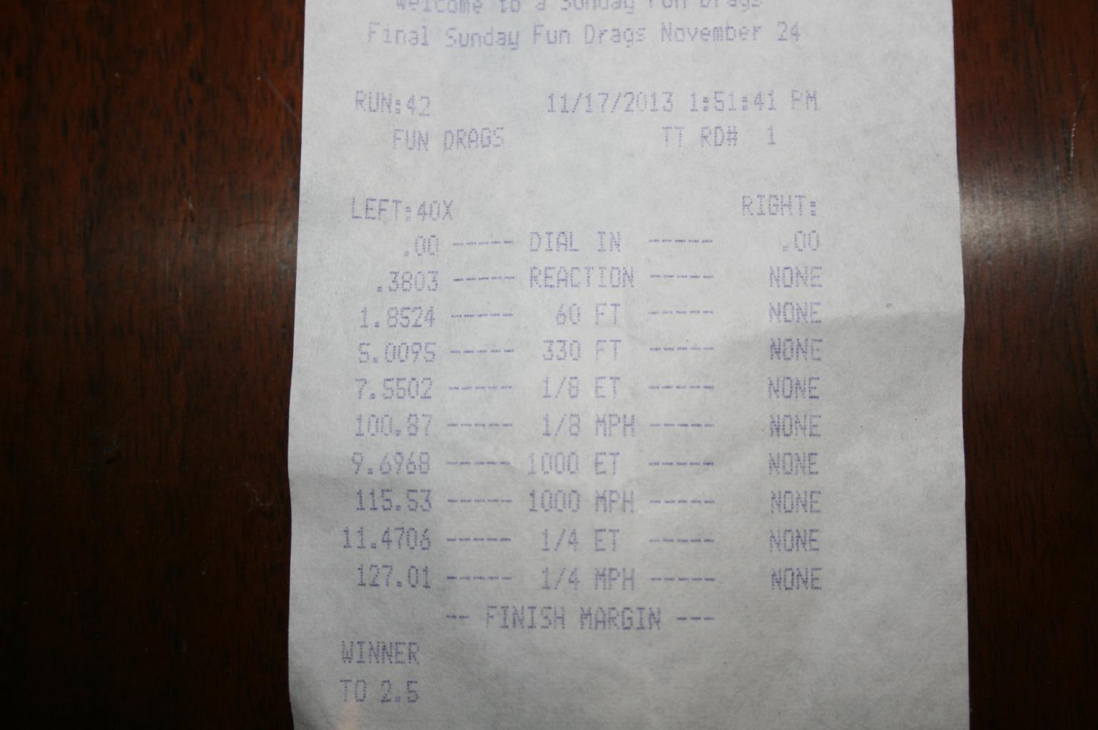

This is the second time I taken my car to the drag strip, I went with a couple friends that have the new Challengers with blowers on them, they are relentless on trying to get into the 10s, if I knew what I was doing I think I might have been able to do it. I only made one run (no burn outs) as I don't want to break anything. One person came over to my car when I finished and said thats a fast car I replied it does alright might do better with someone who knew what to do, he said it beat my drag car and your driving it home. Made me fell a couple inches taller. :)
I have to put solid mounts in as Kirby suggested, look at the top of my air cleaners in the rear view mirror.
[ame=http://www.youtube.com/watch?v=RaZsbnQTi_I]Mokan dragstrip 11-17-13 - YouTube[/ame]

You're braver than me Jack. I'm gun shy about standing starts with an RBT (or any ZF derivative). Looks like you didn't drop the clutch with big revs though? What tires?

1) Time? Speed? Looked like over 100mph (Never mind! I should have clicked on the second picture!)

Nice job Jack!!!! You nursed it out of the hole and gave it hell!!! Mid 11s are nothing to sneeze at when 427 Vettes on slicks with deep gears only did marginally better...

Randy its good to see your back! There was a 09 Vette there that couldn't get out of the 13s. I was reading my ticket after the run, the smaller reaction time the better correct? Whats a good reaction time?

Good run! Obviously the 60ft time is what killed the et. You were definitely sleeping at the wheel! ;o) A great reaction time is .001-.009. (the older equipment measured .500 and up)
I think 10s are a stretch unless you are willing to abuse the tranny and run slicks/air down your tires. I have a 930 in one of my gt40s with a BBC and I will probably try to break it too!! ;o) In search of the next weakest link......

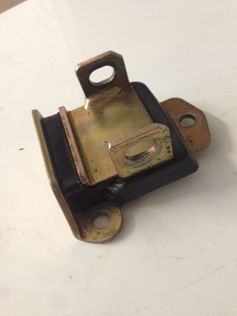

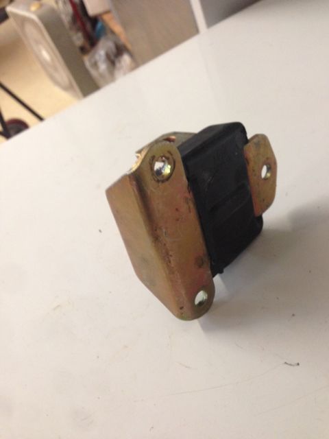

I'm quoting myself here...
While digging through things, I found the motor mount pieces with rubber that I replaced.
I'm sure most everyone has seen them, but I took these out and made solid pieces out of about 1/4" sheet metal to replace them.
Pretty easy to do.
FWIW,
Kirby
Is there an issue with the engine being able to move slightly with rubber mounts? What problem is being solved by solid mounts other that rubber mounts eventually wearing out? It would seem rubber mounts would also isolate some of the vibration from the chassis as well?
Kirby Schrader
They're mostly silver
1) If the engine moves 'slightly', I'd have no problem with it. Based on passengers watching, their comments were that it was lifting 'more than an inch'. This meant to me that the rubber was being stressed too much for my taste. What else is getting stressed or moved during this? Dunno... The ZF mount? Hoses? Wiring? Exhaust?
Do I have measured proof? Not at all.
2) Wearing out or breaking... That's it. I didn't want one of the rubber mounts to fail (usually the left one under acceleration) like I've seen them fail on other cars. Back in the dark, distant past, I had a dent in my '64 Ford Galaxie hood where the tri-power air cleaner hit it when the motor mount failed. Didn't want that to happen to the GT40.
3) As I've stated before, I have not noticed any increase in vibration nor noise with the solid motor mounts. Nothing moves when I nail it now, though...
I'm always of the opinion that it's my car, so I did what I wanted to...
Just sharing information.
:laugh:
FWIW,
Kirby
