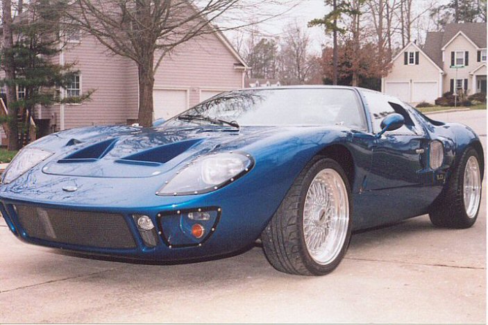

Pantera Ron,
Above Lucas turn signals are standard sized Optilux fogs. I have some plain H4 ovals mountied in the tops of the radiator side nostrils. BTW, it is my understanding that the round driving lights on the JW/Gulf cars were an aircraft landing light. We had a pretty extensive thread on this several years ago. Do a search on landing light and you should be able to come up with some info.
Lynn
