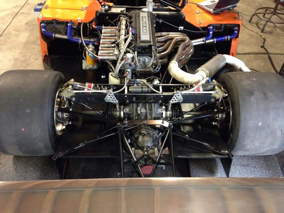

New to me - Sports racing car, mid-mounted BMW M3 engine, dry sumped. Drained the oil pan and feed lines to oil pan. Refilled with (ultimately) 3 gallons of oil. Cranked engine with ignition off to distribute oil, checked tank for level, repeat until level seemed secure. Car has been sitting for months and now the oil level is way down in the tank. Car has no oil leaks, and as I understand it, a sitting dry sump car's oil level will seek equilibrium over time. If so, how does one get the tank oil level back to 'normal' at this point? Cranking the engine (ignition off) does not seem to have any effect on tank level.
General dry sump oil change routine procedure would also be of use for my personal database.
Thanks in advance.
rule one always check dry sump tank oil level with engine running at idle, level should be just under the top baffle,
when turned off the oil will drain back past the pump back into the sump, hence the low level in the tank.

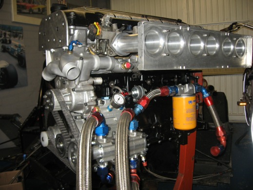

Is it an external multi stage pump?, if so flick the belt off and spin pump with battery drill until normal running pressure registers on gauge. This way you avoid any chance of air pockets, dry bearings etc with cranking whole engine.. As a rule of thumb-mine- the oil tank should be about 2/3 full with engine running, eg if tank is 3 gals capacity it should have 2 gal's oil & 1 gal air at idle. However some tank designs are not that simple, for example the pics recently of MK11 GT40 type posted recently.
