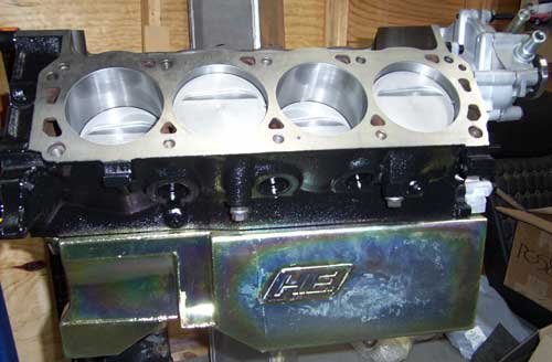

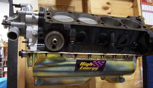

Al here are a couple of shots of my dry sump on 302 prior to going in the car.Note the cut away for chassis crossmember.
Ross

Alex Hirsbrunner
Thanks Tim & Ross,
I'll be contacting the two vendors you identified (hopefully they retained the design information for the pans they built for you)
Ross - What is the depression in the side of the pan for (on the left in the last photo) - is this a relief for the starter?

Ross Nicol
Al yes the indent on the side is for the starter (reduction gear type).I had the sump made and forgot to take the starter motor into account.Had to take it back for them to alter it, at my cost of course.Boy custom work can cost you money.

Alex Hirsbrunner
Hi Guys,
I noticed that there is a large difference in the general volume of the pan that Ross is using (HEI) and the one that Richard has (ARE). Is there an advantage to either? I'm assuming that the off the shelf ARE will clear everything like the starter and chassis on an RF (especially for the shallow 289/302 version I'll be using) but Ross's pan seems to provide couple of "mini sumps" that I presume provide (how do I put it...) better suck-ability?
One last thing - is there a way to determine how many stages are appropriate (or at least how many returns should be plumbed into the pan)? Is it based on rpm range, expected cornering G's, crankstyle (e.g. knife edge) or something less obvious?
