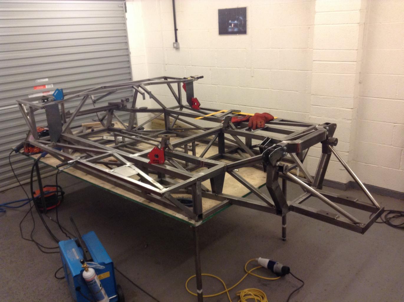

Couple of pictures attached of current progress – The main “core” of the chassis has been tacked together, though progress is slowing as I’m still waiting for a lot of parts from GT-Forte. The chassis kit does go together very well though, and with the laser cut parts it’s possible to work to a high level of precision. Would like to thank some of the other GT-Forte builders for their help so far, it's really appreciated - especially Nick, David, Andrew, Darrin, Jayson and Lee.

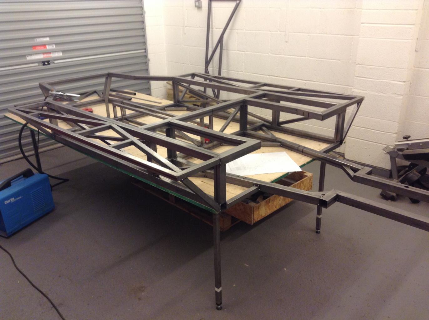

Slowgress on going... Chassis getting there. Holding off on roll bar until it's flipped over for the lowered floor to be fitted.

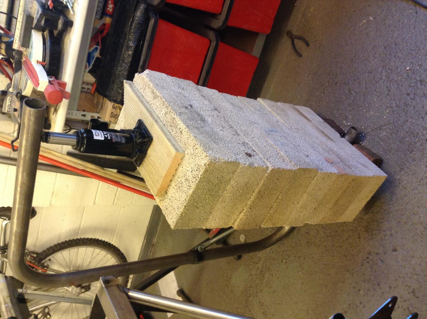

Just for some guidance, the roll hoop will likely be slightly larger in size where it meets the chassis. I Used a Rachet Clamp with strap on mine to compress that extra half a centimeter or so. Without that I'd never have got it right.
Nick.
So I managed to get the roll bar to the correct dimension after a couple of tries. Should be self explanatory, basically it was hooked under a pile of concrete blocks and stretched using a bottle jack. A brace was added across one corner to bias the load to the bend that was at the more acute angle.

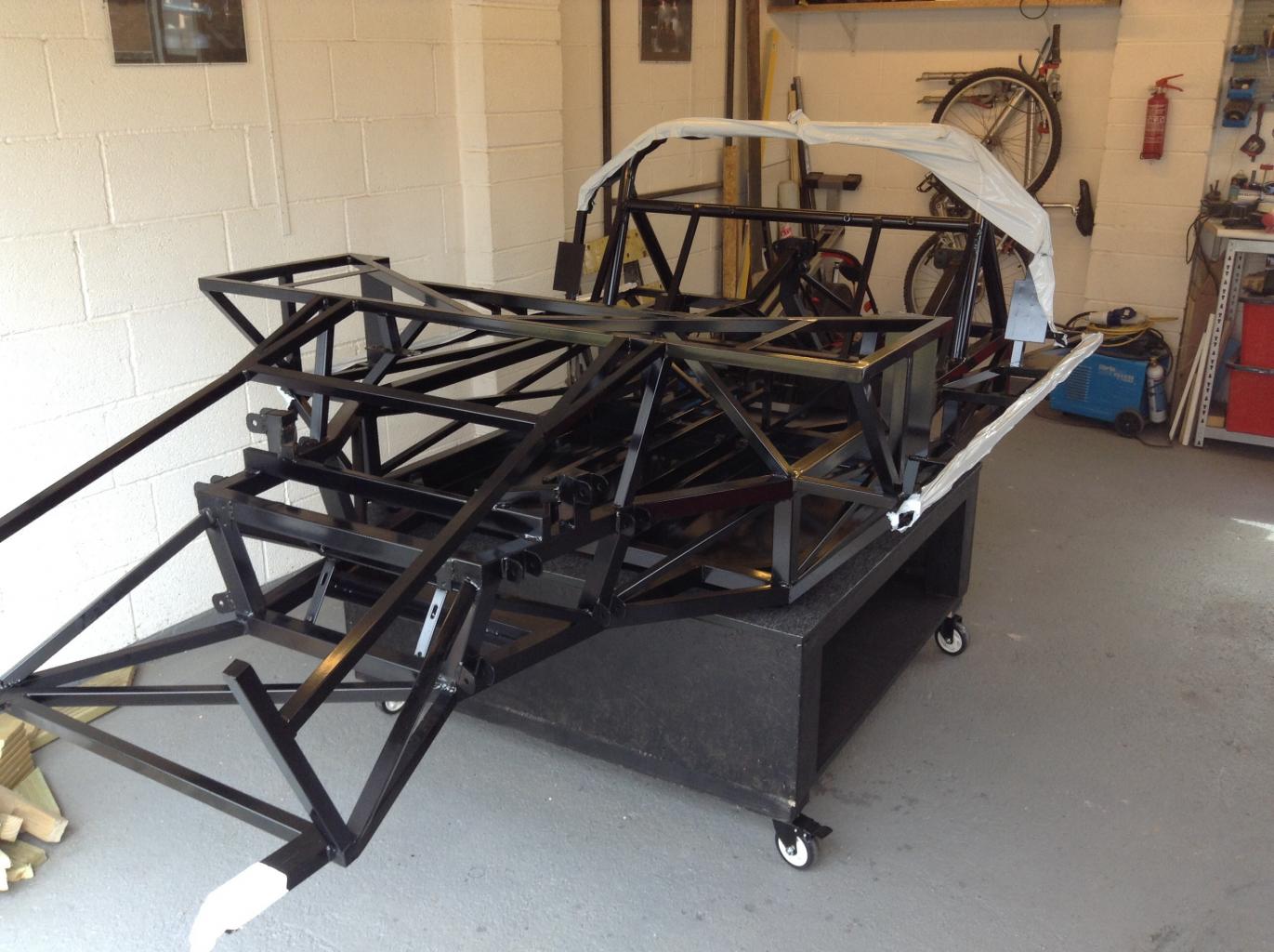

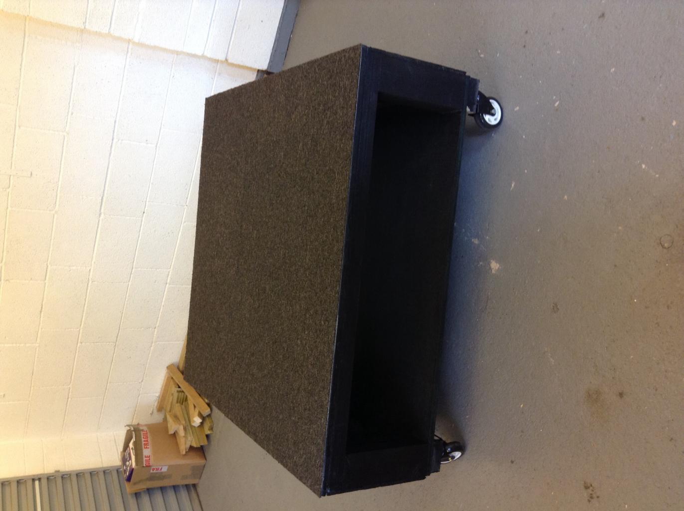

Chassis build trolley completed using off cuts from the build table and the crate the chassis kit came in, suitably beefed up. High to avoid back ache, will need to think about how to lift it off however!

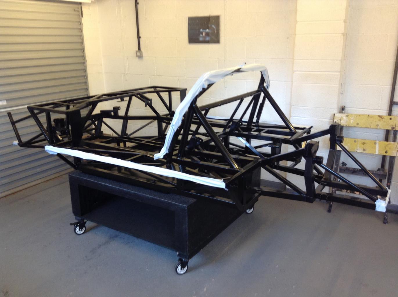

Chassis back from powdercoat - now the fun begins! Black satin on top off shot blasting and primer.
