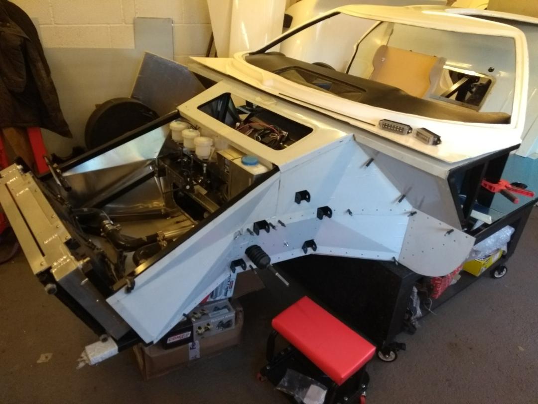

Not much to update, still making slowgress. Got most of the front end done now, just need to get the front end panels powdercoated and the riveted on.

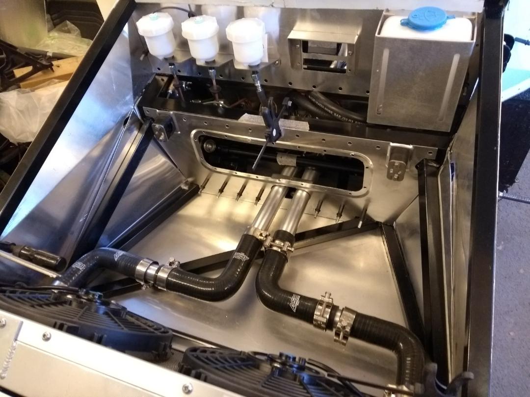

Brake lines etc in. Gone for hardlines from the reservoirs to the master cylinders so I can avoid the steering UJ. Fabricated a cover for the washer bottle and hood for the fuse boxes to avoid splashes.

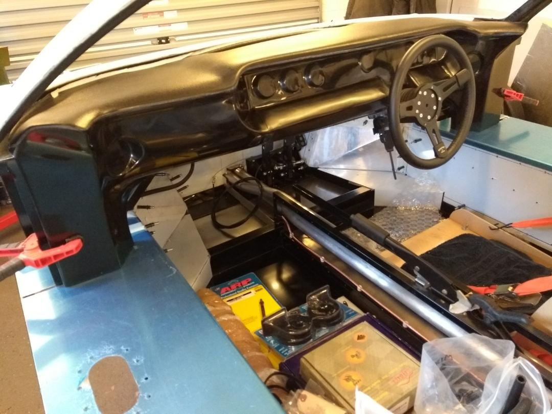

Lee Dawson dash mocked up (thanks Lee) so I can play with the column position, but need to get the seat more refined first.

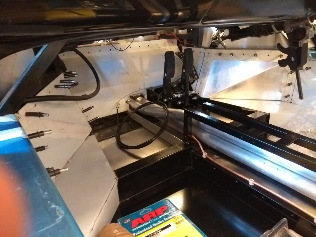

Footwell panelling getting there, will be powdercoated eventually. Also mocked up the clutch, water and brake lines. Will wrap the water pipes and add some protection to the brake and cluth lines to avoid rubbing.
