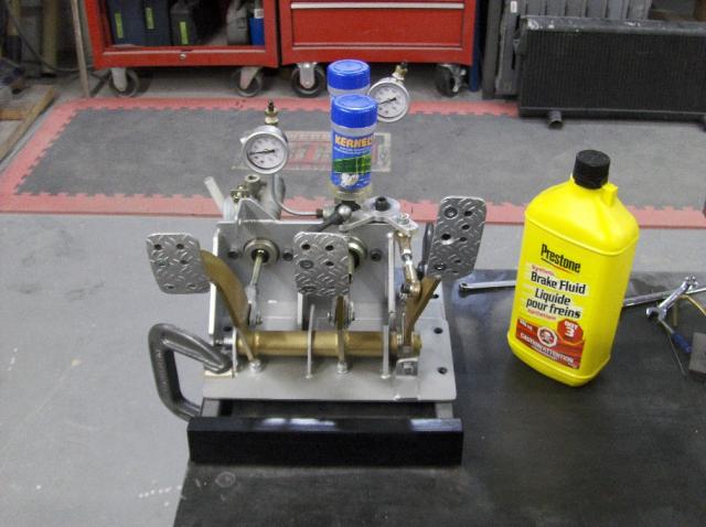

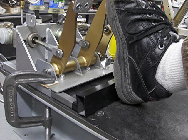

This has been a PIAS since day one on the Series 100 cars. Now that our Gulf car is just about ready to hit the road & track again after being converted to RHD (that's a BIG job on this car) we had to address the seat issue.
A drop floor pan has been fitted and an adjustable heel bar incorporated into the revised pedal tray. The heel bar alone was a huge improvement.
Some experimenting with various wedges under the forward half of the lower seat bottom produced positive results. Lower thigh support was introduced, lower back pressure gone, and the spacers previously used to tilt up the seat removed which gives back legroom as the seat back doesn't hit the firewall before you're at the back of the tracks.
This looks like a producable part, most likely covered in black low pile carpet which will grip the velcro already on the seat cushion and shell. So it's a drop in part, no re-upolstering, no new seats, just a simple solution.
The parts being made along with several detail items we're taking care of in the final (re)assemmbly. Look for pics soon. Here's the heel bar, something you could fab up.
