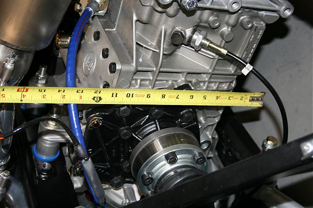

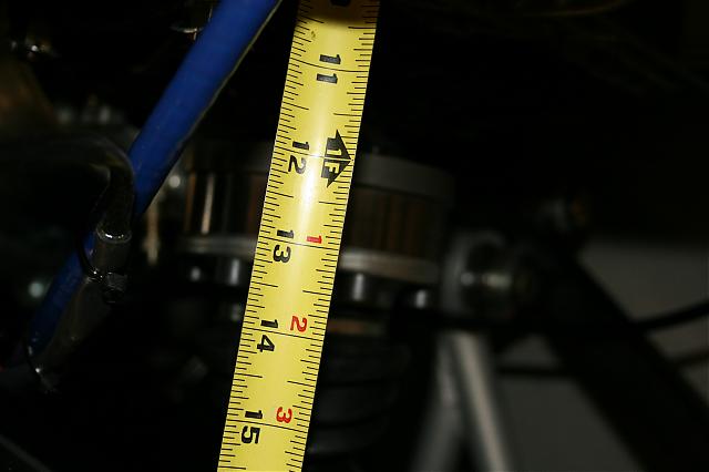

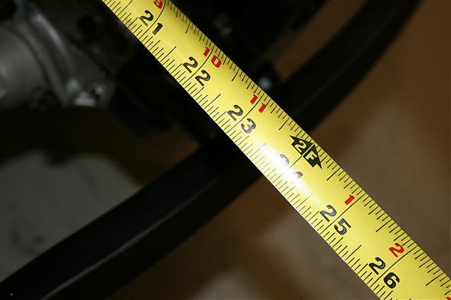

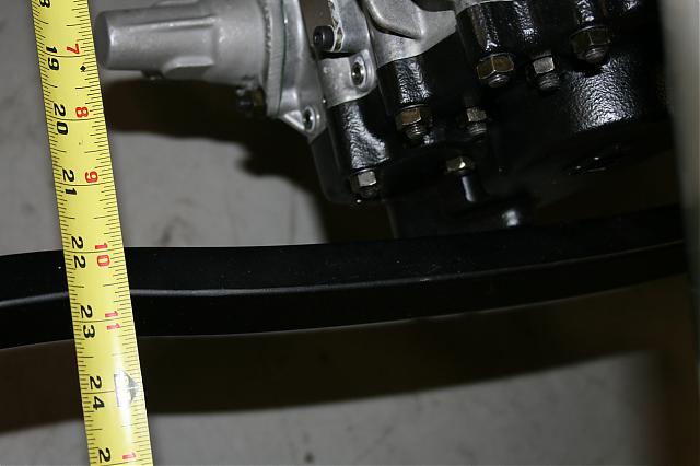

If your going with SPF then better stick with ZFQ, RBT or ZF, I have measured and researched for different transaxles for my car and it boils down to those choices so far. Has anyone seen a different transaxle in an SPF car other than ZF or RBT-ZF? Here are a few pictures I have taken with a tape measure in hand. The measurements are taken from the front of the transaxle case.
