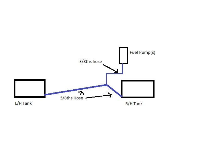

Bill,
A bit of thread drift here from me, but my plan (as shown on my build log)
is to connect the two tanks with nice wide 5/8'ths braided hose. I plan to tee off this pipe to pick up the fuel, with a reducing tee to 3/8th's to the fuel pump. This means that the tank connecting pipe (5/8ths) can be higher than the tanks at the point it Tee's off to the pumps, as the pump(s) can draw fule evenly from both tanks, as it is drawing from the highest point in the system. Sense check me on this please, but it follows logic, and I can't see a downside as yet...
Here's a (really) simplistic layout. I'd appreciate your thoughts.
Cheers,
Graham.

I was under the impression fuel injection pumps had to be gravity fed to prevent pressure loss across the pump and therefore avoid cavitation.
Not sure, but I thought that was the case.

This is beyond my technical knowledge. Anyone care to help out here?
Cheers,
Graham.
Jack Houpe
EFI pumps, (Bosch in general) are positive displacement pumps (they can suck up from the tank) although its not good on the pump itself as they are not meant to run dry it will work, if your plumbing is tight with no leaks on the input side of the pump it will work.

Graham
I run fuel injection on my car
2 tanks into 1 pollack 6 way changeover
Out of changeover into filter
Out of filter low pressuure pump (Facit Red top)
Facit Red to Swirl pot
Return from swirl back to pollack 6 way valve
Pollack 6 way return to tank from whence the fuel came
Then from swirl to HP pump
HP pump to Rail and pressure regulator
Return to swirl pot
All the above is mounted on the bottom chassis box sections in my car - as low as possible
From half tank level under braking I can hear the Facit red top note change as it sucks air (Really hammers away!) Tanks have explosafe in not foam.
So unless you have a good sump arrangement in your tank I don't think a single HP fuel pump would work - it would suck too much air too often
I have also seen on here that you would probably need an inch diameter connector pipebetween the tanks (Especially if you are doing Efi and only returning to one tank)
IAn

Hi Ian,
Thanks for the Info.
I have 5/8ths ID pipe connecting the two tanks at present. Each tank does have a 1/4" BSP fitting at the bottom, but this won't be any good for fuel return, because they are at the bottom (I'm guessing). You are returning your fuel via the Pollock 6 way. Is this to the top of the tanks?
I'm getting this pictured in my head bit by bit....
Thanks guys,
Graham.
Ian Anderson
Hi Graham
Correct the fuel returns to the tank via the Pollack unit
My returns go back in to the top of the tank but in reality they coud return to any part of the tank.
I would suggest that even if you use the 1/4 bsp hole in the tank you add a 90 degree bend and take it to the height of the top of the tank. That way if any of your pipes come lose / rupture you are not going to have the fuel just pour out.
