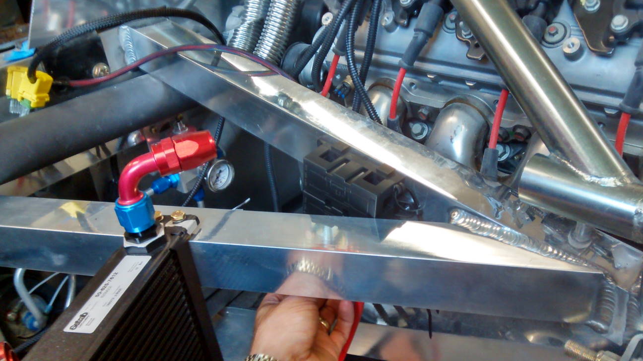

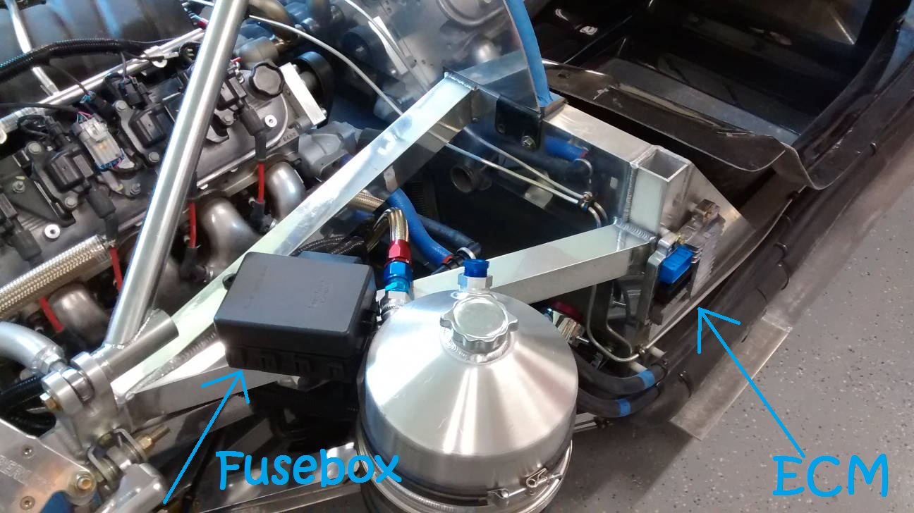

2) Several builders have mounted the ECM on the right side of the car, between the frame and the body (see attached picture). With the ECM in this location, a natural position for the fusebox would be on the right side of the car on the frame rail next to the dry sump tank (see picture). Any problems with mounting in this area?
3) Should the GM harness in fact be run back to front, with the "evens" on the right?

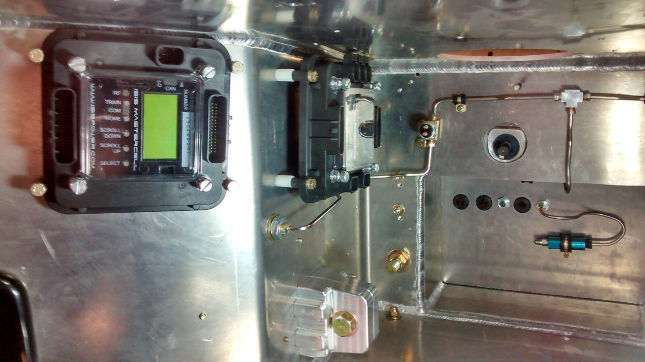

4) Any problems with mounting the rear ISIS powercell on the left side of the panel behind the rollcage? (I guess you could call this an "upper firewall"?)

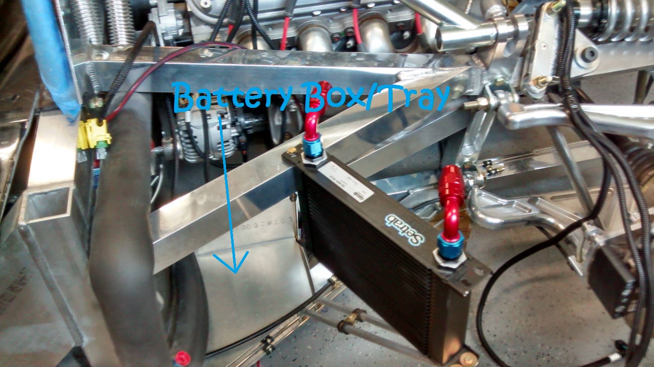

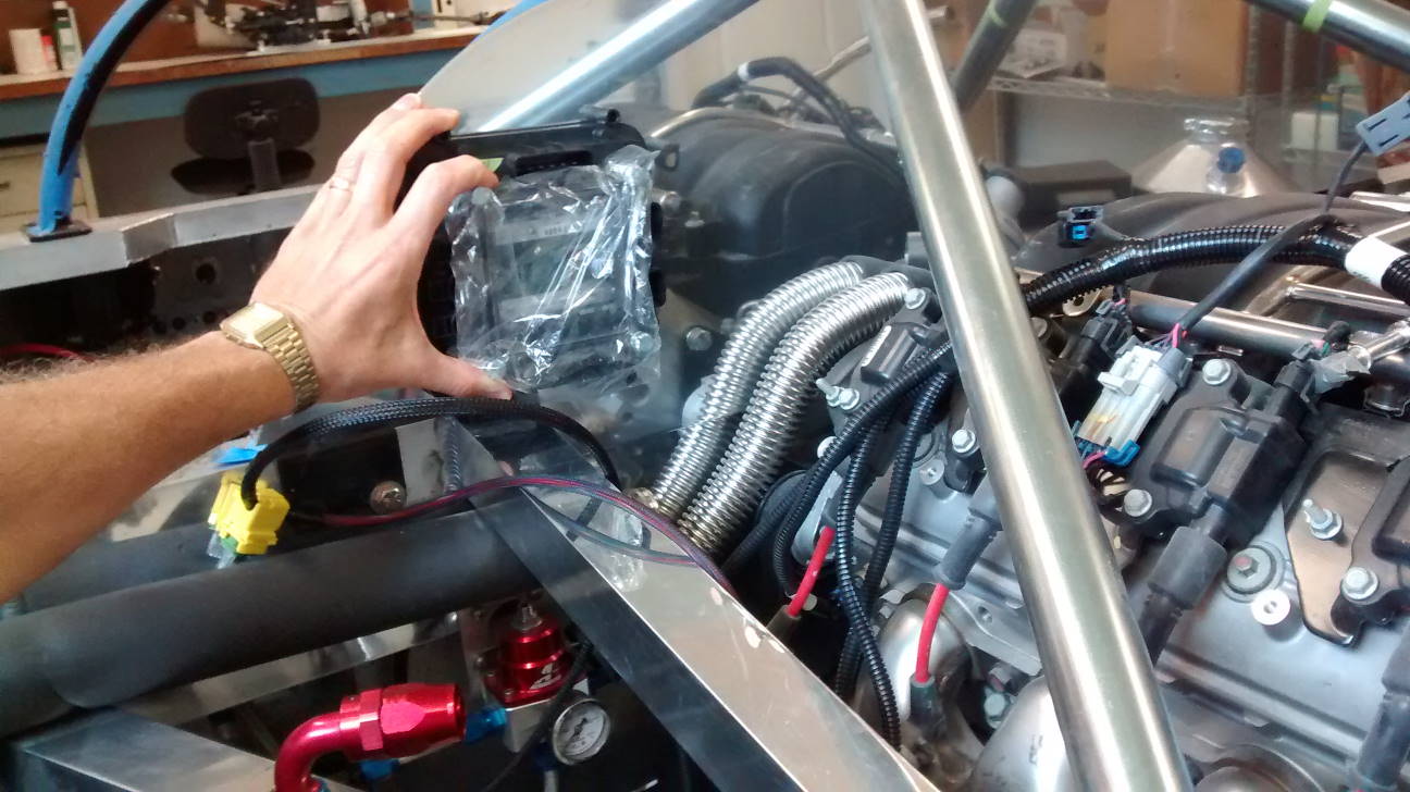

Put it whereever suits your build; mine is located on the left-hand side of the car.
Driver-front of the engine is #1, passenger rear is #8 .... your injectors should be marked with tags saying which is which. If they're not tagged (mexicans got lazy, lol?) I think if you run the harness from behind the engine the lengths will sort themself out.
Keep in mind servicability - some people are burying their electronics in a place that is almost impossible to get to in a completed car without doing major part removal .... I'm glad I kept mine in easy-to-access areas after I had a powercell die on me.
You'll also want to build some type of shield in the front to protect your master cell and powercell - mine are located in about the same area and I broke 2 connectors during my build from accidental strikes from my leg ... oops, lol.

I put my rear powercell on the back of the firewall on the right side. I plan on mounting the fuse box and ecu below it. I'm going to fabricate some brackets to put them below the firewall, in front of the gas tank. I'm probably just going to run a couple of pieces of aluminum bar from the top frame rail to the bottom frame rail.
I tried to mount the rear power cell on the right side (passenger side) and a Canton coolant tank on the left but there wasn't enough room between the front end dress idler pulley and the water pumps lines going to the bottom of the Canton tank. I finally mounted the Canton tank on the right, the ISIS rear power cell in the middle and the mega-fuses on the left. I will be mounting the ECU and GM fuse box on the right side.
my $0.02, future access as Alex pointed out is important. Another thing to take into consideration is all other components. I made the mistake of mounting things on the firewall without the engine front assembly on/fuel inlet hose in place and I ended up moving things a couple of times.

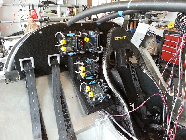

Obviously not a look everyone would want - but here is where I mounted my ISIS components.

Well, you definitely got the accessibility part going on, haha!
What the heck are you running that you need so many powercells? :stunned:
PeteB

I could've used another powercell, but was too cheap to buy one. There's no circuits in the stock package for stuff like a stereo, backup camera, power ports, engine compartment fans, accusump, etc.

I think I may have seen that design somewhere before.....;)
