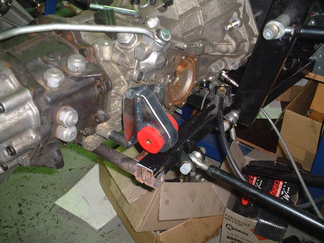

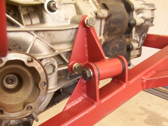

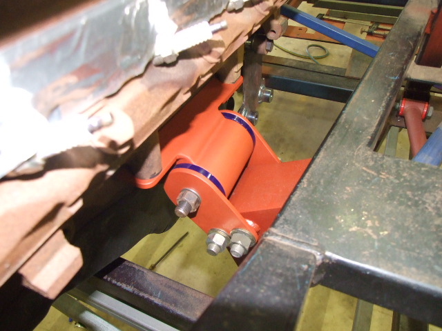

urethane
I used an MGB suspension bush in all mounts.

Thats a neat solution. If I remember rightly cast ali has about 2% elasticity so a polyurethane bush must extend that a bit but won't allow much of the wavering about in the breeze kind of movement I currently get. Most interesting. Pictures helped a lot, thanks for those.

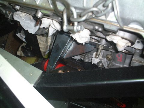

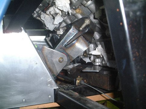

Yep, used urethane as well. Not running yet so cant comment on that.
One word of caution though, I used a solid engine stay on my Escort race car. It made the gear changes easier but went slower. Took the stay off and the speed came back. Can only put it down to the fuel boiling in the webers due to the vibration.
