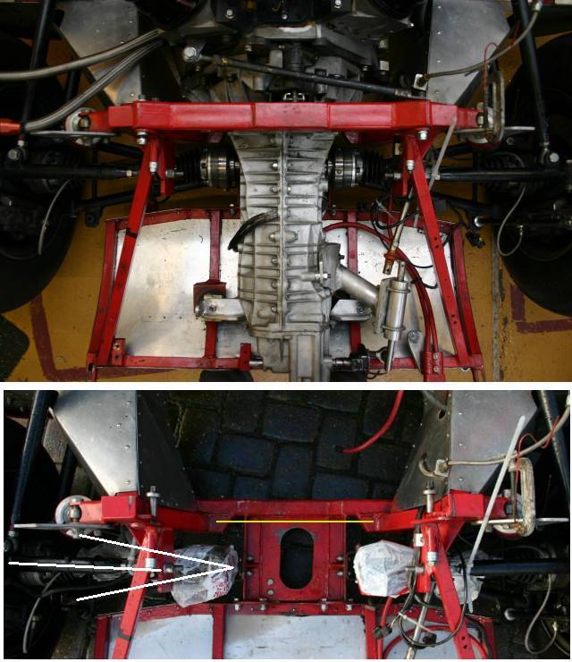

In relation to the upper and lower rear suspension attachment points, where EXACTLY does the motor/trans joining point lie? Does this placement vary between different chassis designs? I have tried to get a view on this through photos on the site, but parallex makes this difficult. An overhead view would be ideal however. I am trying to get a handle on the chassis stiffness/support problem, and have thought of a possible solution depending on the answers. Please bear with me. /ubbthreads/images/graemlins/smile.gif
Re: Engine Orientation in a \'40
Hi Keith -
In relation to your question about suspension point location - this might help. Picture shows chassis rear on Roy's modified GTD. The yellow line shows where standard chassis member normally passes and white shows sus arms.
Note that Roys engine is also forward a little too (50mm?)as the lower rear crossmember normally fouls part of the gbox/bellhousing which prevents the box being lowered much.

Hey paul, thanks very much for those photos and the trouble you must have gone to to get them. If this installation is typical, then my "brainwave" is not an option. Quite simply, I was going to suggest the use of an ali engine "plate" of say, 1/4" thickness which mounted between the engine and gearbox, suitably cut out for same, with allowances made for extra length input shaft shaft etc, notched to locate on frame rails and bolted to horse collar. In drag racing, we used such a plate mounted at the front of the engine (in a front engined configuration) suitably cut out for ancilliaries, which anchored the motor firmly to the chassis rails forming a solid tie together with solid engine mounts in the appropriate location and triangulated shock tower/firewall bracing. This provided the very best resistance to torque induced twisting moments on launch. If you can see where I was coming from vis a vis the '40, if the engine/trans joint was close enough to the chassis suspension pick-up points, then such a plate would bear much of the transient loads induced by both engine torque and suspension effort without unduly stressing the motor itself and "solidifying" the entire drive train/suspension package. This may have solved a problem for the chassis lacking in a lower cross brace in order to gain a lower motor placement. Unfortunately, I have not been close enough to a '40 for some considerable time, so I was unable to do more than simply "theorise". Thanks again for your time. Back to the drawing board! /ubbthreads/images/graemlins/crazy.gif

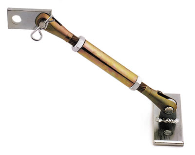

Summit Racing sells engine torque links(Competition Engineering) for Mustangs($54.95 each), that might be adaptable for what you are trying to accomplish.
Adjustable and easily removable, by pulling a couple of pins(for smoother road use). Attached from the rear of the heads to each chassis rail, they would provide a pretty solid link across the chassis.

If you look close at the first pic of Roy's setup, you will see just such a link from the #7 cylinder across to the oposite side in front of the shock tower. No????
Bill,
Si senor! /ubbthreads/images/graemlins/grin.gif Very similar!
Roy's car is primarily a track car though. The pin removable links might be better suited for mostly street/occasional track use(like our cars).
I like my kidneys too much to mount a permanent one!

Blimey! A good old fashioned turnbuckle no less! Looks effective too. The (theoretical) idea of the solid plate interface between engine and bellhousing is that it would lock the drivetrain together with the frame at the exact point where the suspension pick up points impart loads to the chassis, thus eliminating chassis flex, whilst allowing the motor to be mounted lower, without the need for a lower sub-frame in this area; the lack of which (in some designs) is causing some controversy elsewhere on this site. Unfortunately, the orientation of the engine/trans assembly with the suspension pick up points (as ably demonstrated by Pauls' excellent photographs) does not seem to support this theory.
