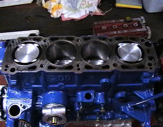

i use hammerite its excellent and covers any imperfections
