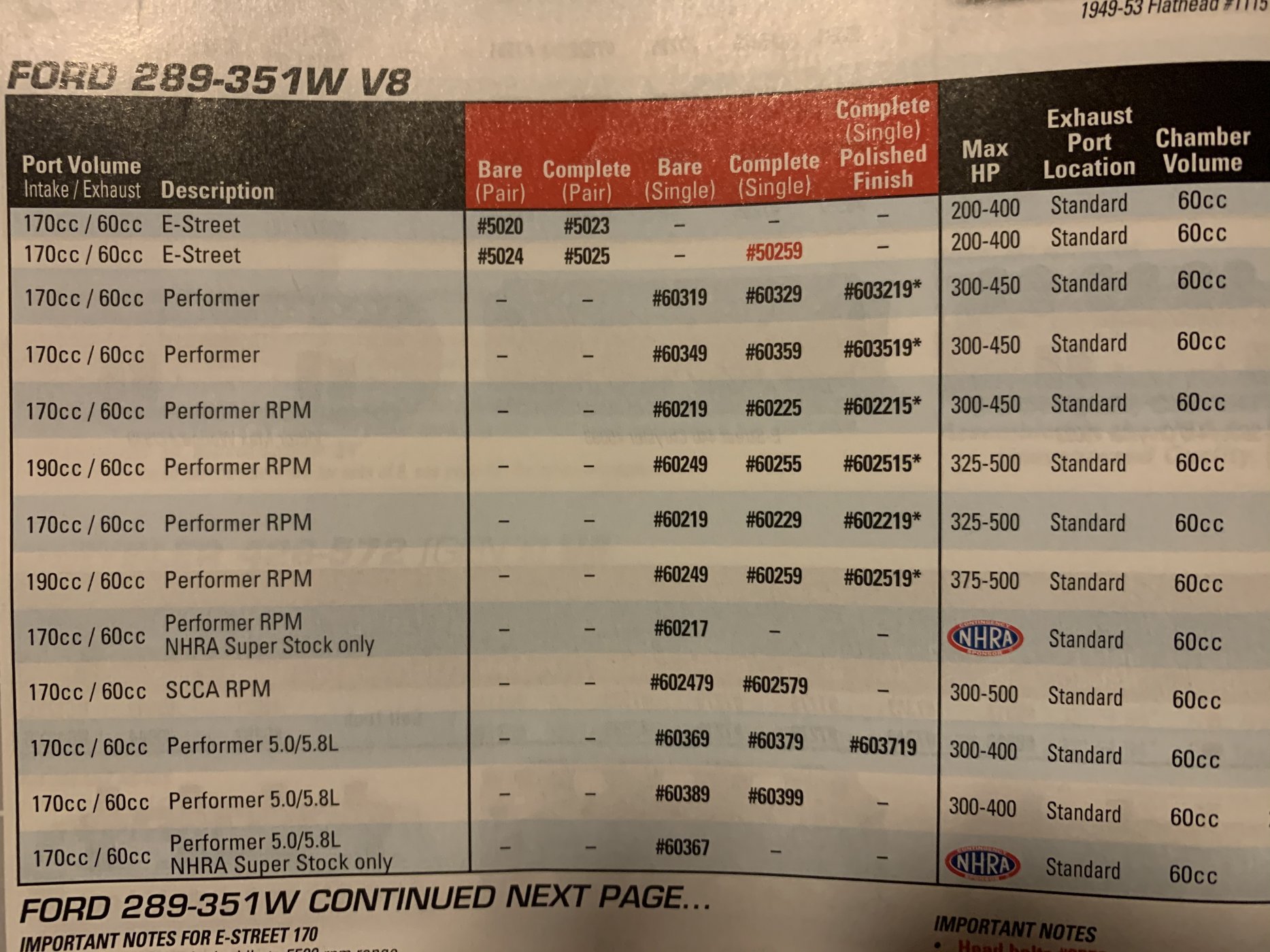

thank you for your politeness. Then I would like to select Edelbrock performer rpm, but there are several types. Which one is right for you?

Mike Pass
For Ford Windsor 302ci
Edelbrock Performer RPM cylinder heads 60255
60cc combustion chamber, 190cc inlet runners, 2.02"inlet, 1.6" exhaust
I have been using these on my car for over 10 years.
Match the inlet manifold to the heads. Use good gaskets e.g. Felpro. Use ARP bolts with their thread lube. Use a set of good quality roller rockers.
On a 302 should be around 340hp and 340ft.lbs torque and will be a good strong street setup.
Set up on a rolling road.
