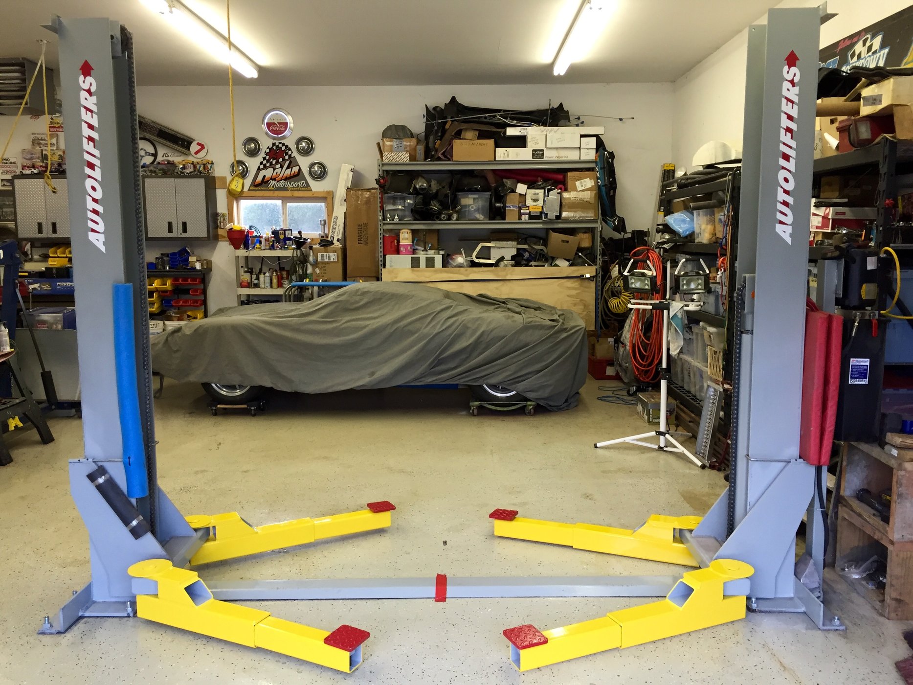

I used EpoxyCoat from EpoxyCoat.com on my shop floor. 100% solids.
My only regret is mixing in the dark colored flakes - although the anti-skid property of them are good...

EpoxyCoat.com does have bags of Silica Grit (fine sand) that can be mixed in or sprinkled immediately after application. It does provide “some” antiskid protection, perhaps not as much as the flakes do though.. I wish I had gone this route.
If you do go with flakes, I believe you can now buy the flakes in the same color as the epoxy..

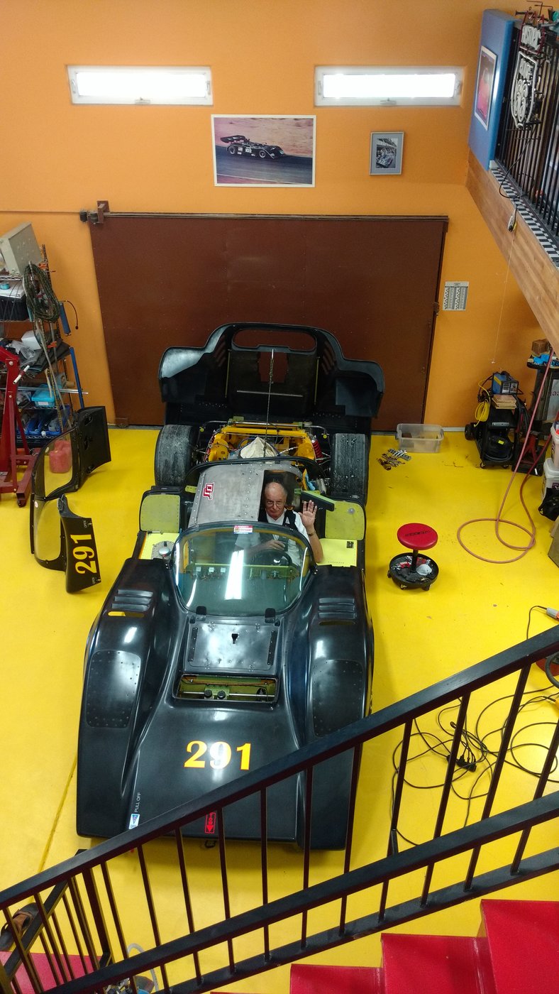

Steve, that is the reason I painted my shop floor bright yellow- I can find small parts that get dropped. A light color also makes the shop brighter since it reflects the light.
