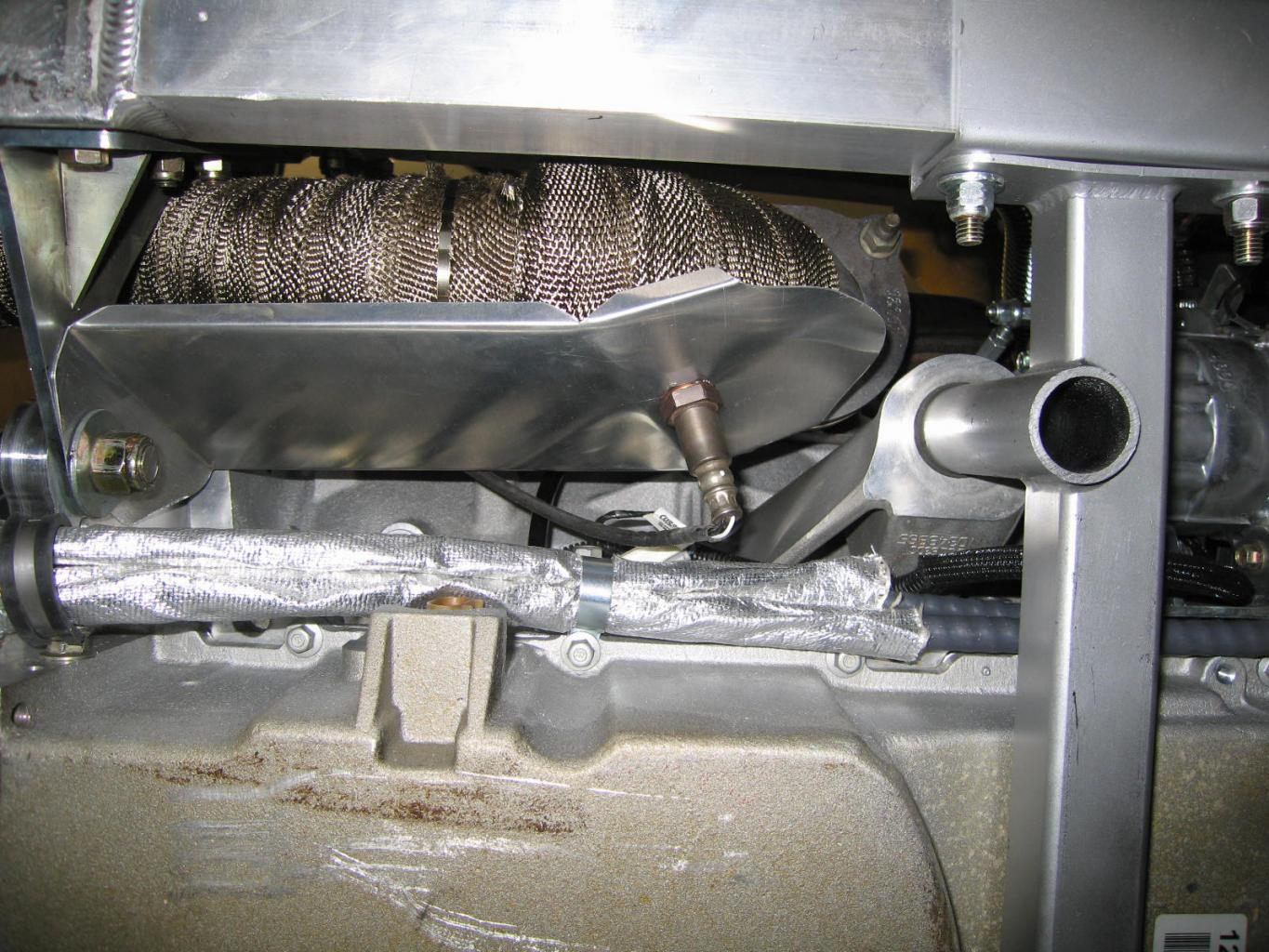

I used heat wrap on my headers and it works really well. To protect my shift cables even more, I put heat tubing around the shift cables, fabricated a heat shield and clamped the cables as close to the block as possible.
As a result, you can grab the shift cables when the engine is at 200+ degrees and they are only lukewarm.

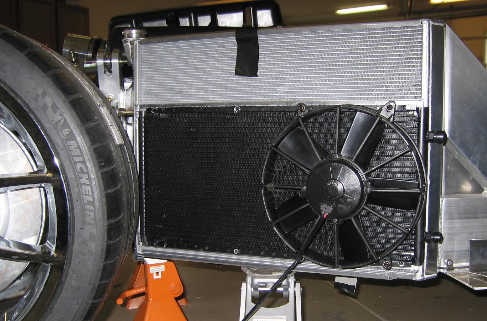

The addition of insulated LS7 headers, insulated HushPower mufflers, and 2 rear mounted radiator fans keep my under hood temperature very comfortable.
I still plan to ceramic coat the headers for corrosion protection.
FYI, the PIC shows only 1 radiator fan, but 2 are installed.
