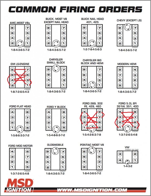

I notice nobody is using a "Bundle of Snakes" exhaust on the SLCs.
Just curious why not?
Not enough room? Not the best choice for the LS series engines I see most of y'all using? LS firing order not right for that design?
I know there has to be a simple reason...just have not seen the issue addressed.

LS motor has same firing order as late small block fords and 351c Doug. In the case of the SLC it would appear space for 180° crossover exhaust options were not high on the priority list!

Someone did. I don't think it was an LS but there are major issues fitting the 180s in the engine bay and the excessive heat they generate causes a bunch of problems. It's possible for 180s if you're willing to sacrifice but most who have seriously considered it have decided not to for the many, many drawbacks associated with it.
