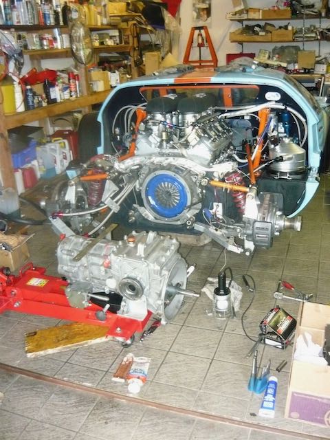

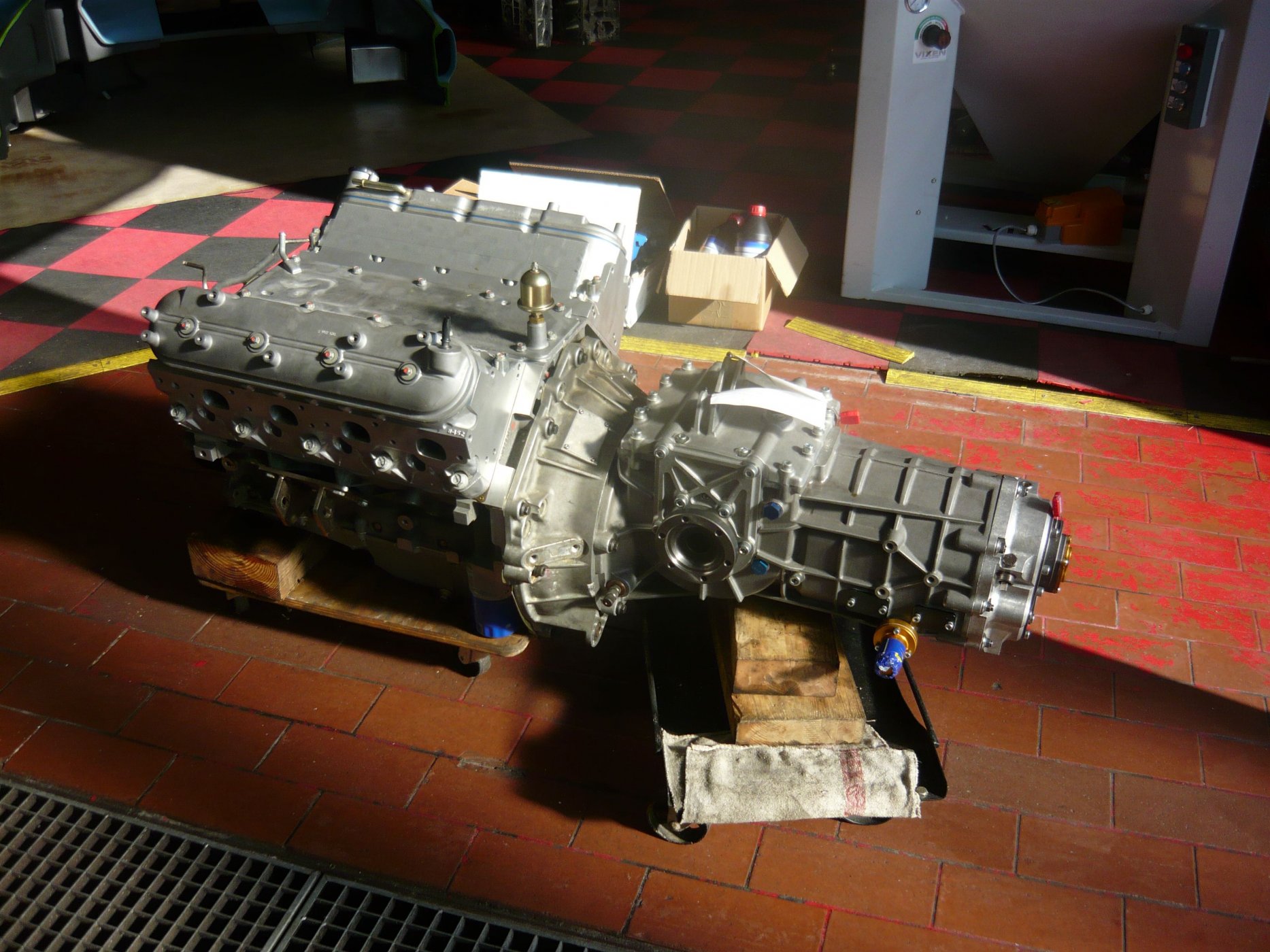

Time for a little update on the state of affairs:
My early ZFQ box was factory refurbished (new synchros, ring and pinion, …) and upgraded (pretty much to current specs I was told) and mated with engine and new clutch (SPEC Stage 2).
This unit was installed back into the chassis. The water pump was modified: outlet to the heater was plugged externally and internally, and the thermostat was removed. As a consequence the radiator circuit is used permanently and there is no more pressure to the header tank which is connected to the water pump via the heater inlet. With the water pump, alternator, AC compressor etc. removed removal and refitting of the engine-gbx unit is fairly simple (no need to remove the rear wheels, rear floor, springs, etc. ).
The exhaust system (now with ceramic coating) was fitted.
Fluids were filled (engine primed with oil, 5W50 was used). Injector seals needed renewal (some leaked fuel). Engine fired right up but zero oil pressure indicated by the gauge). So the oil pressure was measured at the sender location: read fine and also from the gauge thereon. However a first short test drive showed oil pressure problems with symptoms similar to before the rebuild: pressure dropped from reasonable to about 10 psi within about 15 min of driving. After several tests the oil cooler circuit was identified as the culprit. The oil thermostat was eliminated and new oil lines were installed. This fixed the oiling problem entirely (~100psi at idle when cold, about 50psi when hot with the red Katech oil pump).
Two more problems were found: one of the race kats had disintegrated blocking one exhaust pipe. Exhaust was freed and the internals of the other kat were removed to protect the engine for now. Car drove home without problems - had to refrain from speeding though ;-) .
New kats will need to be installed before I take the car to the annual inspection. Finally, the gearbox would not take reverse (and first, as I found out later). A slightly loose bolt at the first joint was identified as the culprit. All well now.
With both seats out I removed the front bracket/cover holding the hand brake lever to learn about the feasibility of hand brake adjustment. Will continue on over the weekend time permitting.

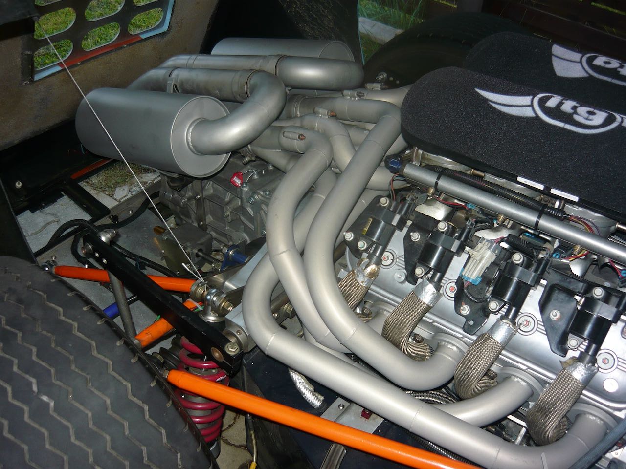

Next up is further improving upon heat management in the engine bay. HJS offers mufflers with integrated CATs. This may let me do away with the exhaust loop from cat to muffler and out to the rear. the long path for the exhaust fumes and the large surface area, combined with the proximity of the mufflers to the clam shell, act like a heater coil. Another thought is to simply add CATS to straight end pipes. May be too loud?

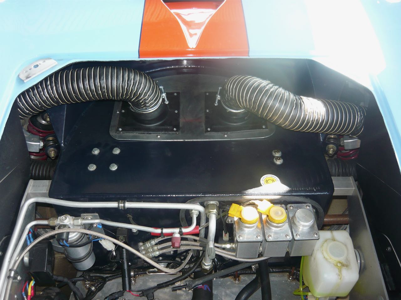

Small but useful progress in developing the car:
I installed 2 air vent hoses into the pedal/foot area of the car to assist cooling the interior. The air is taken from part of the side vents in the nose - the other half being used to cool the brakes. I fitted a sheet of foam above the radiator to force more air into the latter.

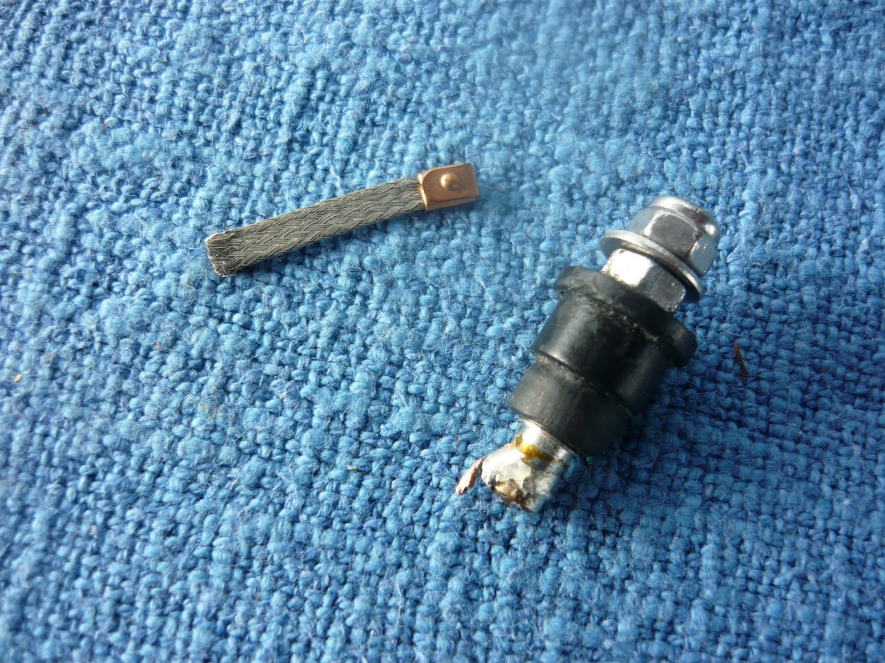

Also I had a problem with an erratic starter. Long story short: the terminal post for the solenoid wire was loose. Indeed, the wire connection to the inside of the starter was torn, most likely by turning the post while tightening or loosening the nut for the outside cable. Unfortunately, this post is simply pressed into an isolated hole in the starter housing. With my Depstech camera I could explore the inside of the solenoid housing near the post hole and saw a wire tab. I then soldered a wire strip (a short piece of copper brush wire from my Scalextrics toolbox) to the inner tip of the post and carefully inserted it in the proper direction and pressed it into position after I had reattached the solenoid wire. Luckily the starter works again.
So the lesson is: with the Powermaster 9503 XS Torque starter always fix the counter nut with a wrench when removing the lock nut for the wires. Not easy due to space restrictions. In any case, I ordered a new starter to hopefully have it sit on the shelf for a very long time. The new starter now has a yellow tag: ``do not over-tighten the lock nuts” or so.

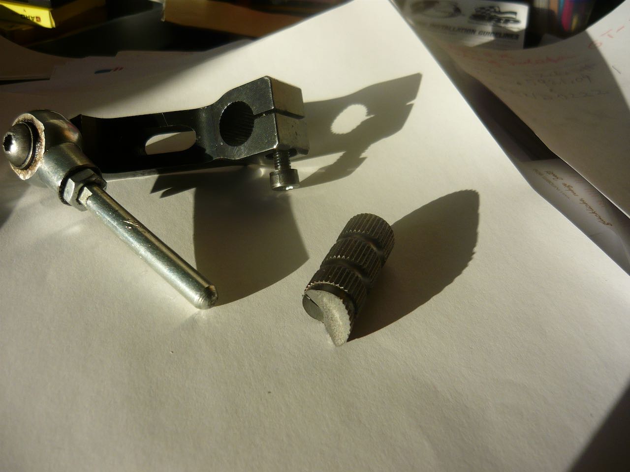

Clutch fork shaft on the ZFQ sheared right off. Fortunately it happened at a parking lot as I wanted to take off to return home - pedal traveled in freely - first I thought I had missed it.... took the train home, taking the opportunity to obtain a senior citizen discount card, and returned with a trailer.P1010609.jpeg
Time to pull the ZFQ once more...
The tow hook definitely was the most useful upgrade I've made on this car!
ZFQ box is out. The new shaft is fitted (was told the shaft which broke is not of Quaife origin). The new one has splines but no grooves for the locating bolt. Which is good because the old rod sheared at the innermost of 3 grooves. I may have to slightly shave the splines to fit the locating bolt. In any case I'll carefully measure clutch lever free play and push rod length. I'll use a modified E-Type adjustable clutch push rod. Finally clutch pedal travel will be set.

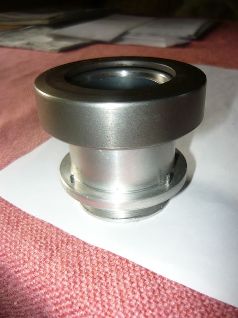

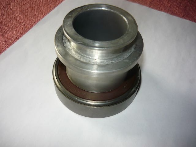

Clutch release bearing:

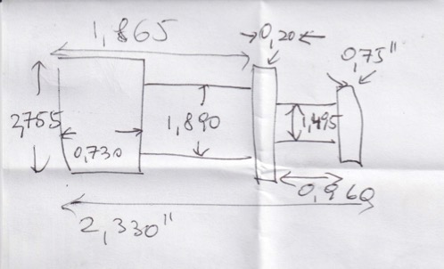

Since I had the opportunity I took a closer look at the clutch release bearing and the hub it's pressed on. The release bearing size is OD=70mm, ID=40mm, H=18.5mm (40x70x18.5) - my measurement converted from inch. Locally, I could only get a sealed regular bearing 40x68x15 (SKF 6008-2RS1). Several hours of searching the net for a suitable release bearing and I found Sachs 1863 600 127 (40x75x18.4) which will fit. (Also close is 40TNK20 40 x 70 x 17,90 mm used in a Mitsubishi GS200 tractor.) I ordered a Sachs to go with my next clutch replacement.
Before mating the ZFQ to the bell housing I measured release-bearing to clutch-finger distance. It came out at a near perfect 0.172" (4.3mm) for a single disk clutch. I verified clutch movement using the service windows on the bell housing and my Depstech "eye".
I attach a few photos of the release bearing unit and a sketch of its dimensions in inch. Maybe helpful for someone who uses an LS7/ZFQ bell housing/ZFQ unit with external slave cylinder. Certainly good for my own records ;-)

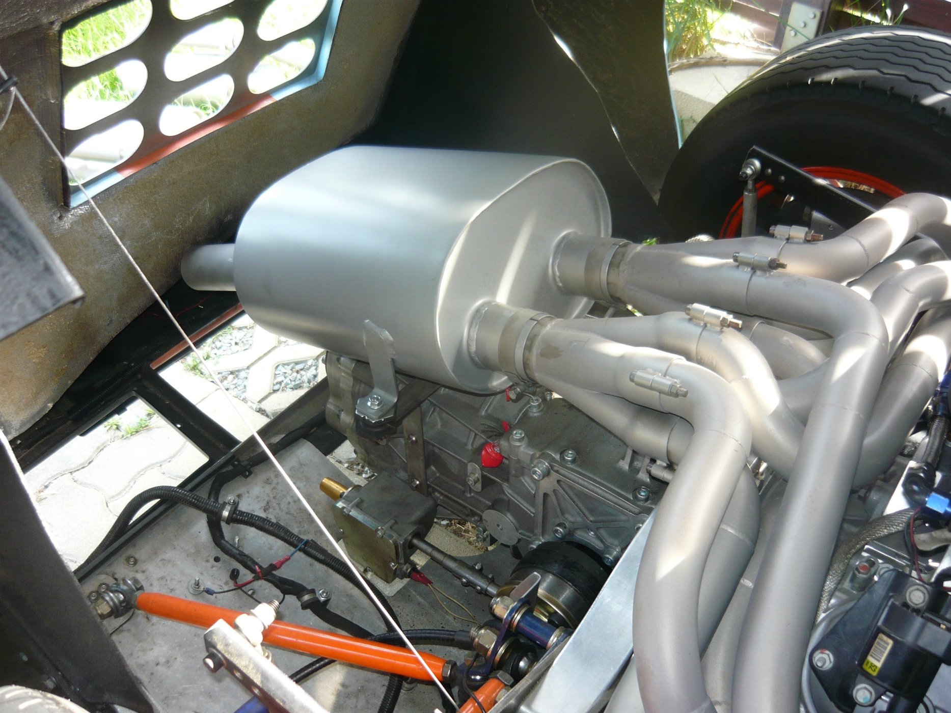

New muffler with integrated HJS CATs installed - not very pretty but I hope it will leave less heat in the engine bay...
Walter, what is the noise level in dB if you know it ?

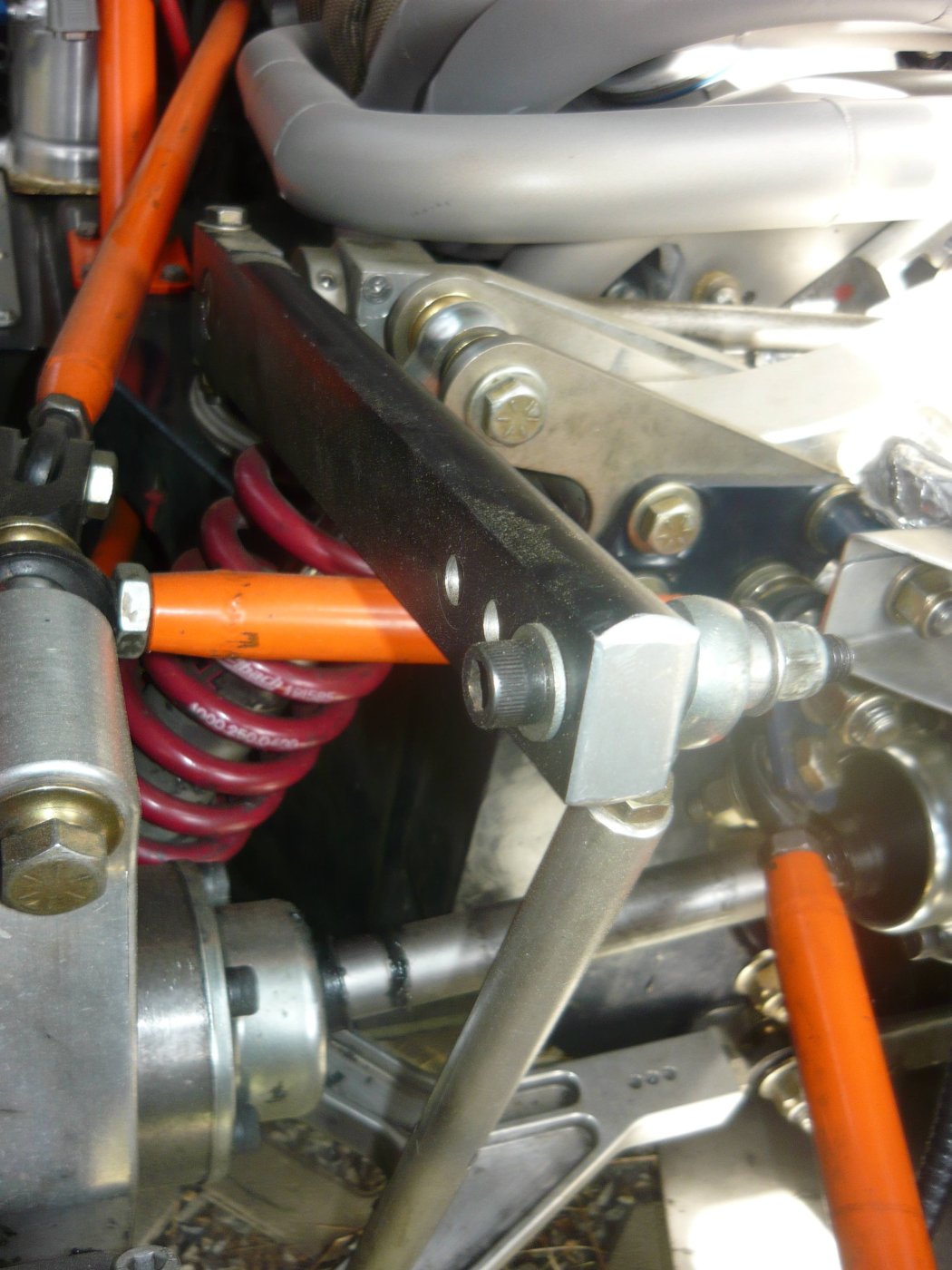

I see that you have a sway bar on the rear, could you make some photos of it ?
dB: not really - but similar to the other system. I may go back to the builder and ask him for measurement, now that everything is in place.
I'm sure the sway bar setup came directly from RCR. I took some pictures but it's difficult to see much with everything else in its place. If you look through my build-log (and that of others) you may get a better view of the overall situation (it is attached in front of the cross member and beneath the exhaust system).
I'd talk to Bill or Fran at RCR what they got, this may save you time (and money?).

Thank you to take time for th photos. I have the same arms in my stock of parts probably coming from RCR, but it was not in place on the car. I was surprised by the weight and the length of those arms and was not shure if the were used on the RCR GT40.
On most of the car, the sway bar has a lower diameter and a complicated shape that goes over the exhaust tubes.
no problem. Yes, as you say, on the original GT40s the sway bar usually ran above the exhaust and thus had a more complicated shape. On most replicas I've seen it's opposite: sway bar underneath. The RCR (rear) sway bar is rather beefy and heavy. Most likely overkill for the street but likely useful for you since you are going for a track car. Surely someone out there could build a custom sway bar for you.
